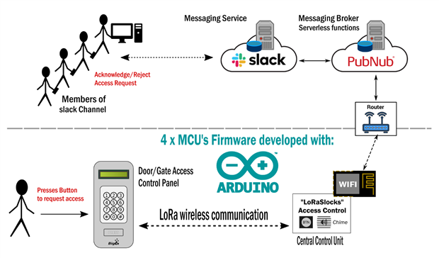

To provide an overview of how it works, here is the top level data/messaging flow for the application:
As highlighted in the diagram, the architecture can be split into two halves.
The device level side was all developed using the Arduino ecosystem. In my case, this involved developing firmware for 4 x micro-controllers with 2 x MKR 1300's forming the important link between the remote Access Control Panel and the Central Control Unit / Gateway. For the WiFi Bridge I used a NodeMCU ESP8266 as this provided the simplest connectivity option and I also just happened to have one on my desk. The NodeMCU could readily be swapped out and an MKR 1000 or MKR 1010 could be used instead with minimal changes to the code. This is the power behind the Arduino IDE and library architecture.
To provide a communal aspect requires a cloud service. For this project, I wanted to use Slack as this web service is ideal for creating groups or channels where you can assign specific members. Slack also has an API allowing you to create your own notification and response applications. I then chose PubNub as my cloud platform as this provided me with the best option going forward for the messaging broker side, and they just happen to have an Arduino library to get you started and they also offer serverless functions, which is the real power behind developing specific business rules the access control application.

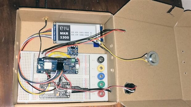

For testing, I decided to attach an ePaper display to my single channel MKR1300 LoRa module + NodeMCU/ESP8266 gateway to capture the LoRa RSSI and SNR values. Here are two results for the 100 to 105 metre range:
{gallery:autoplay=false} My Distance Test Results
There are two values shown. The first data log is when the one MKR 1300 is powered up (designated P). The second is when a open gate request is sent and this message is acknowledged as being received (designated A). The data is timestamped as minutes and seconds from bootup. The first value is RSSI and the second value logged is SNR (which is multiplied by 10 and shown as integer).

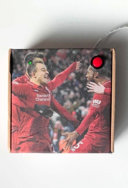

a. Arduino MKR WAN 1300 Board
The purpose of the Arduino MKR WAN 1300 board within the central control unit is to receive and respond to the LoRa wireless communication coming from the access control panel. It is also used to generate a chime using I2S generated tones and handling the pushbutton and wifi module interrupts via GPIO’s. For debugging purposes it communicates with an ePaper display using SPI bus and communicates with the NodeMCU using UART to handle the pub-sub communication protocol with PubNub via Internet. The code developed for this Arduino MKR WAN 1300 Board is provided in the github repository: https://github.com/Gerriko/LoRasLocks-MKR1300

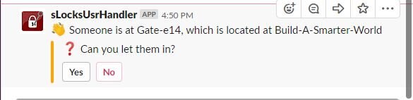

The Slack messaging is basically a notification asking a question:
And when someone responses it changes the messaging context so you know the action taken. Here are the two cases:
And that is it. When someone responds the Slack API responds back to Pubnub which in turn publishes a response which is picked up by the NodeMCU board. What's quite pleasing with this process is the speed of the PubNub serverless pubsub handling. As you may have noticed in the demos it takes about 3-6 secs for the slack channel notification to hit the smartphone or computer but no more than a second for the slack response to arrive back at LoRa gateway and transmitted back to access panel. Note that in the video demos, the smartphone is used for demo purposes only – or it is a way, as a member of the Slack channel community to let yourself through the gate. A smartphone is not required by the general public to gain access. They simply want right of way.
