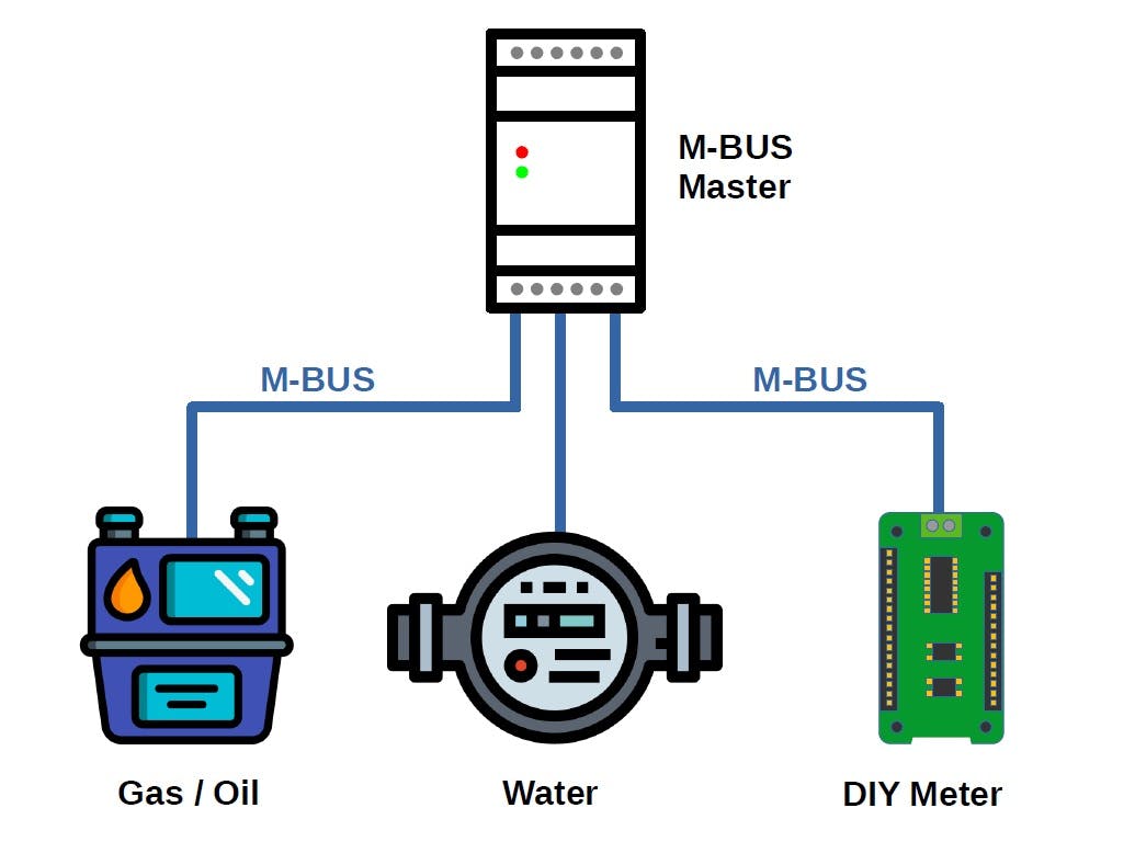

The M-BUS or "meter bus" field bus is the widely used standard for recording consumption values. M-BUS systems always consist of an M-BUS master, which collects the data from the connected consumption meters, which contain a corresponding slave interface.
Since the data transmission works physically different in both directions, different interfaces are needed for the master and the slaves. In this example I want to show how to create a simple M-BUS slave with the help of our M-BUS slave FeatherWings and a Feather microcontroller board. This can be useful if you want to provide your own measured values to an existing M-BUS master.

A typical installation might look like this:

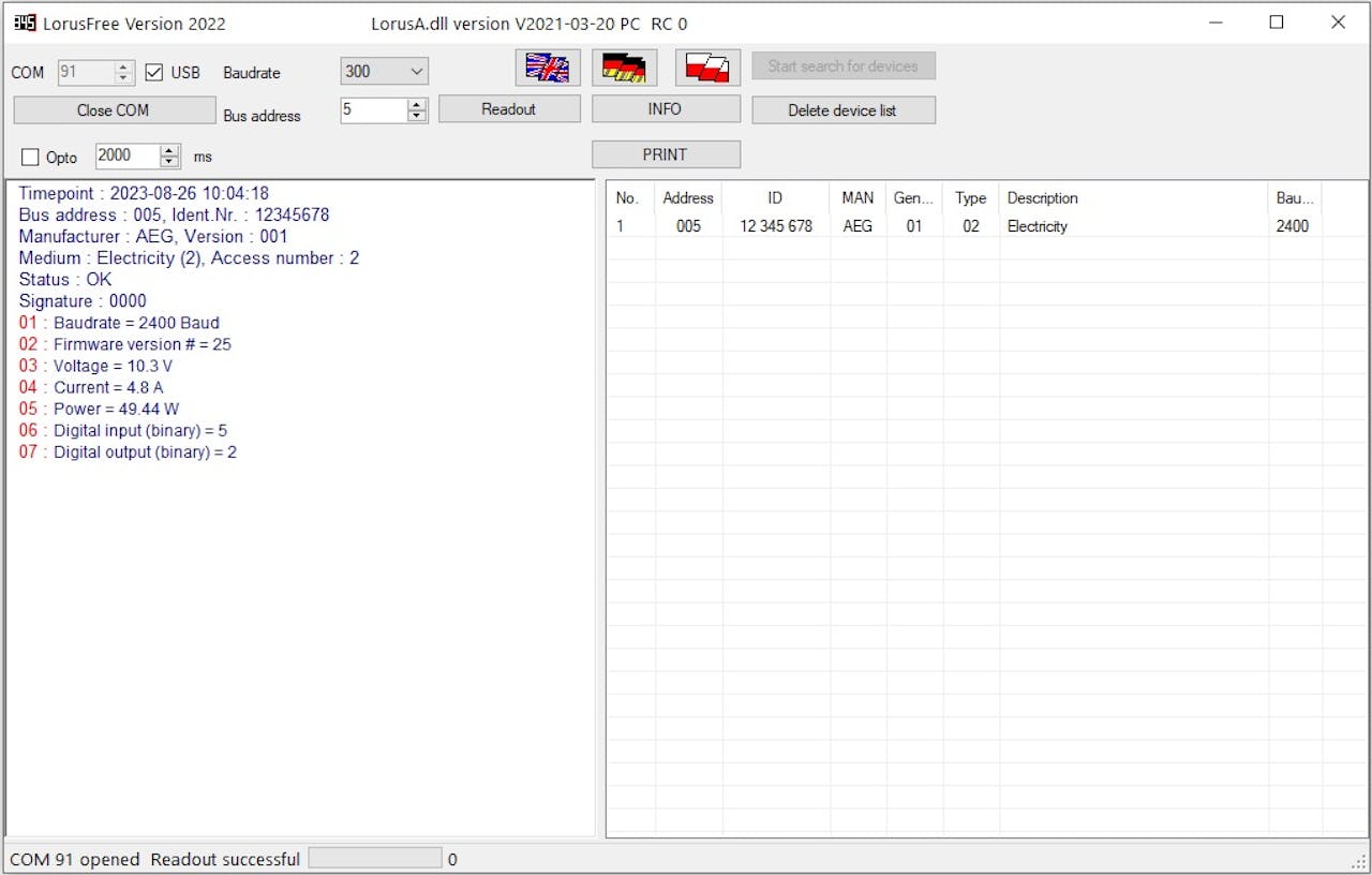

For the test you need a MBUS master, which supplies the MBUS and can exchange data with the slave. For example you can use a Raspberry Pi with libmbus and our MBUS Master HAT.
Another possibility is to use a PC interface and a M-BUS Master simulator e.g. Lorus Free.
