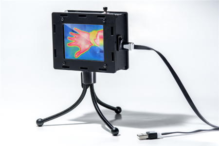

DIY-Thermocam - An open-source, do-it-yourself thermal imager
The DIY-Thermocam is a do-it-yourself, low-cost thermographic camera based upon the famous Teensy 3.2 mikrocontroller. It uses a long-wave infrared sensor from FLIR to provide high quality thermal images.
The aim of this project is to offer a cheap, open-source thermal plattform for private persons, educational institutes or small companies. There are various applications like finding heat leaks in the insulation of buildings including windows,  the analysis of electric components, as well as exploring at night.
The large firmware written in Arduino compatible C++ code can be used as it is or modified / extended to your own needs. That allows the DIY-Thermocam to be used as a versatile basis for various, different thermal applications.

    Thanks for your answer ! I know the price is not comparable to the cheap smartphone addons on the market, but if you compare it to a stand-alone thermal imager even from big companies like Seek or FLIR (and I am just a single student at the age of 23), it's still in the price range.
    The project you mention also looks very interesting image Version 1 - 3 of the predecessor of the DIY-Thermocam, the Cheap-Thermocam, also used a single IR sensor to scan the image. That was cheap of course, but took some time to create an image. The Lepton sensor in the DIY-Thermocam is a real 80 x 60 LWIR sensor, and there will be an upgraded version with 160 x 120 pixels in the near future, that can also be plugged into the device.

    How is that you use a Flir sensor but have better resolution and much better accuracy than Flir can manage ?
    Do you have any test reports that can back up these claims ?

    What specification do you mean exactly ? As I rely on the sensor precision itself, I can of course not claim any better specs than FLIR does image

    From the feature table on your web site:
    Features - DIY-Thermocam
    makes the claims re. precision and accuracy versus Flir E4

    The FLIR E4 does use another thermal sensor, so the specifications are correct. Just have a look at the FLIR Lepton datasheet and the E4 datasheet, you will find it there. The spot sensor I use is a MLX90614 from Melexis, that has a better precision than the sensor used in the FLIR E4, so this is where the difference comes from.

    Thanks for the clarification - it might be a good idea to add a note to that effect on your website - one sees so many unjustified claims on the web that caution is very necessary.

    You are right, I added a small footnote to the table to explain the difference, thanks image
