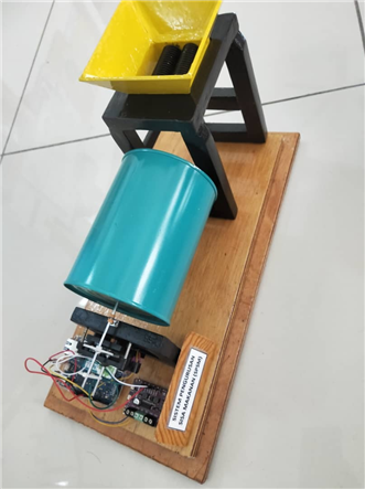

This is my model of a food waste composting machine. In Arduino Day, it is my pleasure to share a possible machine we can build with arduino to help turn food waste
into useful byproducts -> fertilizer. each day, huge quantity of food waste is produced https://www.youtube.com/watch?v=IoCVrkcaH6Q

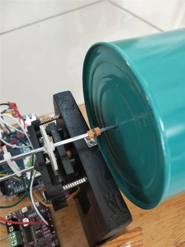

In the actual setup (look at video at appendix below), there is a food shredder that shred food waste into slice. the slice is put into the drum
The drum is controlled to rotate according to schedule, so as to provide sufficient air surface to the micro organism performing aerobic food waste composting
it takes 6 days to reduce the food waste into fertilizer. Temperature sensor is used to measure the operation to make sure food composting is take place.
in normal operation, temperature will gradually rise to 60 degree celcius before tapering off.
It has a motor with gear that i salvage from toy car. the rotating drum is and all the structures are wood.
a motor drive is connected to the arduino yun.

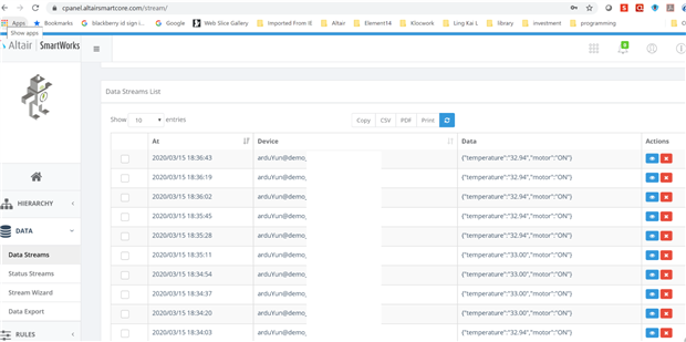

Arduino yun is provided connectivity to a cloud Iot agreegator. it keep track of motor on/off and temperature

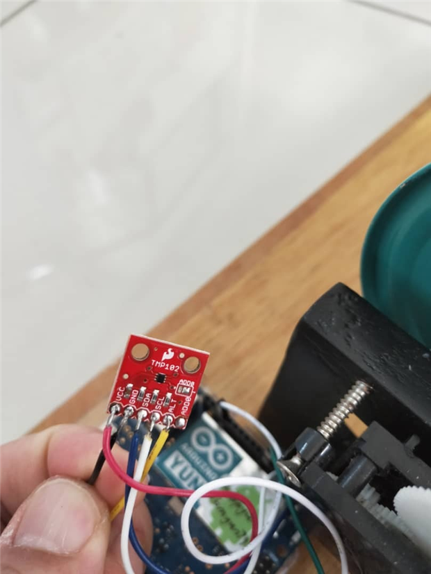

I use TMP102
below is the screenshot of the data uploaded to cloud aggregator
