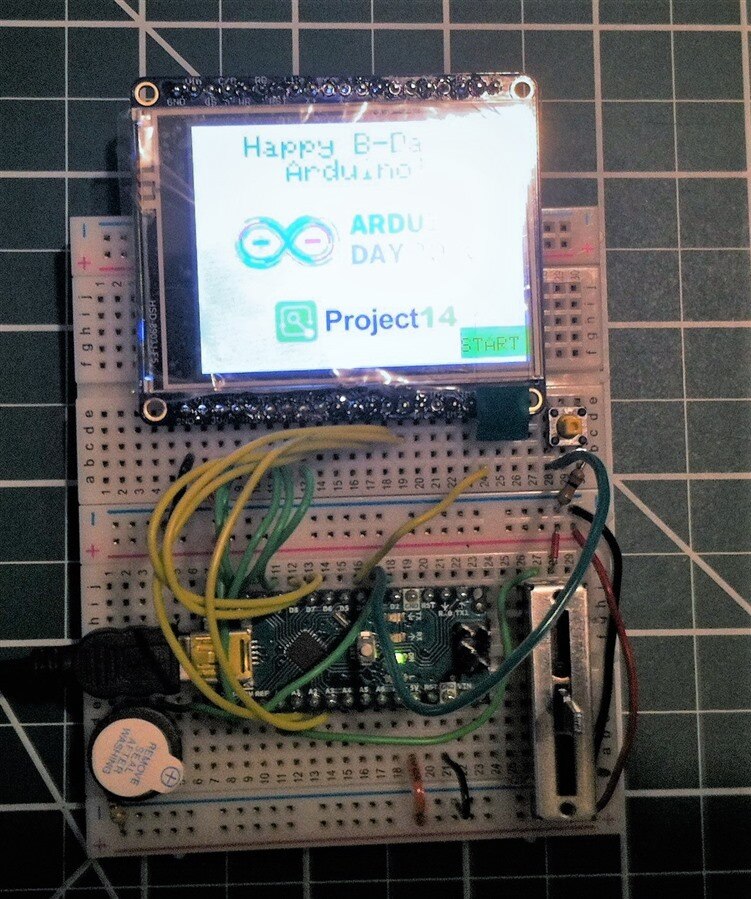

Here is my contribution to wishing Arduino a Happy Birthday on Arduino Day 2020.
This is a basic project using an Arduino Nano Classic, a Slide Potentiometer and a Adafruit ILI9341 TFT screen.
Using the Adafruit TFT and GFX libraries, I have the system start up with some images and text displaying on the screen.
Then using the Touch feature of the TFT screen, I use an on screen button to start the basic Pong-type game.
I included a Pizeo speaker just to have a sound when the ball hits the paddle.
The pic and vid I have are not the best but they at least show something.
Happy B-Day Arduino!

    jomoenginer over 6 years ago in reply to dubbie +2
    Yeah, I was in a bit of a rush to get this posted for Arduino Day so it lacked much detail. I'll see about adding more to it if possible. Much of what I implemented followed the Adafruit ILI9341 TFT examples…

    A good little game. It would be good to see more details as I would be interested in possibly making something similar. I have some small OLED displays which might also work well. How did you get the graphics…
    Much of what I implemented followed the Adafruit ILI9341 TFT examples using the Adafruit_GFX, Adafruit_ILI9341, SdFat. Adafruit_SPIFlash, Adafruit_ImageReader and TouchScreen libraries.  The ILI9341 TFT Breakout Board has an onboard micro SD card that can be used to read in a BMP file and display it on the screen.
    I image you could use a SD card breakout board that uses a SPI interface in place of what is used on the ILI9341.
    This looks like this after initialization:
      ImageReturnCode stat; // Status from image-reading functions
      Serial.begin(9600);
      tft.begin();
      // The Adafruit_ImageReader constructor call (above, before setup())
      // accepts an uninitialized SdFat or FatFileSystem object. This MUST
      // BE INITIALIZED before using any of the image reader functions!
      Serial.print(F("Initializing filesystem..."));
    #if defined(USE_SD_CARD)
      // SD card is pretty straightforward, a single call...
      if(!SD.begin(SD_CS, SD_SCK_MHZ(25))) { // ESP32 requires 25 MHz limit
        Serial.println(F("SD begin() failed"));
        for(;;); // Fatal error, do not continue
    #else
      // SPI or QSPI flash requires two steps, one to access the bare flash
      // memory itself, then the second to access the filesystem within...
      if(!flash.begin()) {
        Serial.println(F("flash begin() failed"));
        for(;;);
      if(!filesys.begin(&flash)) {
        Serial.println(F("filesys begin() failed"));
        for(;;);
    #endif
      Serial.println(F("OK!"));
      // Fill screen blue. Not a required step, this just shows that we're
      // successfully communicating with the screen.
      tft.fillScreen(ILI9341_WHITE);
      tft.setRotation(3);
      Serial.print(F("Loading p14-logo.bmp to screen..."));
      stat = reader.drawBMP("/images/arduino-day-2020.bmp", tft, 30, 80);
      reader.printStatus(stat);   // How'd we do?
      stat = reader.drawBMP("/images/p14-logo-sm.bmp", tft, 60, 165);
      //delay(200);
    The Pong-type game was created using the Adafruit_GFX, Adafruit_ILI9341libs to create a play field and then draw a circle for the ball and a rectangle for the paddle.  I clear the previous spot for the ball or the paddle when they move before drawing them in the new position. The colors are based on the Arduino log colors that I had to translate to RGB565 format for the display.

    A good little game. It would be good to see more details as I would be interested in possibly making something similar. I have some small OLED displays which might also work well. How did you get the graphics into the system?
