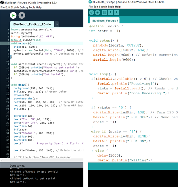

HISTORY OF "Processing IDE"
Processing IDE has its start all the way back to 1975 at MIT.  They desired a quick means of graphical programming in "sketch" fashion.  It changed hands a couple of times over the years until it hit its modern day era around 1999 as Java spread across the globe.
A few years later, the Arduino IDE project grew out of Processing IDE while its MIT founder Casey Reas was teaching at the Interaction Design Institute Ivrea in Italy(1).  In turn, the development environments as well as core libraries, reserved keywords, and base methods are all very familiar.
Here is how they look side by side as of 2021:
Processing IDE (Left) Versus Arduino IDE (Right)
Both environments have the same approach to structure.  They both look like "C" or "Java".  They both have a "setup" method.  They both have a method that continuously loops after the "setup" method is executed.  For Processing IDE, the looping method is "draw" which allows you to handle events and update the GUI (application window) accordingly in a forever loop.  For Arduino, the looping method is named "loop".
If you are already versed with Arduino, you can be coding standalone applications for PC/Linux, Android, and the Raspberry Pi with a "write once/use everywhere" approach using the Processing IDE.

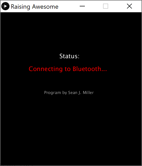

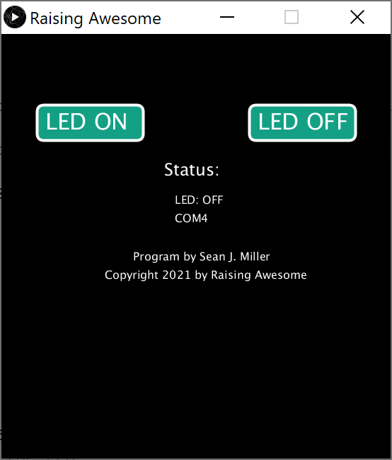

Here is the code I used to get my HC-06 talking to my Arduino Nano 33 IoT.  I followed a tutorial (referenced in the code originally by Dejan Nedelkovski) for the Uno, but ported it for the Nano.
I also made the PC side automatically poll and detect the correct COM port which makes it much simpler for an end user who wants to just turn it on and it start working.
Arduino Side (Arduino IDE):
//Originally from:  https://howtomechatronics.com/tutorials/arduino/arduino-and-hc-05-bluetooth-module-tutorial/
//Updated for the Nano by Sean J. Miller 2021.  MIT License
#define ledPin 7
int state = -1;
void setup() {
  pinMode(ledPin, OUTPUT);
  digitalWrite(ledPin, LOW);
  Serial.begin(9600); // Default communication rate of the Bluetooth module
  Serial1.begin(9600);
void loop() {
 if(Serial1.available() > 0){ // Checks whether data is comming from the serial port
    Serial.println("Receiving!");
    state = Serial1.read(); // Reads the data from the serial port
    Serial.println("Done Receiving!");
 if (state == '0') {
  digitalWrite(ledPin, LOW); // Turn LED OFF
  Serial1.println("LED: OFF"); // Send back, to the phone, the String "LED: ON"
  state = -1;
 else if (state == '1') {
  digitalWrite(ledPin, HIGH);
  Serial1.println("LED: ON");
  state = -1;
 } else {
    delay(1000);
    Serial1.println("Ready");
PC Side (Processing IDE):

void serialEvent (Serial myPort){ // Checks for available data in the Serial Port
  if (DEBUG) println("About to get serial!");
  ledStatus = myPort.readStringUntil('\n'); //Reads the data sent from the Arduino (the String "LED: OFF/ON) and it puts into the "ledStatus" variable
  if (DEBUG) println("Got Serial",ledStatus);
void draw()
  if (!CONNECTED) ConnectToBluetooth();
  background(0, 0, 0);
  fill(20, 160, 133); // Green Color
  stroke(255);
  strokeWeight(4);
  rect(50, 100, 150, 50, 10);  // Turn ON Button
  rect(350, 100, 150, 50, 10); // Turn OFF Button
  fill(255);
  textSize(32);
  text("LED ON",62, 135);
  text("LED OFF", 362, 135);
  textSize(24);
  fill(255);
  text("Status:", 230, 200);
  textSize(30);
  textSize(16);
  text("                     Program by Sean J. Miller\n             Copyright 2021 by Raising Awesome", 80, 320);
  text(ledStatus + the_port, 245, 240); // Prints the string comming from the Arduino
  if(mousePressed && mouseX>50 && mouseX<200 && mouseY>100 && mouseY<150&&CONNECTED){
    myPort.write('1'); // Sends the character '1' and that will turn on the LED
    // Highlighs the buttons in red color when pressed
    stroke(255,0,0);
    strokeWeight(2);
    noFill();
    if (DEBUG) print("clicked on");
    delay(250);
  // If the button "Turn OFF" is pressed
  if(mousePressed && mouseX>250 && mouseX<400 && mouseY>100 && mouseY<150&&CONNECTED){
    myPort.write('0'); // Sends the character '0' and that will turn on the LED
    stroke(255,0,0);
    strokeWeight(2);
    noFill();
    rect(250, 100, 150, 50, 10);
    if (DEBUG) print("clicked off");
    delay(250);
void ConnectToBluetooth() {
  String the_coms[]=Serial.list();
  while (!CONNECTED){
    for (int ii=0;ii<(the_coms.length-1);ii++)
      if (DEBUG) print (the_coms[ii]);
      try {
        myPort = new Serial(this, Serial.list()[ii], 9600);
        myPort.bufferUntil('\n');
        myPort.clear();
        the_port=Serial.list()[ii];
        delay(3000);
        if (ledStatus=="Ready") {
          CONNECTED=true;
          if (DEBUG) println("Connected!");
          break;
      } catch (RuntimeException e){
          if (DEBUG) println("!Error!");
Desktop PC GUI by the Processing IDE
