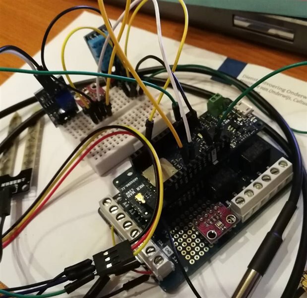

We got a TTGO ESP32 v1, which runs LMIC. We managed to more or less make it do what we wanted and were hoping to compare it with the MKR. Perhaps if people are interested and I am not chased out of the community with tar and pitch forks after the epic fail this blog post is going to be, I can also add a comparison with the RAK811. It is another LoRa node we have, which is either based on the LoRa or LMIC stack, thus should be interesting to have a third option. This however will be on a later stage as I haven't really played with the RAK module beyond connecting it to the TTN gateway (it comes with AT command support and a manual so this required no work on my part). I can only say that at this point the MKR has the best build quality and form factor, at least in my opinion. The TTGO is poorly made, the RAK is good, however the dev board is as big as an Arduino Uno, which in my opinion puts the sleek looking MKR ahead. One advantage of the RAK811 is out of the box AT command support, however the soft is not open source. So the MKR is not perfect, as expected you got to pick your poison as it is often in life.
Right so the idea is rather simple. Use the shield that also came with the boards and attach a bunch of sensors to the MRK. Connect it to a gateway, which we now have two of. They are both based on the RAK831 kit, one works with TTN, the other with LoRaServer.

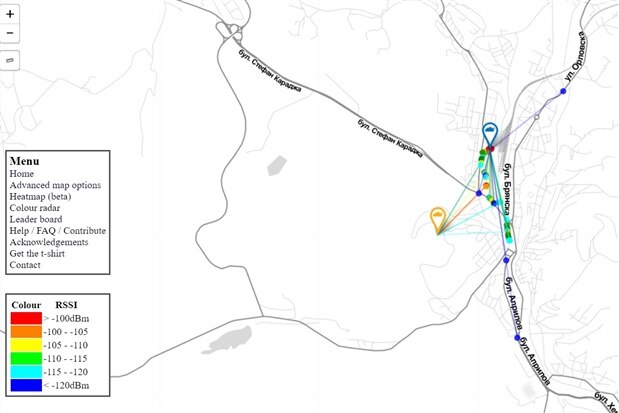

Additionally as we are in a small town, which has a bunch of small villages around it we thought it would be nice to make a coverage map (TTN mapper for the win). It is a mountain setting with lots of vegetation, so it would be interesting at least to us what the coverage is. We already have some idea about LoRa range from the TTGO node testing we did, it is impressive, naturally not what is advertised at all. With the MKR we were hoping to go a step further and make something resembling a drive test around the town, going on the main roads. As the town is in a valley we hope we can go around the surrounding peaks and see what range we get. We are of course not ignorant of the fact that a lot of people have done range testing, however we were hoping to get some more detailed insight into potential dark spots in the particular settings of our town. This would be valuable information. Additionally the following is a thing that probably everyone knows, still I am mentioning it as it is relevant to node positioning in a crop field. We did testing on a small Walnut tree farm, which is on a hillside (a curved one), thus if you position the node at the upper side of the field there is no line of sight beyond a certain point if you walk downwards. Normally LoRa works in a NLOS environment, however in this case even though the gateway was about 500 meters away there was complete loss of signal. I might be wrong, however this should be no surprise as the soil is full of water and is basically impenetrable, also considering how thick the layer is if you think about it. Feel free to correct me if I am wrong. This should be noted in possible deployment scenarios, as even though the field might be small and range should not be an issue, the topology plays an important role and LoRa is not immortal in some settings.

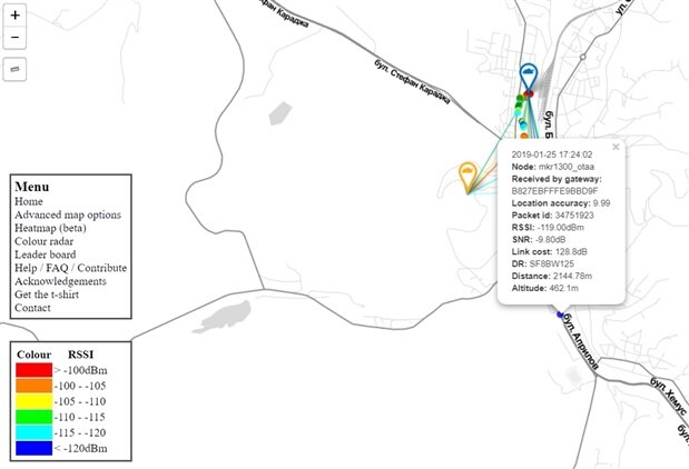

Right hopefully I will have a nice map to show of what kind of coverage measurements we have below:
The pictures above are done with the node, running on two AA batteries. Dumping static data every 10 seconds. I basically walked away from the Gateway carrying the node in my hand. As you can see this is quite good considering this is in a small town, however there are mainly blocks of flats, so plenty of concrete and metal rods in it (good old crappy Soviet construction). On top of that the Gateway was in a flat on the 5th floor overlooking the other side of town not the one I was walking towards. As you can see there are no black spots basically for about a kilometer. The last sample point is about 2 kilometers away as you can see from the second picture. This being said it is after a ling gap with no coverage so I would not say it is a reliable sample. Thus with this node and this setting 1 kilometer is very stable, beyond that no dice. A thing to mention, gateway is RAK831, with SX1301 (yes the more powerful brother with the 2.5dB greater sensitivity compared to the SX1308), antenna is again RAK 6dBi Ceramic Monopole, so as far as range you can do a lot better if you get is raised higher up, but hardware wise DIY level this is about optimum. But that is precisely the point I think, to prove that we can run noncommercial grade hardware with open source software and have 1 km NLOS coverage in town (whooping the ass of any WiFi based IoT system).

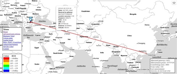

A thing I promised was a car drive test. We did it, unfortunately the map is nowhere to be found, as TTNmapper is not displaying it even though the CSV log files are there. We shall repeat the test and add it post contest.
The following is unfortunately proof that our mapping data is totally unreliable. I came upon it about 5 min after exporting the first two picture, so I would advise to take the measurement results with about a tanker full of salt (yes we are sending data to Hong Kong apparently, take that Andreas Spiess and your world record L)
We intend to do battery power for the mapping test, either 2x AA or 2x AAA. As we got no way to measure the current draw in a reliable way it being too small for our crappy 5$ multimeter (yes some people have a Current ranger we do not), we thought of simply looking of how much the battery voltage has dropped and perhaps drawing conclusions on what the longevity would be like. I had the hope that Santa clause will bring me e Current Range, but alas I must have been a bad boy, because I got nothing. This is one of the things we initially thought we will be able to do, but completely failed at.
The battery voltage as a measure of power consumption idea is mainly the result of me barely passing the power systems exam in my Uni years, thus it is simply ludicrous.
Sorry for having no findings there, still there was one interesting thing perhaps. We tried to do a second drive test, this time with the car, over a larger are. We intended to have two nodes running at the same time (MKR and TTGO), alas the second power bank we used was a rather large one and went into standby mode when powering the node, thus it must not have been drawing a lot of current J Joking aside we are still working on power consumption and sleep cycling and will post any relevant data (we hope we will have some in February).

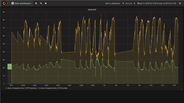

So next thing is connecting the node to the gateway and actually measuring the weather parameters. This has more or less been a straightforward process. I used the MKRWAN libraries, which can be found on the Arduino website. To no surprise they worked just fine, I was easily able to connect to the gateways via OTAA. This was the case for both TTN and LoRaServer, however it should be noted that TTN responded faster and was more stable. The connection to the LoRaServer sometimes dropped packets and there was a significant delay. The TTN data was a bit more stable and the response time was faster. This could be due to the platforms themselves and has nothing to do with the MKR itself, however it is worth noting, as with the TTGO and the LMIC the case was exactly the opposite.
Naturally as every self-respecting man pretending to know what he is doing I started to root around Google, looking for projects to steal from, hell perhaps there was even a whole project I could plagiarize. I mean if I was lucky enough some noble soul would have done exactly what I promised in the time I was pretending to work on my "innovative project". Well seeing how my project is not innovative at all, but more of a way to learn stuff myself there was plenty of things to steal. And yes someone had done exactly what I planned to. So I stole some code from a guy, copied a script from another, naturally I managed to screw them up and the node worked sometimes, however sometimes it didn't.

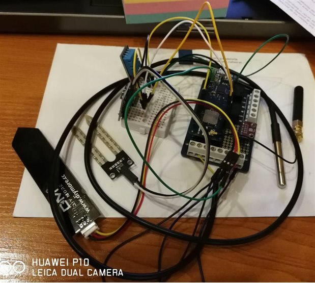

The main thing I was trying to do was to make it go to sleep practically all the time with the exception of waking up once per hour or perhaps 20 min in order to dump the measurements and go to sleep again, if there was no RX message, or a threshold has not been crossed, otherwise open the valve and wait for the timer to elapse in order to close. Yes it is a dumb way to do it as it needs to stay awake for quite a lot of time I suppose, which defeats the whole purpose of the sleep cycling. Naturally I want to make it open the coil, adjust its timers, go to sleep and wake up in order to take a measurement to ascertain that water is indeed flowing and close the valve. I am a crappy coder so this will take me some time, but it should not be too hard to do.
You can take a look of the setup, there is no casing and the measurements are done in a bucket of soil (scratch that open air as soil measurements require calibration, which you need a farmer for), which is less than optimal. Yes I know this makes me look lazy, that is because I am, however it is winter here, and everything is frozen. I think not much else can be done, as far as real life measurements go. Come spring we are going to the Walnut orchard, sticking the node in the field and then we will be posting a proud parents picture of our baby. Plus to be honest it is not easy to make a case for this thing. The BMP280 is skinny, however the soil moisture sensors and the temperature probe have long cables, and need to be outside. This makes is hard to find a case that has a water seal. I think I found a suitable one, I just need to find a way to stick the cabling in a cable sheath with the proper size. Please feel free to give me advice. I know everyone is printing a 3D case, which I also thought of doing (got a Chinese 3D printer), however for testing it is not better as there is no insulation of any kind and I need it to be at least IP58. That is one of the potential issues I have faced, however it should be noted that it is not due to the design of the board, actually I believe having the small form factor that is has is very nice. I prefer a longer narrower board, it fits my setup better, and also mounting it in a small tube on a branch or a tree trunk would I believe be easier.
So this is the mess we used to measure and below it is some data. Data is just for the DHT11, as Grafana (being a woman’s name) is hard to figure out and would not display any meaningful data for the other sensors even though not the TTN console and the LoRaServer applications window displayed the proper values. Yet another bungled thing we will be fixing later on (God we suck so badly).
Props to the Arduino engineers for the expansion board. IT is like they looked in my dreams and made it to my specifications. I need 2x Analog, I2C and a relay to control. It is so perfect, when I initially applied for the project I did not realize that there is an expansion shield and what it was. When I saw the thing I thought, damn those guys get me. Seriously I cannot stress enough how useful this thing is. This being said you can look at the pictures below and listen to my suggestions for improving it.

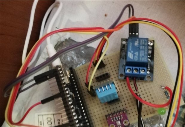

The first one is the board I made for the TTGO. I am posting this for comparison, and because it is ugly and you will appreciate what comes next even more.
Next is the contender the MKR with the shield (another zoomed shot after just to make my article look bigger). Looks a lot better right, even though I have used a breadboard to hook the sensor. Except for the temperature sensor and the power for the humidity which are screwed in the terminals. Initially I thought that having the terminals will be very useful, which it is, however my particular sensors do not come with cables, but with pin headers. So that’s why the setup. I was too lazy to unsolder them and make a nice wired bundle, which would have been better as this is how I am going to do it in the end. I want the sensors to be away from the RF board so they can reach places, and also I can make it modular this way (RF radio board and sensor node board, which work in tandem but are separate entities). This however led to an idea. Perhaps this is why the soldering area was included and if I had used it would have been a much more compact setup, I could have easily soldered some wiring on the bottom part and rooted it to the screw terminals. However, why not include a female header area where the soldering pad area is now. One could simply insert the male header sensors (or make it 50/50 male and female headers 4 pins minimum per sensor). This way they fit nicely and you could have jumpers for example to short which pin is for which (VCC, GND, SCL, SDA, Analog, Digital in my case so 6 options). Just an idea, might not be a good one).
Bear in mind people I got a ton of sensors. For most people there will be like 2 tops and the shield will be perfect, I am just a very confused not so young man, that’s why the mess (no fault to the design).
