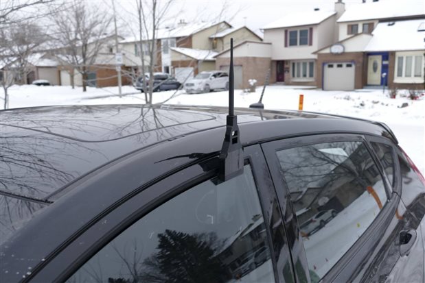

Update 5 - LoRa Range Test
I took the LoRa GPS system out for a spin in my car today. Here are a few pictures:
This picture shows the LoRa GPS module mounted on the driver's side window.
Getting the design angles right was a bit tricky, partly because taking measurements at cold temperatures with bare hands is problematic.

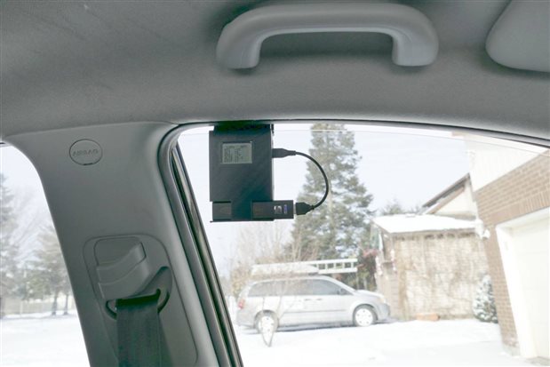

This is what the unit looks like from inside the car.

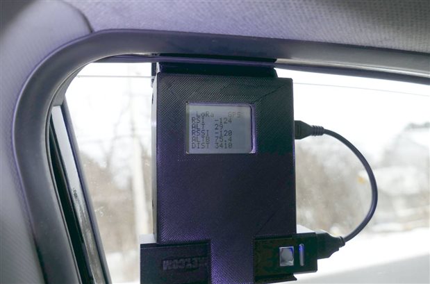

Here is a picture at 3.4 km from my house. The signal was pretty good out to 1 km even though there was lots of houses preventing direct line-of-sight. The signal dropped out a couple of times between 1 km and 3.4 km. There is never a clear line-of-sight to my house on this route . The spot where this image was taken is slightly elevated, but also does not have a clear line-of-sight to my house. There are a bunch of trees and buildings between this location and my house.
Clearly this LoRa radio has much longer range than WiFi, but it still benefits from a direct line-of-sight transmission if one can be arranged.
I plan to try some longer range connections, but they may have to wait for spring as the local mountain lookout is closed during winter.

    itoa(rssi,rsi,10);
    LcdWrite(LCD_C, 0x80 );  // set X Command
    LcdWrite(LCD_C, 0x41 );  // set Y Command
    LcdString("RSI  ");
    LcdString(rsi);
    LcdString("   ");
    LcdWrite(LCD_C, 0x42 );  // set Y Command
    LcdString("ALT  ");
    LcdString(gpsalts);
    LcdString("   ");
    LcdWrite(LCD_C, 0x44 );  // set Y Command
    LcdString("ALTB 75.4");
    LcdWrite(LCD_C, 0x45 );  // set Y Command
    LcdString("DIST ");
    LcdString(distl);
    LcdString("     ");
    LcdWrite(LCD_C, 0x40 );  // set Y Command
    LcdString(" LoRa   GPS ");
    LcdWrite(LCD_C, 0x43 );  // set Y Command
    LcdString("RSSI ");

    dougw over 7 years ago in reply to 14rhb +6
    No, the antennas didn't come with the kit. I purchased them separately. They were on order before the kit winners were announced. I figured I would use them sooner or later even if I didn't win the kit…

    dougw over 7 years ago in reply to fmilburn +5
    fmilburn The housing is designed to mount the antenna as high as the cable will allow - to get it as high as possible above the car roof. The antennas seem to work well, although I have nothing to compare…
