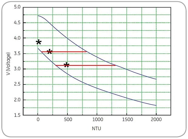

The turbidity, or cloudiness of a fluid, is caused by small suspended solids.  In this project the TSW-10 sensor from Amphenol will be used to get a rough indication of turbidity.  The sensor works by emitting light from an IR LED which travels through the water sample being tested to a phototransistor.  Increased levels of solids in the water reduce the light received by the phototransistor and are thus indicative of the turbidity.  The sensor is designed for  washing machines and dishwashers to sense when rinse water is clean.  There are standards for water bodies in some cases as well as drinking water.  However, the measurements here will be rough and serve only as a non-calibrated indication of turbidity.
The sensor was connected and tested as described in the datasheet.  Output voltage was measured with a Extech EX330 digital multimeter.  Supply from a bench power supply was set at 5V.  Three uncalibrated samples were tested.  The first was Seattle drinking water.  The second was made by adding a pinch of fine soil from my garden and mixing it till to my eye it looked like dirty pond water.  The third was made by diluting the second by about 5:1.
In the photo below the sensor is in open air and the sensor output reading is 2.98 V before being inserted into the samples.
To my surprise, the sensor output voltage increased to 3.66 V when inserted into the clean water sample.  I also noticed that voltage was somewhat influenced by ambient light and whether I was shading it with my hand.
Sensor output voltage dropped to 3.58 V in the intermediate sample.
The dirty sample had a sensor output voltage of 3.21 V.
The datasheet provides a graph with sensor output voltage as a function of turbidity in NTU.  There are two lines shown without an explanation.  The data from this experiment is plotted using 3 asterisks on the same graph below.
I am not sure how to interpret the graph but the experimental data is between the two lines - whatever they are - and the sensor is sensitive to turbidity.  It is possible to buy a powder for mixing standards for testing but at this point I don't intend to do so and will use the meter as indicative only.

    Frank, Interesting thoughts on water sensing. I have developed image processing software for a microscope with CCD optics for counting mammalian cells. The processing was all about statistic and object…

    True, but I think much of it may be inherent to the sensor itself. The phototransistor is bound to have variation in sensitivity and gain, plus there is the issue of alignment with the LED. This isn't…
  • fmilburn
    fmilburn over 7 years ago +3
    On reviewing this, I thought the points I plotted on the NTU graph should be clarified. As noted in the discussion, my samples are not calibrated so only the NTU value of the tap water, which should be…

    fmilburn over 7 years ago in reply to genebren
    True, but I think much of it may be inherent to the sensor itself.  The phototransistor is bound to have variation in sensitivity and gain, plus there is the issue of alignment with the LED.  This isn't a great photo but notice what appears to be a small trim pot with the label VR.
    Maybe they use it to adjust and get within the band at the factory.  Also note the black foam around the sensor slot.  I think that serves to hold things in place as well as possibly block some ambient light.  As noted in the write-up above, I did notice some variation when I moved my hand to block light but it was second order.  I have also noticed it isn't entirely consistent from day to day with no real discernable environmental change.  They may take a reading in the dishwasher of clean water when they start, kind of like I did above, and then use slope similar to how I plotted my asterisks for practical calibration and use.
    Like you, I searched the internet without finding much.  You can buy the standard but there are also some photos of how "cloudy" various degrees of turbidity look.  From these I deduce that my plot above may not be too bad and turbidity is maybe close to the asterisks as shown.  Interesting stuff...  In the old days they would lower a disk into the water until they couldn't see it any more and the distance underwater was how turbidity was quantified.  Maybe I could automate this by moving a disk up and down with a motor and use a camera with AI to detect when it was no longer visible ;-)  Or I could make a disk and try using it to calibrate my sensor above.

    I was interested in trying to find an explanation for the two extreme lines in the above graph.  I found the manufacturers specification to be little help.  I searched for other references to turbidity and/or water quality sensors to see if there might be any clues as to what factors might influence these sensor, still no luck.  I did find an interesting article on water quality measurement sensors (https://ijret.org/volumes/2016v05/i06/IJRET20160506031.pdf ), but it was a little thin on explanations.
    My guesses for what might influence theses sensors are most likely temperature and ambient lighting.  You could easily test for these variables by tests, similar to those you have done, with the added points for temperature changes (hotter and colder than room temperature) and light changes (darkened room and bright light on the sample).  If you can better understand the origin of the two lines, and how environmental changes may effect your readings, you might be able to compensate by factoring other variables (temp and lighting) into the readings.

    On reviewing this, I thought the points I plotted on the NTU graph should be clarified.  As noted in the discussion, my samples are not calibrated so only the NTU value of the tap water, which should be very low, is known.  Assuming the graph in the datasheet gives the limits for sensor output, there is a range of NTU that the output voltage might represent.  The plot as presented above assumes the data follows the slope of the limits on the plot but I don't know this to be true.  A better representation might be this:
    But in truth, I don't know how to interpret the output at this point and will treat it as directionally representative only.
