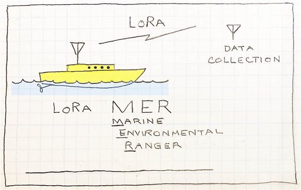

I am building a prototype for a remote controlled vessel, the LoRa Marine Environmental Ranger (LoRa MER) that gathers environmental data and relays it to a shore based station using Arduino MKR WAN 1300 LoRa boards.  This post is the fifth in a series, and describes the turbidity sensor and how the shore based station will store and display data on the internet using a Raspberry Pi and adafruit.io.
Yes, there has been another name change :-)

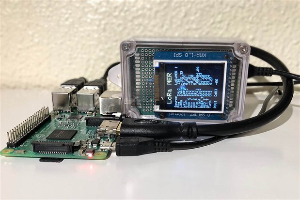

Shore base:
  • Enclosure completed
  • TFT screen fitted
  • Firmware has LoRa reception (polls) and responds with RSSI
  • MKR WAN 1300 connected to Raspberry Pi by USB serial
  • Python script sends data over internet to adafruit.io

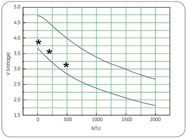

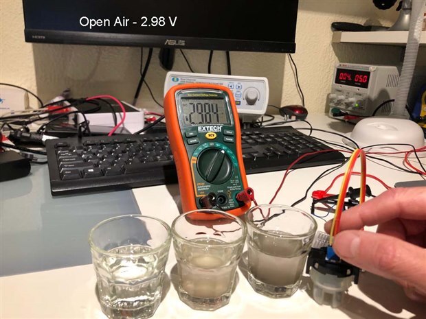

The turbidity, or cloudiness of a fluid, is caused by small suspended solids.  In this project the TSW-10 sensor from Amphenol will be used to get a rough indication of turbidity.  The sensor works by emitting light from an IR LED which travels through the water sample being tested to a phototransistor.  Increased levels of solids in the water reduce the light received by the phototransistor and are thus indicative of the turbidity.  The sensor is designed for  washing machines and dishwashers to sense when rinse water is clean.  There are standards for water bodies in some cases as well as drinking water.  However, the measurements here will be rough and serve only as a non-calibrated indication of turbidity.

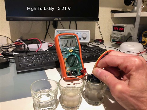

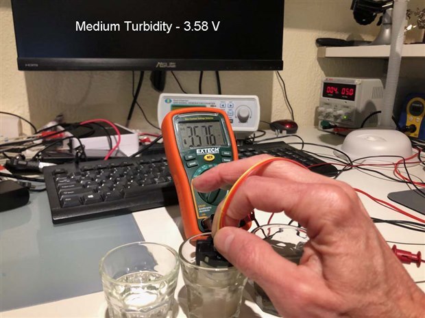

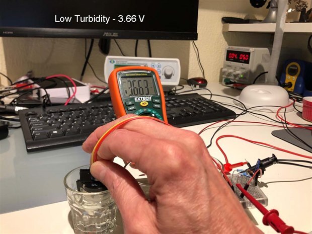

The sensor was connected and tested as described in the datasheet.  Output voltage was measured with a Extech EX330 digital multimeter.  Supply from a bench power supply was set at 5V.  Three uncalibrated samples were tested.  The first was Seattle drinking water.  The second was made by adding a pinch of fine soil from my garden and mixing it till to my eye it looked like dirty pond water.  The third was made by diluting the second by about 5:1.
In the photo below the sensor is in open air and the sensor output reading is 2.98 V before being inserted into the samples.
To my surprise, the sensor output voltage increased to 3.66 V when inserted into the clean water sample.  I also noticed that voltage was somewhat influenced by ambient light and whether I was shading it with my hand.
Sensor output voltage dropped to 3.58 V in the intermediate sample.
The dirty sample had a sensor output voltage of 3.21 V.
The datasheet provides a graph with sensor output voltage as a function of turbidity in NTU.  There are two lines shown without an explanation.  The data from this experiment is plotted using 3 asterisks on the same graph below.
I am not sure how to interpret the graph but the experimental data is between the two lines - whatever they are - and the sensor is sensitive to turbidity.  It is possible to buy a powder for mixing standards for testing but at this point I don't intend to do so and will use the meter as indicative only.

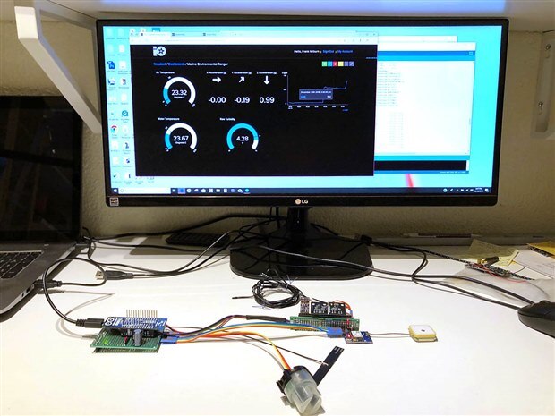

As previously noted, LoRaWAN is not implemented in my area and for the prototype a second MKR WAN 1300 has been connected to a Raspberry Pi via USB

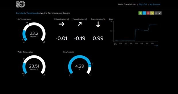

A python script running on the Raspberry Pi parses the data and sends it to the free version of Adafruits Internet of Things service, adafruit.io.  For testing, the base station was placed on the other side of my small lab while the MKR WAN 1300 with the sensors was placed in front of my main computer and monitor as shown below.
A trial dashboard to show what is possible was developed.  In the screenshot below the air and water temperature are on dials along with the turbidity.  Acceleration is shown underneath the arrow icons representing x, y, and z directions while light intensity is graphed on the far right.

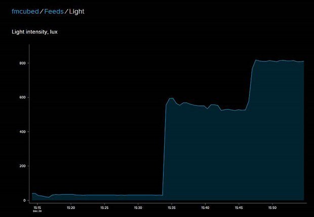

Different dashboards can be constructed and individual feeds can also be examined in detail.  The light intensity data is shown below where after being out for a while I came back to the lab and turned on the lights.  A while later I turned a light to be more directly on the sensor.
Adafruit has a free plan with restrictions as well as a premium plan with more access that costs $99 per year.  My own experience with these services is limited to a few experiments with adafruit.io.
The code is in an unrefined state for the boat and shore station but acceptable for testing the prototype.  I will post it on github after a bit more testing.

    genebren over 7 years ago in reply to fmilburn +4
    Frank, Interesting thoughts on water sensing. I have developed image processing software for a microscope with CCD optics for counting mammalian cells. The processing was all about statistic and object…
  • fmilburn
    fmilburn over 7 years ago in reply to genebren +4
    True, but I think much of it may be inherent to the sensor itself. The phototransistor is bound to have variation in sensitivity and gain, plus there is the issue of alignment with the LED. This isn't…
  • fmilburn
    fmilburn over 7 years ago +3
    On reviewing this, I thought the points I plotted on the NTU graph should be clarified. As noted in the discussion, my samples are not calibrated so only the NTU value of the tap water, which should be…
    mcb1 over 7 years ago in reply to fmilburn
    You might also want to enclose it inside a dark container to ensure the ambient aspect is removed.
    Looks like a very good project and is progressing well.
  • fmilburn
    That would seem a good solution - a solid resin shaped to fit would be easier to use as a calibration standard tha a liquid.
    shabaz over 7 years ago in reply to genebren
    That's very interesting!
    I find optical sensing stuff fascinating. Very cool that home-made calibration standards can be made in this way.
    genebren over 7 years ago in reply to shabaz
    Another approach is to use optically clear resin and cast cubes.  The cubes are clouded in varying amounts (5%, 10%, etc.).  These can be ice cube sized, or sized appropriately for your sensors.  We used to use an approach similar to this to create calibration standards for an optical density sensor and it worked out very well.
    Gene
  • Problemchild
    Problemchild over 7 years ago in reply to fmilburn
    You'll need to calibrate  your own sensor I'm afraid. Pre done sensors are available but far too expensive as he market for them is so small and obviously comercial.
