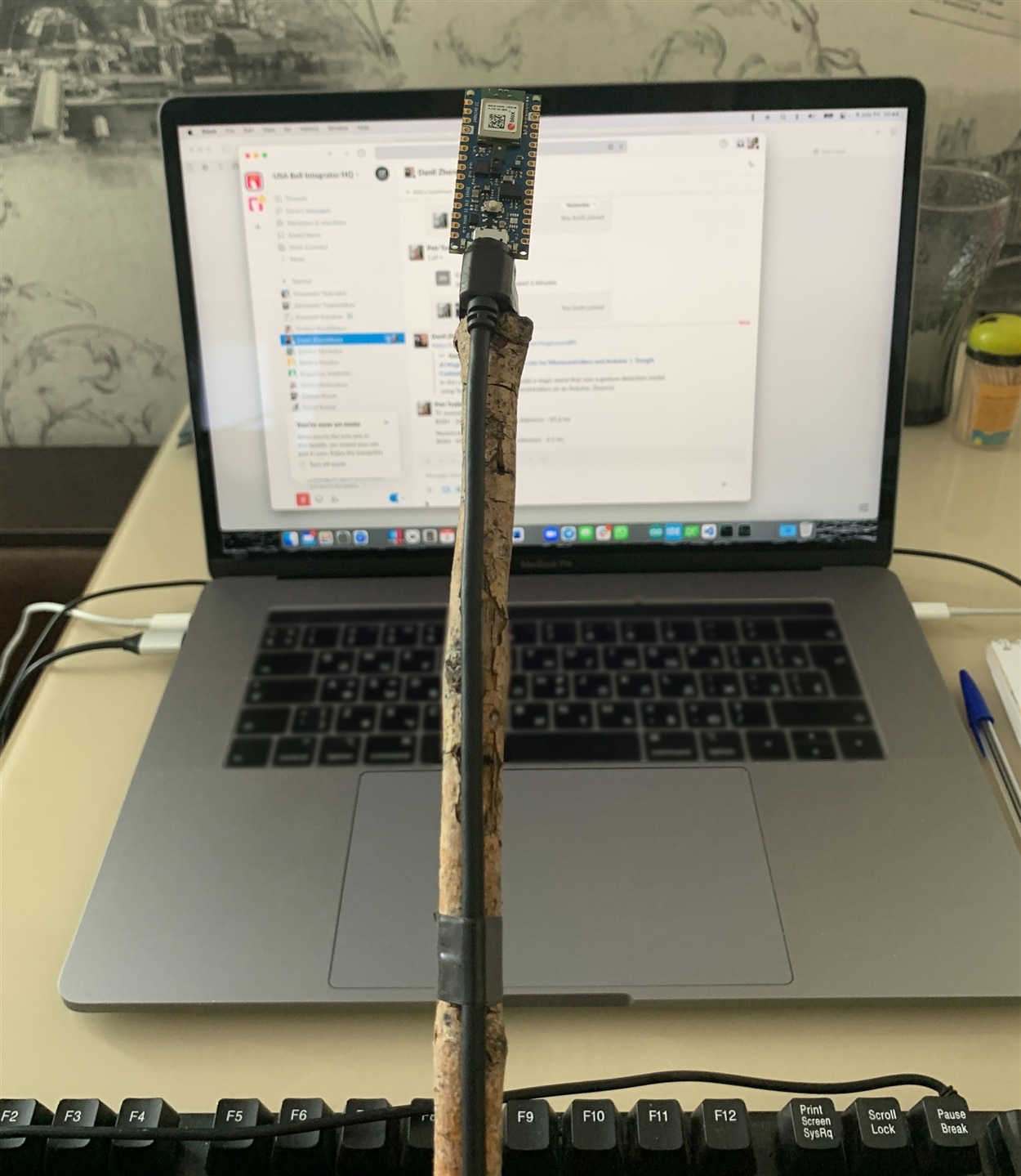

The onboard accelerometer is the main sensor for this use case. The board is attached to the end of a stick/wand with a USB facing downwards, towards the place where you hold it so that the cable runs down the handle. Use sticky tape, a velcro strap, or some easy-to-remove method to attach the board and cable to the wand.

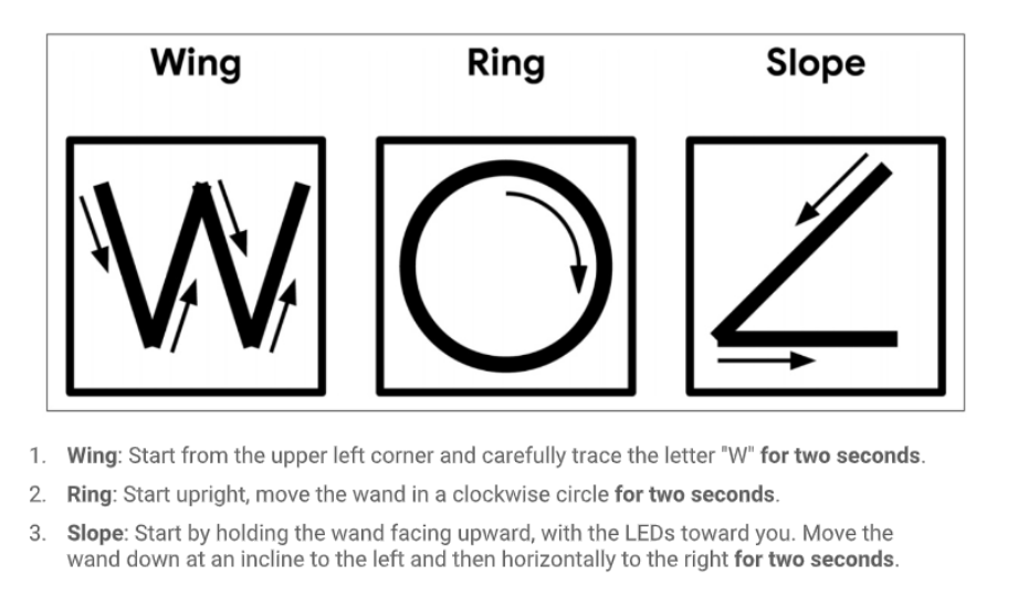

Step 1: Data Collection
The data collection included four classes: Wing, Slope, Ring, and Random class. Sensors reading were collected at 100 Hz frequency, with a sample duration of 2 seconds. So you get 200 rows of accelerometer sensor data for each sample. Check the instruction on how to perform the motion activity for each gesture.
Any other gestures apart from the above are treated as a random class. The codes for data collection are attached in the code section. Below is the summary of the collected training dataset.

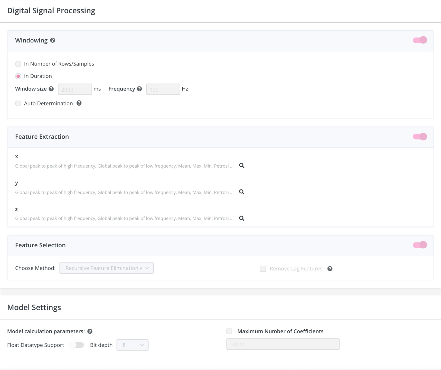

Step 2: Model Training
Upload your dataset on the Neuton platform and enable the following training settings:
Input data type: FLOAT32
Normalization type: Unified Scale for All Features
Window size: 2000ms
Frequency: 100 Hz
Feature Extraction Method: Digital Signal Preprocessing Neuton pipeline (enabled by default) which creates statistical features for each of the original features processing a window of 2000ms.
Feature Selection Method:
  • Disable option Remove Lag Features
  • Select recursive Feature Elimination with Cross-validation
Bit depth: 8-bit

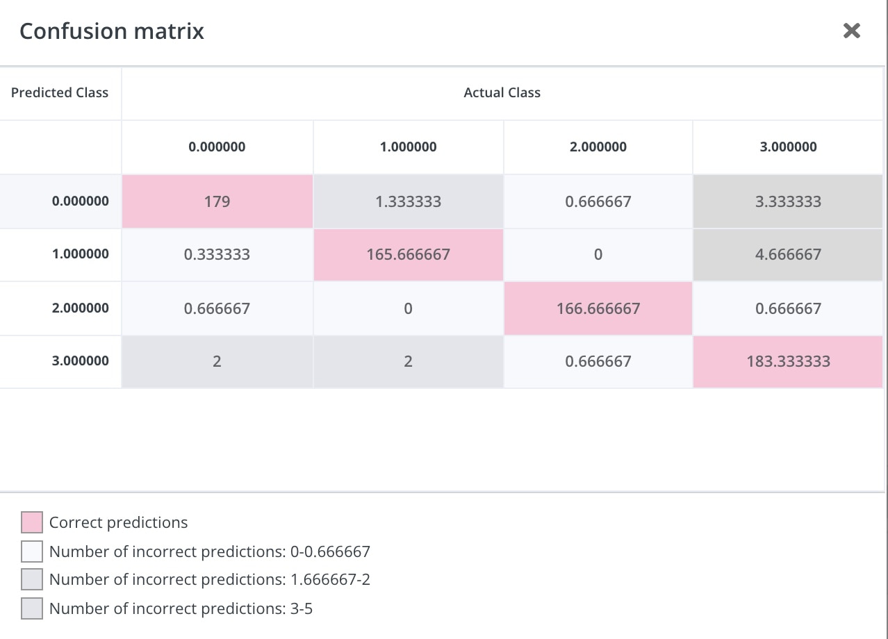

Once training is complete, you can check the metrics on the console. In my case, I got Accuracy: 0.977028.
From the confusion table, I can see that the model works really well across all target classes.
I got a model that weighs about 1 kb!
