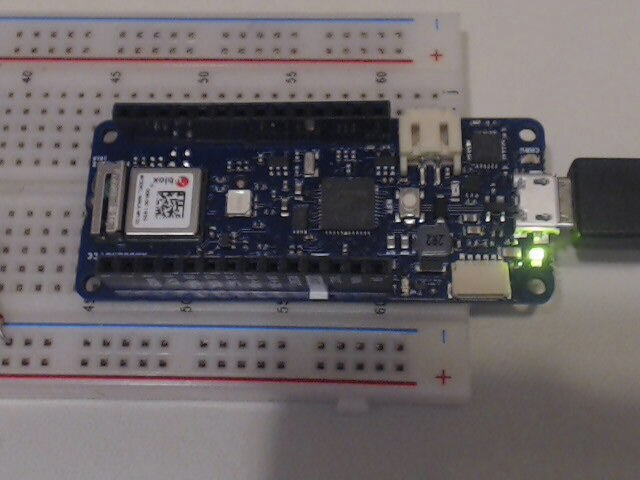

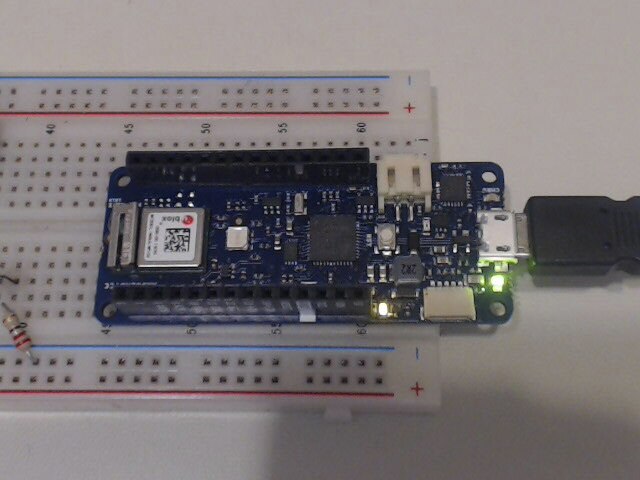

5. To update the Firmware, navigate to File->Examples->WifiNINA->Tools->FirmwareUpdater
    a. Build and Load this sketch:
        NOTE: Do not open the serial term window. Close it if it is open.
       This places the MKR WiFi 1010 into a mode to allow the firmware to be updated; it does not update the firmware

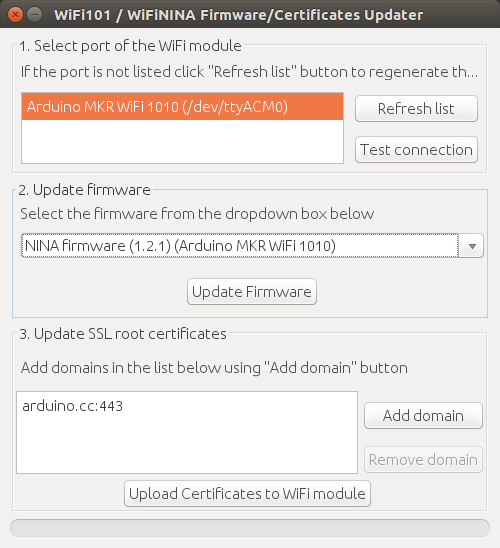

6. Load the new firmware as follows:
    a. From Tool menu option, select: Wifi101/WifiNINA Firmware Updater
        NOTE: This will bring the Updater window
7.  In the text window under Select port of the WiFi module, select the module associated with the connected MKR module.
    a. Ex:
      Arduino MKR WiFi 1010 (/dev/ttyACM0)
    b. This should cause the Update firmware version to show in the drop-down box.
       EX: NINA firmware(1.2.1) (Arduino MKR WiFi 1010)
8. To verify the connection to the board, click the Test connection button and the connection will be verified.
    a. If successful, a pop up window will show Test successful. Otherwise, an error will show indicating what the possible issue is.

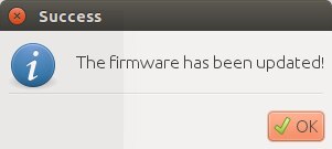

9. If the connection test succeeds, click the Update Firmware button to load the firmware update to the MKR WiFi 1010.
    a. If the firmware update succeeds, a popup window will appear with status Success.
10. Close the Updater window and load the CheckFirmwareVersion sketch again as described earlier.
