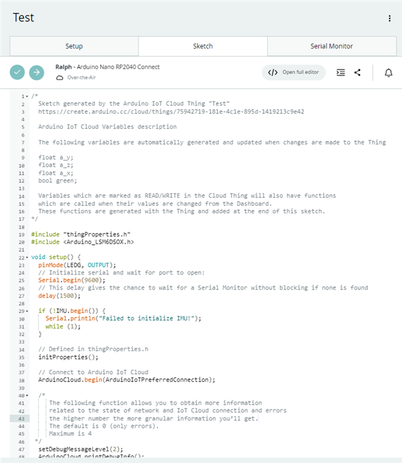

A Sketch template is autogenerated from the setup and all of the variables are declared, but you need to add specifics to how your program uses the device.  In this case I included the sensor library, the sensor initialization code, and the code to read the sensor data.

Here's the full code listing:
  Sketch generated by the Arduino IoT Cloud Thing "Test"
  https://create.arduino.cc/cloud/things/75942719-181e-4c1e-895d-1419213c9e42
  Arduino IoT Cloud Variables description
  The following variables are automatically generated and updated when changes are made to the Thing
  float a_y;
  float a_z;
  float a_x;
  bool green;
  Variables which are marked as READ/WRITE in the Cloud Thing will also have functions
  which are called when their values are changed from the Dashboard.
  These functions are generated with the Thing and added at the end of this sketch.
#include "thingProperties.h"
#include <Arduino_LSM6DSOX.h>
void setup() {
  pinMode(LEDG, OUTPUT);
  // Initialize serial and wait for port to open:
  Serial.begin(9600);
  // This delay gives the chance to wait for a Serial Monitor without blocking if none is found
  delay(1500);
  if (!IMU.begin()) {
    Serial.println("Failed to initialize IMU!");
    while (1);
  // Defined in thingProperties.h
  initProperties();
  // Connect to Arduino IoT Cloud
  ArduinoCloud.begin(ArduinoIoTPreferredConnection);
     The following function allows you to obtain more information
     related to the state of network and IoT Cloud connection and errors
     the higher number the more granular information you’ll get.
     The default is 0 (only errors).
     Maximum is 4
  setDebugMessageLevel(2);
  ArduinoCloud.printDebugInfo();
void loop() {
  ArduinoCloud.update();
  //reads acceleration
    if (IMU.accelerationAvailable()) {
    IMU.readAcceleration(a_x, a_y, a_z);
void onAXChange() {
  // Do something
  Serial.print("AX: ");
  Serial.println(a_x);
void onAYChange() {
  // Do something
  Serial.print("AY: ");
  Serial.println(a_y);
void onAZChange() {
  // Do something
  Serial.print("AZ: ");
  Serial.println(a_z);
void onGreenChange() {
  if(green){
    digitalWrite(LEDG, HIGH); //turn on GREEN
  else{
    digitalWrite(LEDG, LOW); //turn off GREEN
One thing to note is that unless you open the full editor, you won't be able to see the other files that the Sketch is using - most importantly "thingProperties.h" in case something in the setup is incorrect (I have had the automation get stuff screwed up).
