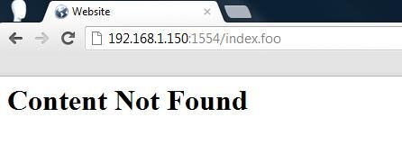

Error Checking:
There is also some error checking in there to make sure that the file that the client wants is a file that we have.  If it is not, then we send them back an error response.  There are a couple of options on how to do this.  We could send an error message back in the initial response, telling the browser that the file was not found, or we could tell the browser that everything is fine and send back a webpage to the client that informs them that the file could not be found.  I’m going to do the latter because it makes for a prettier web page when something goes wrong.  So, here’s the code that sends back an error web page when the requested file could not be found:
private static byte[] ErrorResponse = Encoding.UTF8.GetBytes("<HTML><HEAD><TITLE>Website</TITLE></HEAD><BODY><H1>Content Not Found</H1></BODY></HTML>");
private void SendErrorResponse(Socket client)
   string header = ResponseBegin + ErrorResponse.Length.ToString() + ResponseEnd;
   client.Send(Encoding.UTF8.GetBytes(header), header.Length, SocketFlags.None);
   client.Send(ErrorResponse, ErrorResponse.Length, SocketFlags.None);
We are still using the same header, but we are returning a webpage that simply states “Content Not Found”. Which should look something like this:

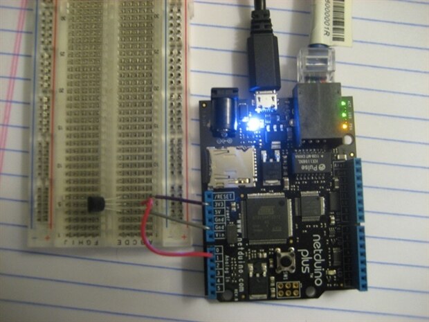

Adding a Temperature Sensor:
All of the web page content that we have been talking about so far has been static content.  Meaning that all the webserver does is grab a file from the SD card and hand it to the user.  I wanted to go one small step further and incorporate some dynamic content to the website.  By this I mean that I wanted to do some preprocessing on the files that I retrieve from the SD card, before I send them to the client.  (Think PHP.)
A common netduino project seems to be home automation and common task within that is to take a temperature measurement.  So, I thought it would be neat to add some preprocessing code into the html file that tells the netduino to read the current temperature in the room and embed that in the html response.
So, here is the circuit that I wired up to the A0 pin of the netduino:
Then I wrote the following class that takes a temperature measurement:
public class MCP9701E
   private AnalogInput _input = null;
   private const float Vdd = 3.3f;
   private const int TempSensorMin = 0;
   private const int TempSensorMax = 1023;
   private const float V0 = 0.4f;
   private const float Tc = 0.0195f;
   public MCP9701E(Cpu.Pin pin)
      _input = new AnalogInput(pin);
      _input.SetRange(TempSensorMin, TempSensorMax);
   public float GetTemperature()
      int measurements = 5;
      long sum = 0;
      for (int i = 0; i < measurements; i++)
         sum += _input.Read();
         Thread.Sleep(100);
      sum = sum / measurements;
      float voltage = ((float)sum) / (TempSensorMax - TempSensorMin + 1) * Vdd;
      return (voltage - V0) / Tc;
The conversion from voltage to temperature is right out of the data sheet.  The only interesting part of this code is that I take 5 measurements, spaced 100 milliseconds apart, and averages the results.  This yielded a more consistent temperature measurement.

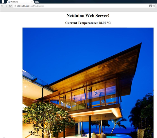

To tie it all together, I decided to create my own file type (a .sme file), and define a html tag (<?sme … ?>) that told my preprocessor that the text between it needed to be interpreted.  By creating my own file type, only files of that type have to be read in and checked for the magic tag that I created.
In order to keep it simple, my preprocessor language only has one command ($a0), which reads the value from A0 analog input pin and returns its current value.  This was done in the interest of keeping the code simple and straight-forward.  Hopefully in the future I’ll expand on this as I need more features, but this is good enough for now.
So, here is what the html code looks like for my sample page:
<html>
<title>Netduino</title>
<body>
  <h1 style="text-align: center;">Netduino Web Server!</h1>
  <h2 style="text-align: center;">Current Temperature: <?sme $a0 ?> &deg;C</h2>
  <img style="display: block; margin-right: auto; margin-left: auto;" src="house.jpg" alt="house"></img>
</body>
</html>
And this is what it looks like when viewed in the browser:
