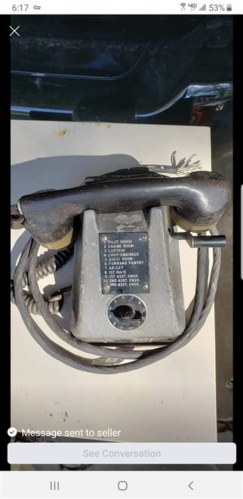

Old Battleship Phone With Arduino UNO
Steve524
Steve524
22 May 2024
This is an old restoration project of an old battleship phone which I retrofitted with an Arduino UNO and a BCD MP3 player module. The front of the phone has a selector switch which I tied to the inputs of the Arduino which then sends a BCD code to the MP3 module to select audio from one of the 12 positions. The audio I selected for each of the 12 positions is a different SIT tone (Situation Information Tone) used by the landline phones, you may recall what it is with the tones you hear when you mis-dial or no one is at the phone number you called. Two of the 12 samples are attached below.
Fullscreen Old_Ship_Phone.txt Download

    DAB over 2 years ago
    Very cool project.
    dougw over 2 years ago
    Nice score. Nothing like solid and authentic hardware to give a project great cachet.
  • javagoza
    javagoza over 2 years ago in reply to shabaz
    You put all your effort into putting everything together with arrays and loops and then the compiler comes along and makes you a loop unrolling. I'm just kidding, I'm also an advocate of readable and maintainable code.
  • Steve524
    Steve524 over 2 years ago in reply to shabaz
    I did not use arrays in that particular setting but I use arrays in other projects. This was just quick and dirty to put together to make it work, although I do like what you have posted with the alternative code thank you very much.
    shabaz over 2 years ago
    Very interesting project, it's a great idea.
    I had to comment, not to detract from the project or the current code, but just as a suggestion, that the code can be significantly reduced (to less than a third), by using arrays.
    That's often worth doing, because that means there is a lot less to debug, and can be quickly adjusted if (say) there were more or less selector switches and so on.
    I've had a go at doing it, I have not tested since I don't have your setup. It is definitely worth looking through though, because you'll see the differences compared to your code which you already know, and the comparison can often be a simple way to quickly pick up on programming methods/styles (not saying mine is perfect, it isn't). I would have done a few more things differently, a few things are redundant but I kept it all in a near-identical way so that it is easy for you to see the differences.
