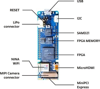

2. Introduction to the MKR VIDOR 4000
Arduino MKR Vidor 4000 features on board FPGA using the Intel Altera Cyclone 10 L016 FPGA, a Microchip SAMD21 microcontroller, WiFi and BLE with a U-blox NINA 102 module, 8 MB of SDRAM, 2 MB of QSPI Flash (1 MB for user applications), a Micro HDMI connector, and a MiPi connector.  The FPGA contains 16K Logic Elements, 504Kbit of embedded RAM and 56 18x18 bit HW multipliers for high-speed DSP.
In Arduino IDE, the Atmel SAMD Core for Vidor Shall be added into the Boards Manager, unlike other MKR series like MKR 1100, the  SAMD Core SAMD21 can do little to Ports and Pins. It plays more roles as Interconnected Bridge between Developers and FPGA cores.USB Blaster is center part of the  MKR VIDOR 4000  kit, I assume.
Since Programming the FPGA is possible in various ways:
  1. flashing the image along with Arduino code creating a library which incorporates the ttf file
  2. programming the image in RAM through USB Blaster (this requires mounting the FPGA JTAG header). this can be done safely only when SAM D21 is in bootloader mode as in other conditions it may access JTAG and cause a contention
  3. programming the image in RAM through the emulated USB Blaster via SAM D21 (this component is pending release)

Like rest of the MKR borads,  MKR Vidor 4000 runs at 3.3V. Applying more than 3.3V on any pin will damage the board. The VIN pin may be used to power the board but the voltage supplied must be 5V.
What make it unique is Pins, The standard MKR arduino pins of Ax and Dxx can  be routed through the FPGA as well. This is the flexibility of the FPGA technology In depth knowledge of both are required, to quickest startup is using a basic set of FPGA based functionalities, grouped into two main libraries: VidorIPeripherals and VidorGraphics. It can be sample for developers as well.
The MKR Vidor 4000 deploys different Development Cycle and it is really innovative. But need time to prove the Robustness, at least the Upload from Arduino IDE shall take longer than I expected, and fails several time.After all, the FPGA lib shall be refresh at the same time.

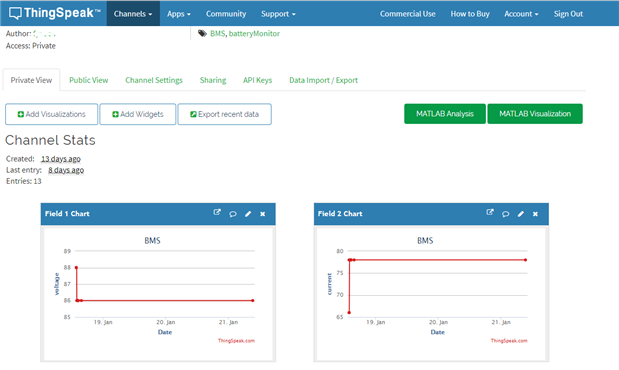

The channel in  thingspeak.com is created.
tsreadCycle for BMS data read with 10s  cycle,
tswriteCycle for data write with 20s cycle,
bmsCycle for Battery Supervised value fetching with 2s cycle, it can be tuned faster
For batter monitor, three value is enough for most cases, voltage,  current,  and temperature for batteries.

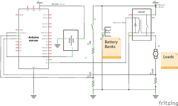

4. The Hardware
4.1 MKR VIDOR 4000
4.2 TLP3547 optical Relay
4.3 LM35 temp sensor
4.4 Resistors and switches

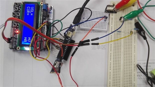

5.  First DEMO, SAMD play ADC functions
5.1  Hardware wiring demo as follows, SAMD with ADC functions
5.2 The software, demo project with basic supervision functions.

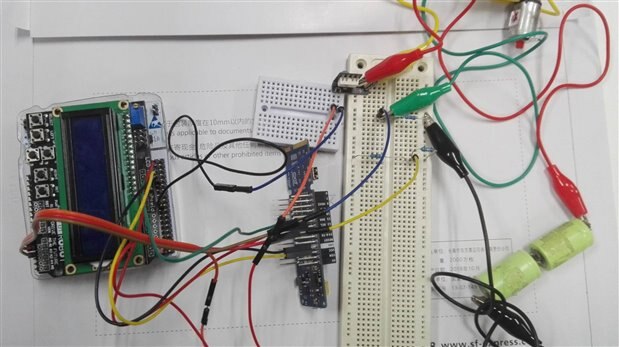

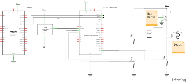

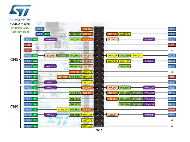

6 . REMOTE sensing with I2C connection
6.1 This part of work use FPGA peripheral library, fetching analogue data from remote MCU. MKR4000 runs with Nucleo board remotely.
MKR 4000 in I2C master mode and Nucleo-STM32F410 in slave mode.
The nucleo-connector according to,

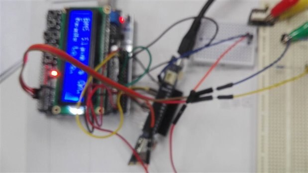

6.2 Remote part running on Nucleo-STM32F410RB, coding in mbed OS5,

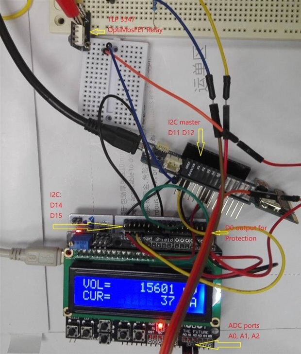

On-line battery bank monitor ADC Ticker every 1 second. Set on MEASURESPAN.
6.3 The FPGA part shall be used.
Here is how it wired.
VidorTwoWire WireFPGA0(1,9,10);
VidorTwoWire WireFPGA1(2,11,12);
VidorTwoWire WireFPGA2(3,13,14);
VidorTwoWire WireFPGA3(4,A0,A1);
6.4 Here  is the code for FPGA1 used for I2C, mostly there are changes in bms_update()

6.5 Application of thingspeak
Here is the screenshot from thingspeak with BMS project settings.

On-line battery bank monitor can get battery running status and send the data remotely.
Plug the usb connector for Nucleo and MKR4000 board,
