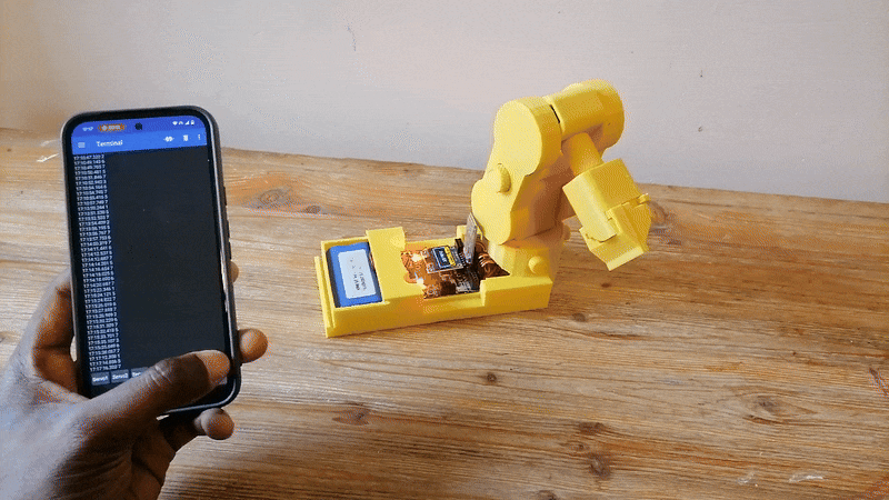

Pedro 2.0 is a fully open-source project, designed to be accessible and customizable for everyone. It’s easy to assemble no screws, no glue, no tools required! Perfect for makers, students, and educators looking to explore robotics and programming.
Certified by the Open Source Hardware Association under UID FR000025
Robot You can now support Pedro on kickstarter  RocketRocket
Technical Specifications
  • Pedro Board (Rev. 3) compact size: 55x55mm.
  • Microcontroller: ATmega32U4.
  • Power supply: 7.4V DC Rechargeable Battery by Micro USB cable.
  • 3D Printed Parts: High-quality PLA or ABS, providing durability and strength.
  • 4 x Servo motors SG90 360° for precise control of the arm’s movements.
  • 2 x Ball Bearings 8x22x7mm for enhanced movement accuracy.
  • NRF24L01 for wireless communication.
  • ESP8266-01 for WiFi and IoT applications.
  • HC-05 for Bluetooth connexion.
  • OLED display 128x64 for real-time feedback
