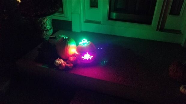

Just in time for Halloween and Fall, a pumpkin… But not just an ordinary pumpkin. This one will stand out of all the other pumpkins sitting on people's porches…. Just sitting there. This pumpkin is about to fly away. Yes, a UFO pumpkin with lights. Ideal for the front porch of a house you want to catch people's eye as they pass by. If Christmas lights and decorations weren’t enough, we are bringing the decorative house lights earlier into the season. Now you can annoy your neighbors with flashing lights before Christmas.
Project by sections:

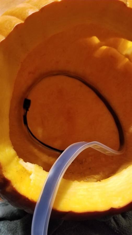

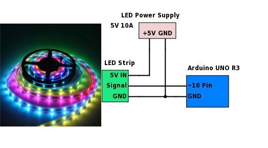

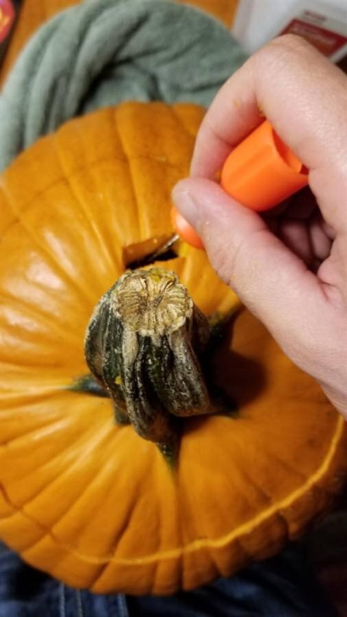

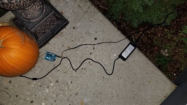

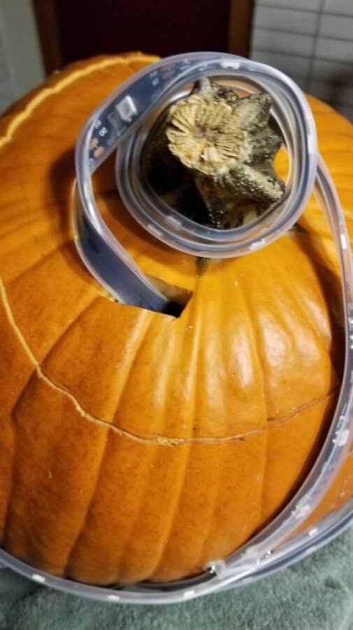

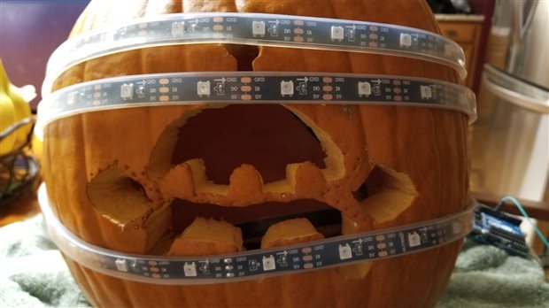

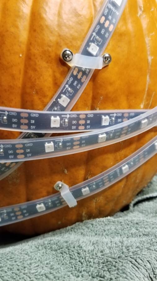

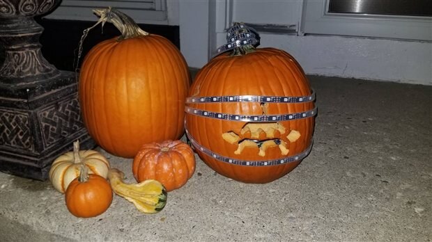

For this project, I carved a pumpkin using a UFO stencil and wrapped it in a 16.4ft WS2812B, individually addressable, LED strip controlled by an Arduino UNO and powered by a 5V 10A power supply.  A 3rd of the LED strip is inside the pumpkin, another 3rd is wrapped around the stem, and the last is wrapped around the outside. The strip is fed through the top lid with a rectangular hole. This 16.4ft strip has a total of 150 Individually addressable LEDs.I created my own lighting sequences and put them one after the other for a UFO-like show.

Schematic and design:

The code was developed using the Adafruit NeoPixel library. This library lets you control the color, brightness, and which pixels are on or off. This library has some examples of lighting sequences to help get started. The code splits up the leds by section, for each of the lighting sequences, the LEDs for the outside, inside, and top get set. The programmer sets which lights are ON and what color, then is displayed to the strip using leds.show(). The sections of the strip are addressed by knowing what LED is lit in each section. There are 150 LEDs, the inside of the pumpkin had 39 LEDs from the end of the strip, so to address the colors and sequences of the inside of the pumpkin you would start from the end of the strip in your for loop and assign the color of the lights from the end decrementing the variable until you’ve reached your last inside LED from the beginning, since we are going backwards in assignment. So the for loop starts at 150 and decrements until it reaches LED 111, this means the LEDs 111 through 150, represent the inside of the pumpkin.

More lighting sequences, remote/trip sensor to start, sunlight sensor to turn on at night. The LED strip was waterproof, but my Arduino was not, so a waterproof case for the power and control electronics would make it last longer outside.

The LED strip came with mounting brackets that made it very convenient to attach to the pumpkin in the back. Also, the camera couldn’t keep up with adjusting the brightness for the LEDs at night ─ so you might see some effect from that. At night it was very bright and definitely will catch the attention of people walking by. As you can see in the zoomed picture below, how bright it is.

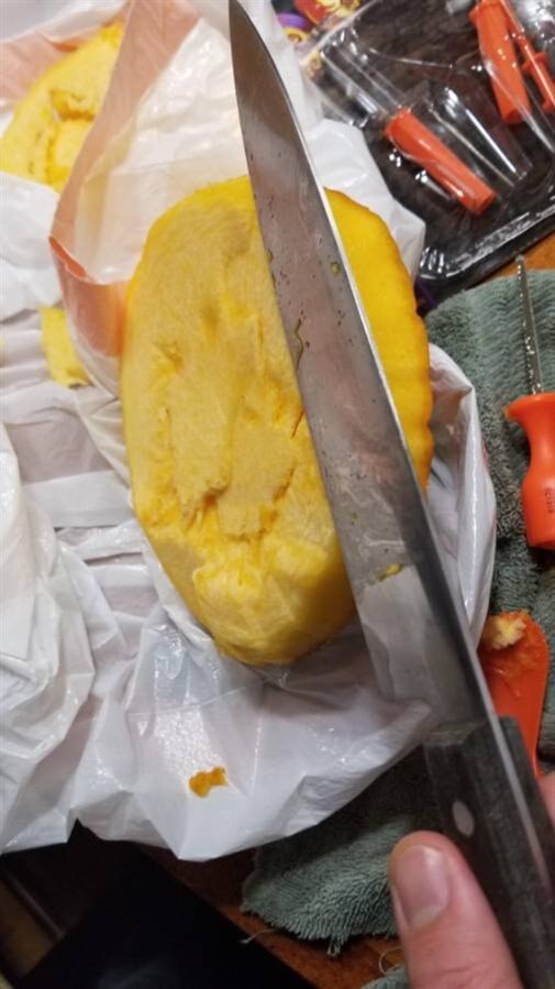

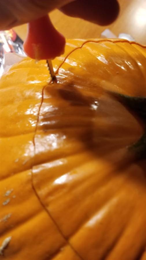

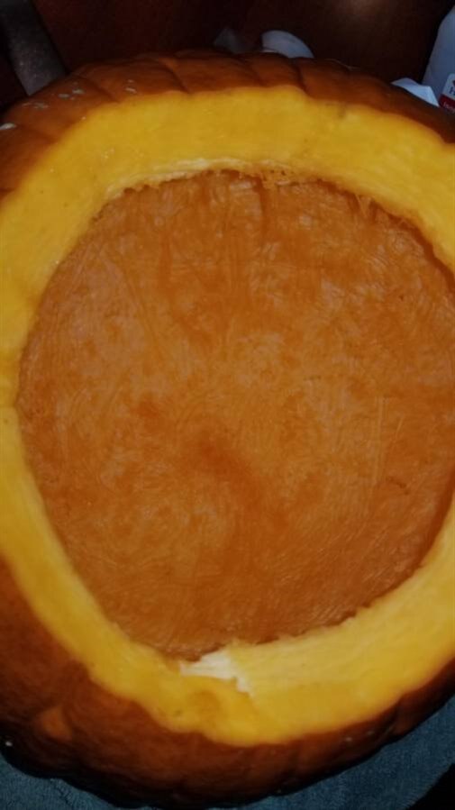

Pumpkin Making:
{gallery} Making the pumpkin
