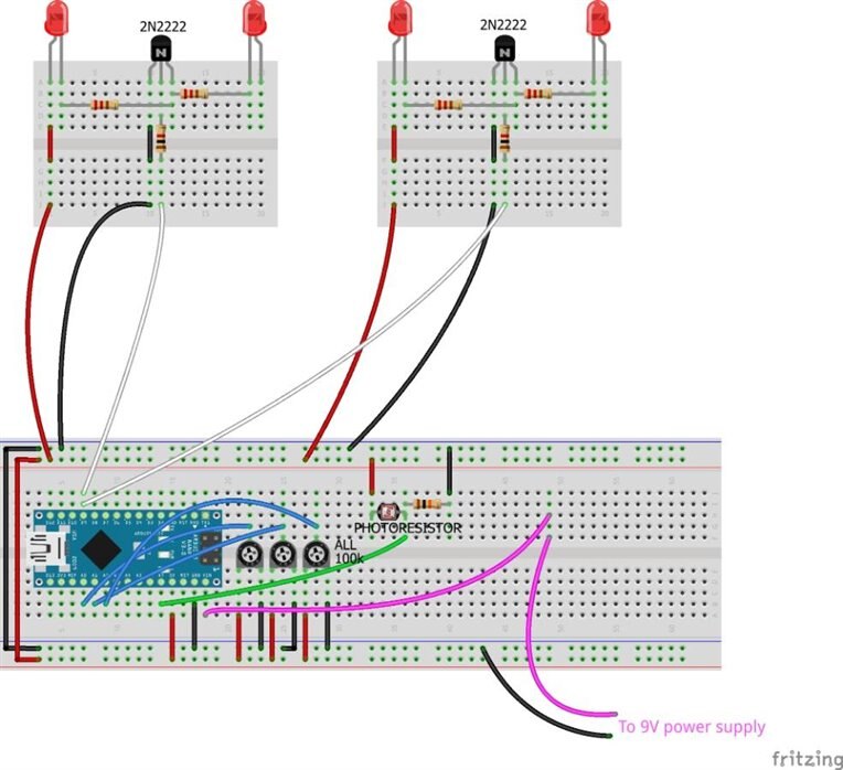

Schematic and design:
It is this simple. The complexity comes in the code.

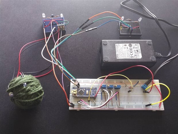

This is the actual build. I strung an extra pair of eyes off of one of the mini breadboards - I stuffed the LEDs into a yarn ball. Also pictured is the 9V power supply I used to power it.
