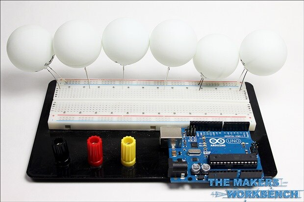

  • 6 Ping Pong Balls with 4.5mm holes drilled out.
  • Arduino Code

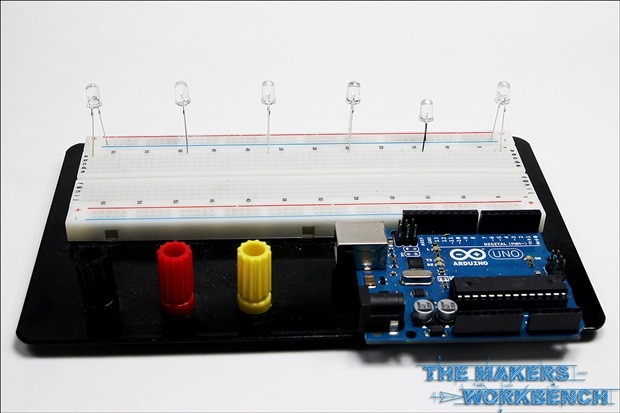

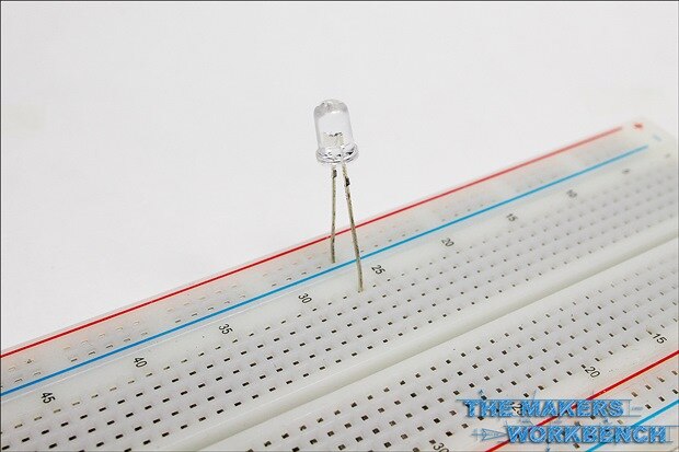

So to kick this off, we need to plug our LEDs into the breadboard. To simplify things, I like to plug the cathode of each LED into the GND rail of the breadboard, and place the anode into the five-position strip that is in line with the GND hole you plugged the cathode into.  This will allow us to use a jumper wire to connect the anode to the PWM pins on the Arduino, and let us only utilize a single GND port on the Arduino as well.
Make sure to space the LEDs far enough apart to ensure that the ping pong balls will have enough room to fit. To get an idea of how much room you will need, six ping pong balls will take up the entire surface area of a standard breadboard. Once you have all of your LEDs in place, push the ping pong balls onto the 5mm LEDs.
With the LEDs now in position, we can move on to wiring everything up. Starting from the left, attach the first LED anode to digital pin 11 on the Arduino. Follow this up by attaching the next LED’s anode to digital pin 10. The third LED attaches to digital pin 9, with the fourth, fifth and sixth attaching to digital pins 6, 5, and 3 respectively.

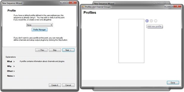

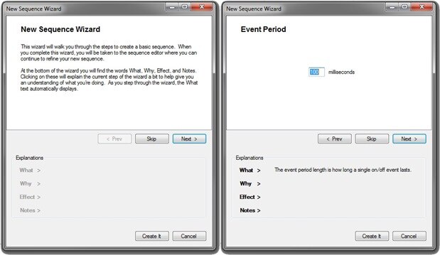

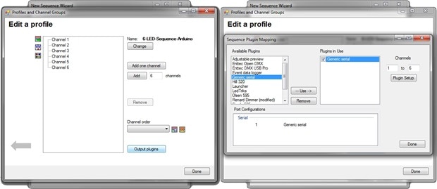

Installing Vixen is fairly simple as it comes already unpacked into its directory. Make sure to place it somewhere you will remember to find it such as the desktop, or in your documents folder. To begin, launch Vixen and let’s set up a sequence. This is a very important step and very close attention should be paid and every step should be followed exactly for things to work properly. To start, click on the sequence tab and navigate to New Event Sequence > Vixen Standard Sequence.
Once you click on Vixen Standard Sequence the New Sequence Wizard will pop up and prompt you with a few configurable options. The first major thing you will need to set up is the Event Period. This value determines the period of time that each LED will stay lit. You can adjust this time down to 25-miliseconds and up as high as 1 second. For the purpose of this tutorial, we are going to keep it simple at 100-miliseconds, giving us 10 events per channel, per second.

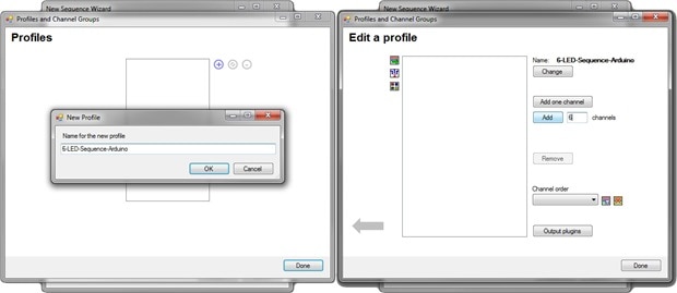

Up next is where most of the configuration happens. To make things simple, we are going to create a profile that we can save and re-use in the future.  Click Profile Manager and then click the Add icon that is highlighted in the image above.
Give the new profile a name and then click OK. At this point the Edit Profile screen will pop up, and you need to add six channels.

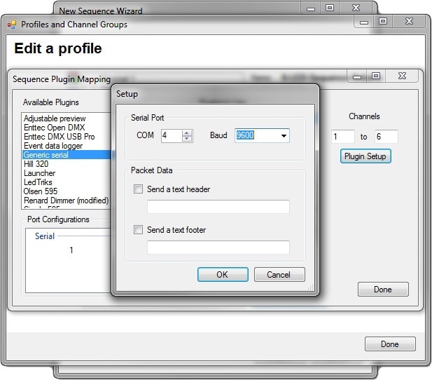

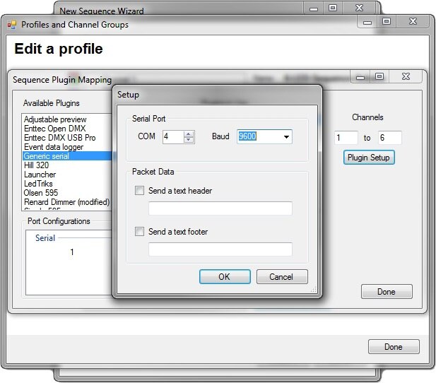

Once the six channels have been added click the Output Plugins button and you will see the Sequence Plugin Mapping configuration window pop up. Under Available Plugins, select Generic Serial, and click the Use button. Set the channels from 1 to 6, and click the Plugin Setup button.
Set the Com Port to 4 (also make sure your Arduino is set to Com Port 4) and set the Baud Rate to 9600 and then click OK.

The Profile window will once again pop up, and you will need to select the profile you just created, and then click next. Since we are not adding any audio to this sequence, click next on the Audio and Event Patterns window.

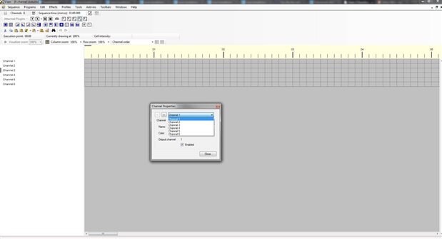

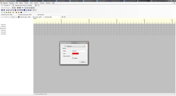

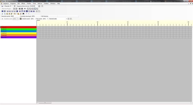

To keep things organized and easy to configure we need to assign a color to each channel. To do this we must right click on the channel list, and select Channel Properties.
When you click Channel Properties, a small window will pop up and will have several configurable options. For the purpose of this tutorial, we will just be changing each channels color. Set the first one to red, and then click the channel dropdown and select channel two.
Continue doing this until each channel has a unique color. I color coded the channels in my sequence to reflect the LED colors on my breadboard.

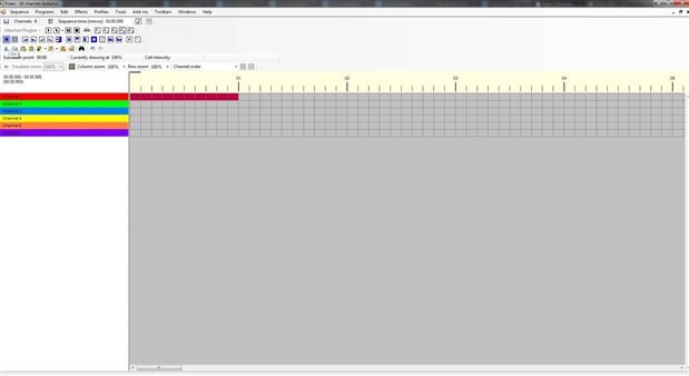

So let’s begin building the sequence. Click and highlight the event periods you wish to enable, and then click the solid square button in the control bar as seen highlighted in the image above. You can also enable the event periods by pressing the spacebar. Play around with the rest of the buttons on that row for some cool effects. I don’t want to dive too deep into building advanced sequences as that is an entire article on its own, and this tutorial is already long enough.
Now we can run the sequence. Make sure the Arduino is plugged in and is set to Com Port 4 in the Device Manager. If everything is correct, click the play button located at the top left of the Vixen Sequence. You should see the LEDs begin to light up and follow the sequence you just built. If you get a router / com port error, simply save your sequence, close Vixen and Arduino and reopen Vixen and load your sequence. Things should work now.
