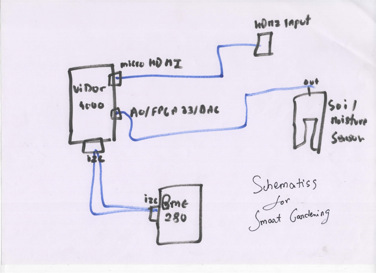

Schematic/ Wiring:
All the Wiring is pretty simple, nothing like biological science!

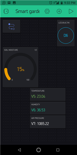

This project works very simple but works well. Our goal is to make Gardening Interesting with the use of FPGA. To do that we need to monitor different conditions and control the devices according to that. We also want to monitor that data on our smartphones and also send alert emails/SMS. The sensors for this prototype are very basic (uses mentioned above). This sensor will give us the data on the Blynk app, where we will address it. This system can detect Soil Moisture, with Atmospheric Conditions to predict and water the plants. The pump will be controlled in this way.

For the server side, I used the free Blynk service, to which Vidor connects via the WiFi, and publishes the data. Then, the Blynk server with its eventor widget decides about the watering of plants.  Quite simple.
Here, you can change V2 to any digital pin.

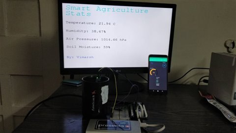

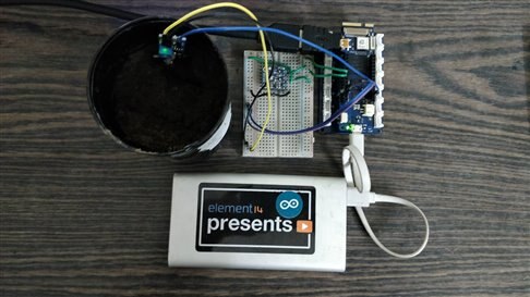

The Final Product:
This is my Final Arrangement with all things connected. (not a permanent setup but a working one). I have tested this outdoors in soil and it works fine, but of course, the HDMI thing, I neede to make the below video indoors.
