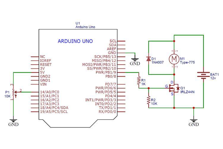

Circuit Diagram of Speed Control of DC Motor Using MOSFET
Circuit Diagram
Here's the simple circuit diagram for controlling a DC motor's speed using an Arduino and a MOSFET. This minimal-component design is easy to understand. For direction control, check out our L293D project.
Circuit Diagram Overview:
Components: Arduino UNO, MOSFET, 1k Ohm resistor, 10k Ohm potentiometer, diode, 12V power supply.
Connections:
MOSFET connects the Arduino to the motor, acting as a driver.
The 9th pin of the Arduino (PWM capable) controls the MOSFET.
The potentiometer connects to 5V, ground, and A0 for variable voltage input.
A diode protects against reverse EMF from the motor.

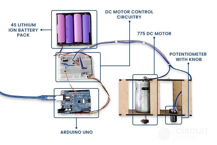

Component Assembly of Speed Control of DC Motor Using MOSFET
Assembled image
We used a breadboard to assemble the simple circuit, a power bank for the Arduino UNO, and a 4S Li-ion battery pack for the motor. The connections follow the previously discussed diagram.
Ensure the breadboard is in good condition to avoid connection issues.
