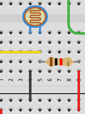

The connection for the LDR sensor is connected as per the image below. One end is connected to the Ground and and the other side is connected to resistor and from resistor to VCC. The output signal from the LDR is tapped between the LDR leg and the resistor leg.

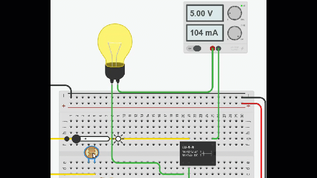

Next, the connection for the relay and the lamp is done as per the image below,
Once we are fine with the hardware, we can move on to the coding part.
The coding part for this is pretty straight forward. As you can see, the first line shows that the we read the input from the analog pin A0 and print it to the serial monitor. Next we do the conditional formatting, whereby we check the value of A0. If the value of A0 is equal or more than 500 it sets the digital pin 4 to LOW, and if  the value is less it sets the pin 4 to HIGH. The pin 4 is connected to the relay.
Below is the result of this tutorial.
