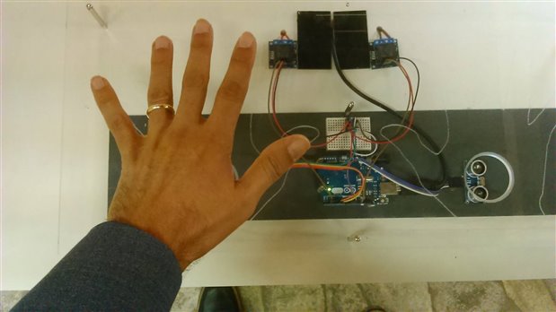

Few months ago we needed to realise an interactive experiment for kids, consisting in making light pass through a prism to be dispersed into a rainbow. The light was powered by a 220 V power outlet and must be controlled by kids looking at the experiment. Needless to say, the simplest solution was just to mount a switch on the power cord, such that the visitors can just switch the light on and off. In order for the experiment to be ready for next visitor, a better solution was evaluated to be a push button. But having a push button (or a switch) directly connected to 220 V can be potentially dangerous. Even if there are clever devices or mounting strategies to reduce such a risk to zero, we soon turned to a different solution, for the sake of originality.

Using this device is then extremely simple with Arduino: just connect the GND and 5V pins to the corresponding pins on Arduino, while the trigger and echo pins must be connected to digital Arduino pins (e.g. 9 and 10). The pin connected to the trigger pin of the HC-SR04 must be configured as an output pin, since Arduino must be able to raise the voltage on it from zero to 5 V, while the echo pin should be configured as an input pin, since Arduino must detect when it flips from 0 to 5 V.

THRESHOLD is a constant representing the minimum time a sound wave should take to go back and forth from the obstacle. It is not necessary to find its exact value. It can be determined experimentally just finding the number returned by the sensor when the obstacle is at the wanted distance.

In the picture above you can see the system and how it operates (the real system we built had two sensors and two relays, each dedicated to a different device. The Arduino board can be seen in the middle. On its right there is the ultrasonic sensor. Relays can be seen on top of the figure. The sensors and the relays were covered by a transparent plexiglass screen with two holes corresponding to the position of the sensor (there is no need for the screen to be transparent: we chose it to be as such to let the users see what was inside). The holes were necessary to let the sound waves to be propagated toward the ceiling (the plexiglass screen reflects sound waves). Putting a hand close to the hole through which the sound waves pass, makes such waves to be reflected: the time needed to travel back and forth is recognised to be short enough and the corresponding relay is closed: the lamp switches on. Removing the hand the relay is opened and the lamp goes off.
