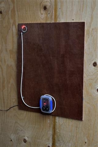

The photos below show the false wall I put in my garage to test it out.
I was very happy with the results.
photo source : three minions (me, myself and I)
This is the final distance, and from the drivers seat looks like it is touching.
Normally you would be reversing into the garage and having the issue of parking in the right spot, but everyone's needs are different, and this works forward or back.
The relative position of the display v the sensor may need changing to suit the vehicle and direction.
I mounted it over to the right to allow viewing in an external mirror.
