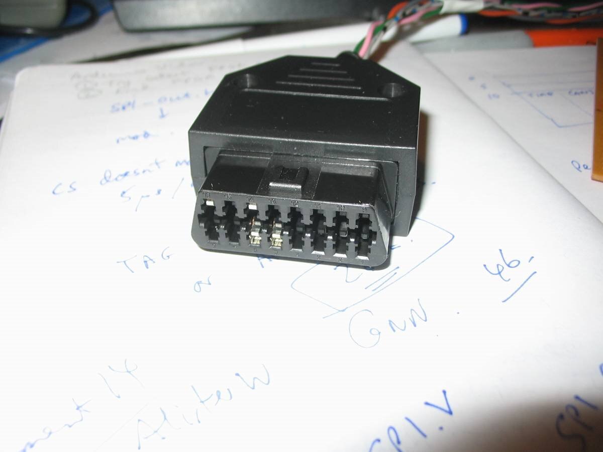

Before the Arduino Vidor 4000 arrived, I purchased an OBD-II connector and wired up its crimp terminals to what should be CAN+. CAN-, Ground and +12V.

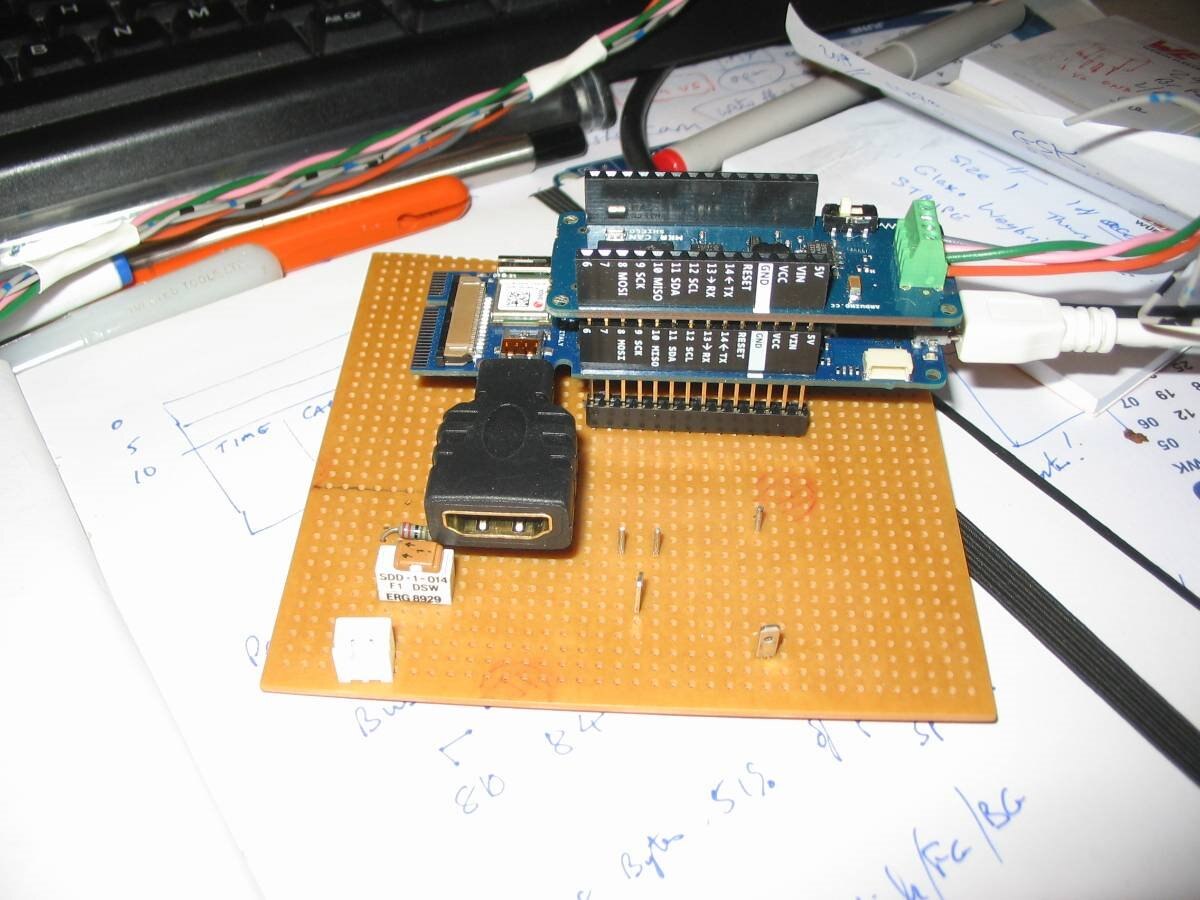

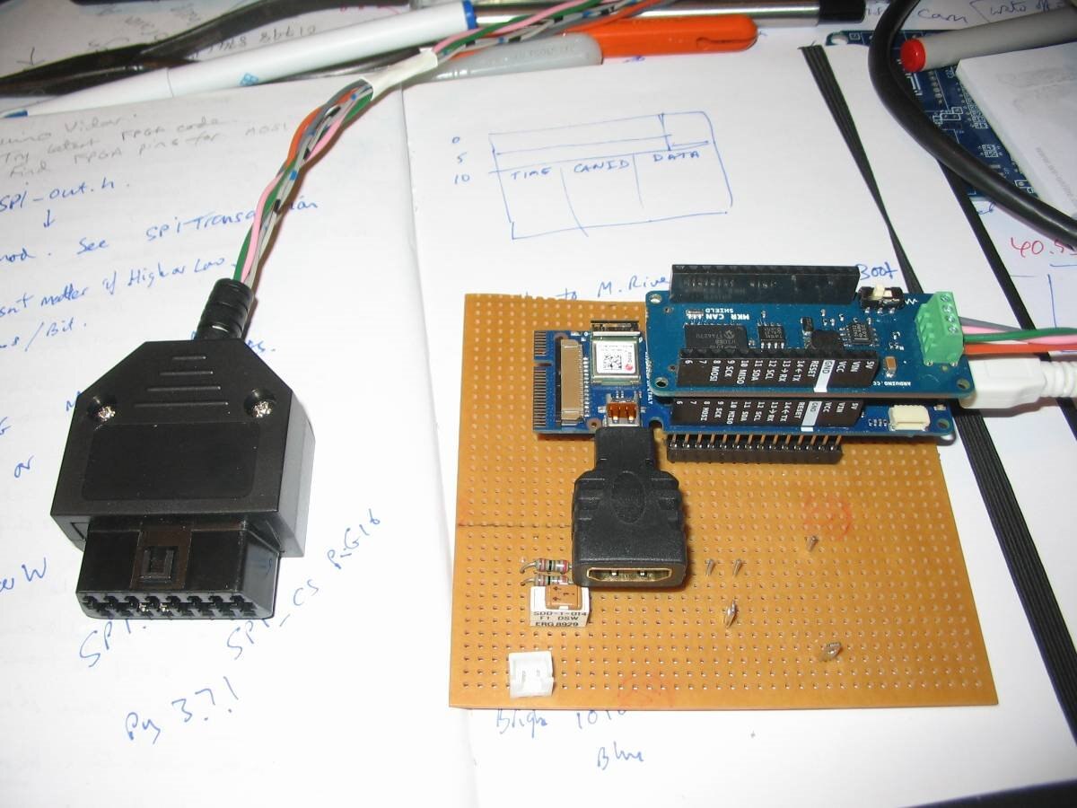

The next problem was that TEXT-DEMO now refused to display anything when the CAN Shield was plugged in. That was because both the MCP2515 CAN interface and FPGA text interface use the same SPI port and also some control lines e.g. INT and FPGA_CS (chip select) on the same pin. Because the Shield is hard-wired I had to move the FPGA_CS signal from Pin 7, to Pin 6, and that was very easy to do: in the Pin Assignment editor, change SPI_CS's pin from F16 to G16. The SPI port can talk to multiple devices provided chip selects are separated. To make debug easier, I soldered a 28-pin IC socket onto a piece of strip board and soldered in some pins on useful tracks viz. 0V, MISO, MOSI, SCLK and Pin 3 (CAN_CS). The switch was from a previous project! An HDMI converter is plugged in.

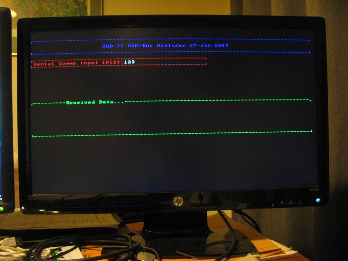

Set up some rectangular panels on the display to hold text messages (title, keyboard command entry, received CAN message display and possibly their meaning), modify the Verilog code to scroll one of the panels, add the scroll command to the Arduino software, and test it. The TEXT-DEMO uses an ASCII character set containing some simple graphic shapes that can be used to draw lines to define each panel.  This technique was used in the days of DOS, and Teletext before pixels could be individually set.

Due to not understanding enough Verilog, I did not manage to do the scroll in FPGA, but had to use the SAMD21 for that. Maybe I will get an idle moment and revisit it. I will also revisit the JTAG loading and see if it can be speeded up. Here is a view of the board ready to be plugged in the car...
And here is the test-based screen display:
It was a bit wet and windy this afternoon as I tried to install the Arduino etc and monitor in my car. That is when a slight nooby problem came along...eagle-eyed readers will have noticed that the sex of my connector is wrong! It would not plug into the female connector on the car! So I will have to order a male connector before I can test it.
