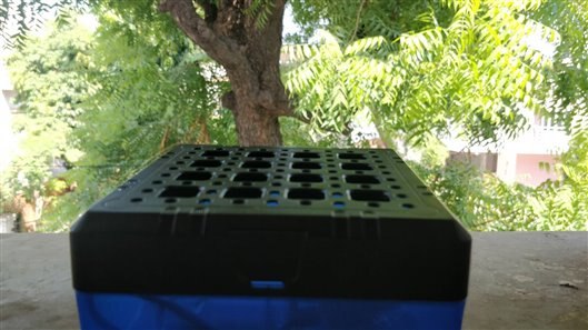

So, I wanted to make a weather station for myself which I never need to think of. With the current implementation I don't even need to look after the device.
The Concept
My goal was simple: Make a weather station that lasts long, really long.

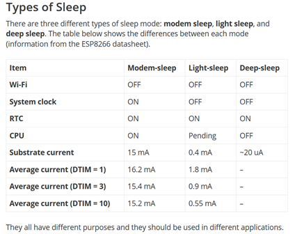

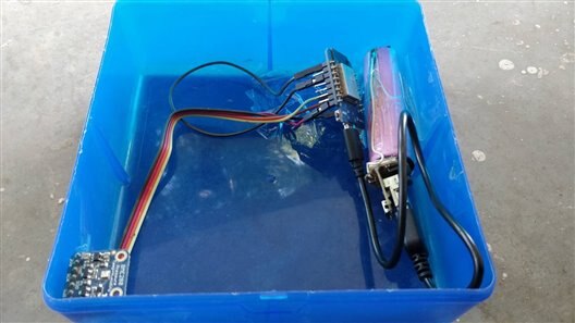

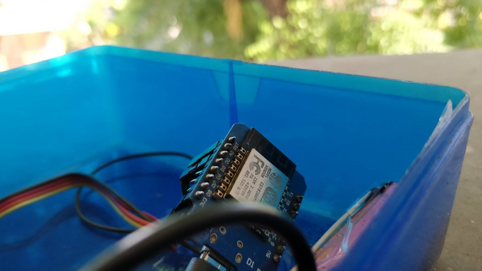

I wanted to use a micro controller that consumes very low power during sleep or when inactive. I also wanted it to have some connectivity to connect is to my network and then to internet to make in an IoT device and accessible from anywhere. I decided to use the ESP8266 - a micro-controller with inbuilt WiFi that uses only 20μA during deep sleep. A prefect choice for the application. I am using the Wemos D1 mini which is small development board and based on some articles I read is closest to raw ESP8266 in terms of power consumption!
Credit: https://randomnerdtutorials.com/image
Wemos d1 Mini that I used for the projectimage

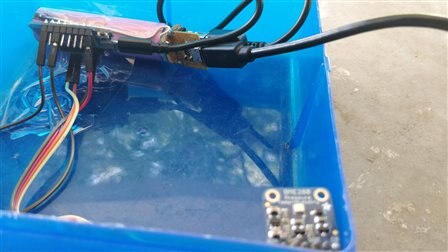

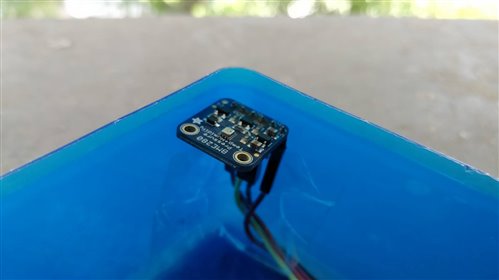

Sensor

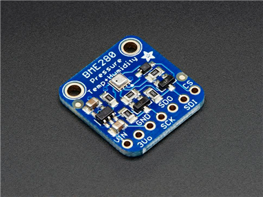

With the microcontroller decided it was time for me to select a sensor. I chose the BME280 which I had already and in my opinion is the best. Although there may be some better ones that exist. The BME280 sensor can measure temperature, humidity as well as Air Pressure with great accuracy. I am using the Adafruit BME280 sensor. It also only It is also very accurate in its measurements.
I wanted to upgrade it to BME680 that also adds a gas sensor to BME280 but it is not widely available in my country.
Datasheet: https://cdn-shop.adafruit.com/datasheets/BST-BME280_DS001-10.pdf
  Sensor in the deviceimageimage

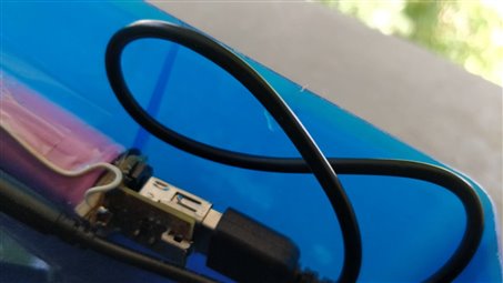

Battery and Charging Circuit
I used a random Samsung 18650 - FM battery with 2.2Ah battery and connected it to a charging circuit. If we use two batteries in parallel connection the capacity is doubled.
You can find a Lithium ion cell in an old laptop battery or just use a power bank (with solar panels)*!
*Although the power banks with solar panels are not recommended to charge mobile phones because phones need lot of energy and small solar panel cannot charge it fast but for this implementation and low current use it can be very well suited.

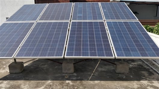

I have huge solar panels on the roof of the house to which I can directly connect my weather station to keep it charged. But a small 6v 100mA solar cell can also keep the battery charged forever. You will need a PCB that can also charge the battetry from solar power. A lot of cheap PCBs exist like this from AliExpress that can charge the battery from solar panels and also deliver 5V power.
         imageSmall Solar Cellimage
Solar Panels on the roof my house.

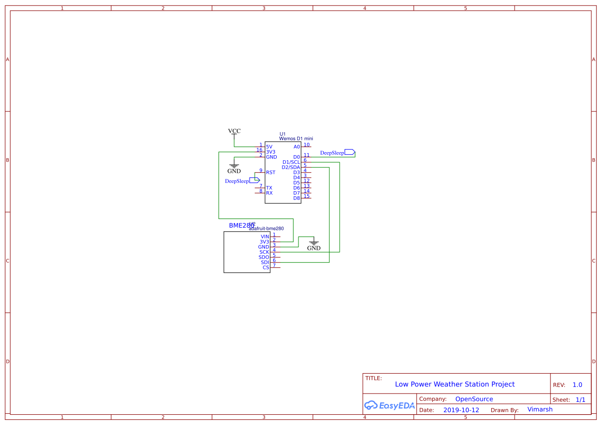

This is the schematic for the project. Basically the sensor is connected to the device with I2C communication and the Reset pin of Wemos is connected to D0 pin. It is powered directly with USB.
https://easyeda.com/vimarsh244/low-power-weather-station

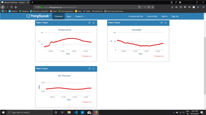

ThingSpeak
ThingSpeakTm is an IoT analytics platform service that allows you to aggregate, visualize and analyze live data streams in the cloud. ThingSpeak provides instant visualizations of data posted by your devices to ThingSpeak. With the ability to execute MATLABRegistered code in ThingSpeak you can perform online analysis and processing of the data as it comes in. ThingSpeak is often used for prototyping and proof of concept IoT systems that require analytics.
We are using ThingSpeak's REST API to send data. https://in.mathworks.com/help/thingspeak/write-data.html
With ThingSpeak we can see our data over the cloud from anywhere and it also stores all the data for a long long time which can help us for analytics about weather in a region. It can be used in cities near crossroads, near dump-yards or where long time data can help understand the pattern of weather. It can also be used in forests with use of LoRa or Sigfox to transmit data over long distances and get alerted from forest fires and understand temperature patterns to help prevent it.

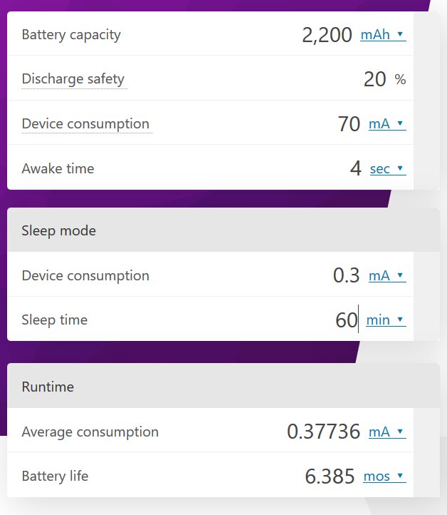

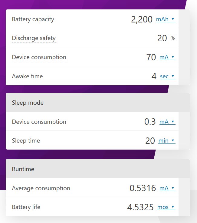

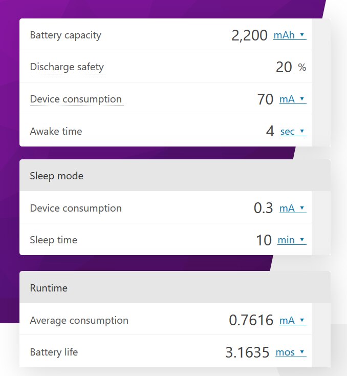

Battery Life
Even though the deep sleep current for ESP8266 is 20uA I could measure 0.3mA which can be dues to the charging circuit or the whole development board. With those values I have calculated the following battery life.
{gallery}
If the data is sent every 10 minutes
If the data is sent every 20 minutes
If the data is sent every 30 minutes
If the data is sent every hour

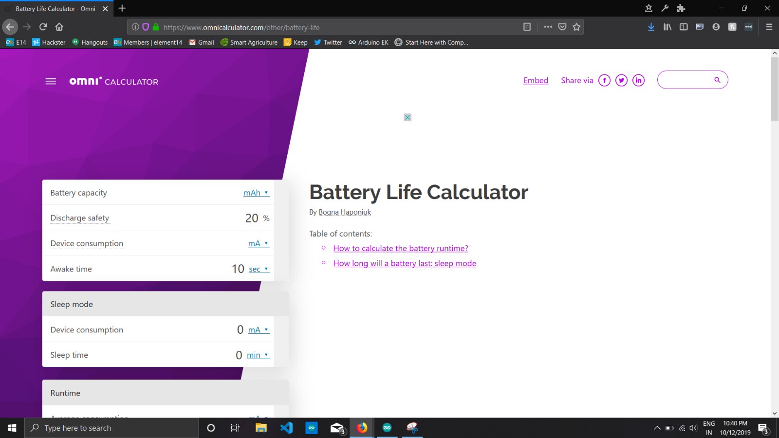

A great Battery Life and other calculator: https://www.omnicalculator.com/other/battery-life
With the current implementation my weather station if does not get any power will last 3 months without external power. Surprisingly if I add this small solar cell to the circuit then it can run for 2 months longer! So with a good 6v solar panel that is commonly available the project doesn't even ever need to be connected to external power.

You can see the weather data of my region on ThingSpeak: http://tiny.cc/WeatherStation
Readings from my Weather Station

    I am using the same battery and charger to power the weather station. The battery is being charged and discharged according to the specs. The battery charging circuit is the same that came inside the power bank.
    And yes, it is still being powered and sending data. Since I have a solar system I just connect 5V directly to the charging circuit so that it doesn't need to be charged! Although it may reduce the battery life.

    You are right probably the sensor will consume power and also the battery bank circuit in bumping up the voltage. So I could measure little more current.
    If you want to calculate the battery life this is a great website: https://www.omnicalculator.com/other/battery-life
    As dubbie said, I also think that battery chemistry especially of Li-ion is not great and over time its capacity may also reduce. I will find out how the battery lasts and keep the post updated.

    If you look further down the article from randomnerdtutotials.com, you will see the comment in relation to Deep Sleep :
    This is the most power efficient option and the ESP chip only draws approximately 20uA. However, if you use a full-feature development board with built-in programmer, LEDs, and so on, you won’t be able to achieve such a low power state
    My own investigations: https://www.element14.com/community/people/neilk/blog/2019/02/14/investigating-the-power-consumption-of-a-wemos-d1-mini-esp8266       suggest that the Wemos D1 mini board consumes over 200 uA  when in Deep Sleep. In your case, the BME680 will probably consume some power as well.
    When the system is awake, much more power will be consumed, especially during startup and when communicating via WiFi.
    My system runs for 17 days, taking readings at 1 minute intervals; I assume that if I increased the time interval to 10 minutes, it might last 170 days?? I haven't done that yet. As @dubbie says, battery chemistry may not be up to long time periods.
