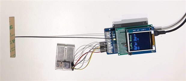

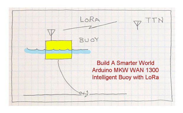

I am prototyping a an Intelligent Buoy (that evolved into a boat) that uses LoRa to communicate with a base station using the Arduino MKR WAN 1300.  This post covers making a more robust prototype board for field testing and the issues encountered.
Daughter Board

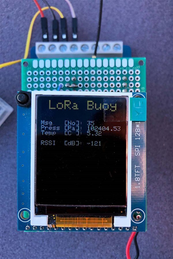

All work up until now has been on breadboards and it is time to make something sturdier that can be used in the field.  For now, only an Invensys ICP-10100 Barometric Pressure and Temperature Sensor is hooked up to the Arduino Relay Shield.
The video below outlines a daughter board which features a 120 x 160 TFT screen as well as some real estate to hook up sensors in the future.  The TFT screen will be used primarily for debugging and testing prior to deployment and is easily removed when desired.

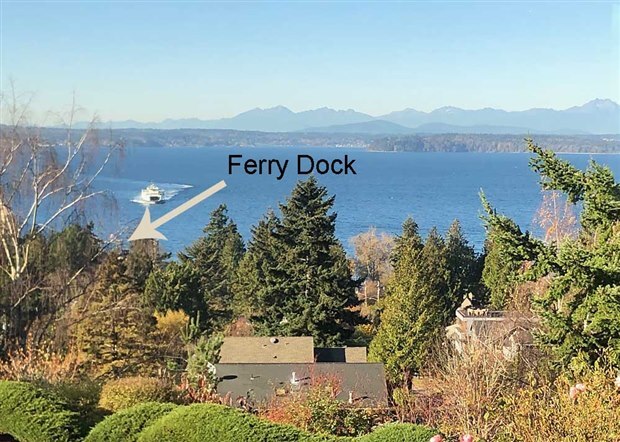

There is a view of the Puget Sound from the deck at the back of my house and the plan is to test the buoy first from a little public beach beside the ferry dock.  It is clear most of the way with some trees and an embankment partially blocking.

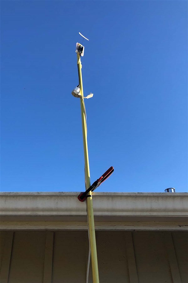

The beach is about a kilometer away as the crow flies.  The MKR WAN 1300 serving as the base unit was hoisted up on a pole and clamped to the house to get the antenna as high as possible and give the clearest view.

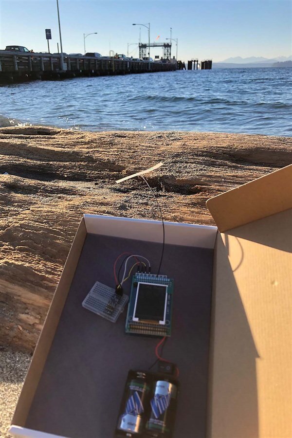

It looks like I need to scrub the gutter :-).  Then I took my battery powered buoy unit down to the beach and leaned it against a log to see what the reception is like.
The limit seems to be around -122 for reliable reception.
Moving my body in front of the antenna was enough to cut off reception.  If I lifted it up to waist height and pointed the antenna towards the house the reception improves to around -118 or so.  I conclude that I can probably do some testing in the area below my house but it is less than ideal.  Maybe a directional antenna for the base station?

    This is a closeup of the antenna I am using:
    The link to the datasheet is here.  The initial reason for ordering these was the low price but I have also found these and will look at trying them next.  Also, will look into your antenna reflector suggestion..

    I'm not an expert in rf stuff, so get a second opinion on anything I say here, but...
    Wouldn't it be better with the dipole vertical? I think the radiation pattern has the highest energy coming off perpendicular to the elements and tapering off as you move round to being on-axis - there's a null along the axis itself. As it stands, at the buoy end of the link you'd lose contact as soon as it turns through 90 degrees and the signal would be quite variable generally as it swung back and forth.
    Other things to maybe think about:
    There's a 'ground effect' with antennas in that if power is launched horizontally close to the ground then there's some absorbtion by the ground - at the bouy end that's an approximation to what's happening [basically, some of the photons that make up the radio waves will be able to 'see' the free electrons in the ground and give up energy to them]. I think you're meant to try and get the antenna at least several wavelengths above the ground and preferably more. (At 900MHz that probably just means a minimum of a metre or so, though the more height the better.)
    When the sea is calm and the surface is flat you'll get a strong reflected wave which will interfere with the direct wave. I'm not sure if there's anything you can do about that, but be aware in your testing that rough conditions may not be the worst case. [To complicate things, that interference can be constructive as well as destructive.]
    That dipole looks short to me for 900MHz. Is it foil on a plastic substrate? If so, you might get slightly better performance from a metal rod dipole. If it's shorter than you'd expect, then the substrate is a mild dielectric (slowing the wave velocity, which is why it can be shorter [good in a confined space], but also absorbing some of the energy [less good if you want the best range]). However, if the transmitter has only been certified with that antenna, then you're probably stuck with it.
    If the house antenna only needs to see the area in front of it, then there might be some benefit in putting a reflector behind it to push more of the energy forwards. (The antenna would then look like an 'H'.)
