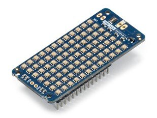

Write messages and add graphics with this shield.
A ready to use library with examples and methods is available for use to easily write static and scrollable text.
You can use this shield to show values from your board and is controllable from the Arduino IoT cloud. No need of solder, or special adapters, just plug the RGB matrix shield on top of your favourite MKR board and you are ready to go!
The mounted LED's are very dense and bright, with full RGB colours!

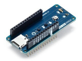

The MKR ENV Shield allows a MKR board to acquire environmental data collected by an array of sensors.
These sensors are of the latest generation and measure:
  • Atmospheric pressure
  • Temperature and humidity
  • Ultraviolet UVA intensity Ultraviolet UVB intensity
  • UV Index (calculated)
  • Light intensity (in LUX)
To help you build projects and store the data collected locally, this shield has a slot for a microSD card (not provided).
There is a ready to use library with examples and methods to read values from the different sensors, that provides an easy and smooth integration path.
Sensors used :
  • ST LPS22HB :  atmospheric pressure
  • ST HTS221HTS221  : temperature and humidity
  • VISHAY TEMT6000 : Lux of the ambient.
  • VISHAY VEML6075VEML6075 : UltraViolet wavelengths  A / B
LEDs84  RGB APA102
Input Voltage5V
Operating Voltage3.3V
Maximum Current2.5A
CommunicationSPI
Length61.5 mm
Width27 mm
Weight32 gr.
ICs
LPS22HB
TEMT6000
VEML6075VEML6075
Input Voltage3.3V
Ranges
Pressure: 260 to 1260 hPa
rH sensitivity: 0.004% rH/LSB
Humidity accuracy: ± 3.5% rH, 20 to +80% rH
UVA, UVB and UVBI measurment
CommunicationI2C/Analog
Length61 mm
Width25 mm
Weight32 gr.

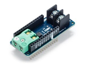

The MKR THERM Shield allows a board of the MKR family to acquire temperatures from a thermocouple of type K and a DS18Bxx digital one wire sensor. The Thermocouple is a kind of temperature sensor that offers high accuracy and a wide range of measured temperatures. Its analog nature requires specific interfacing and this shield relies on the MAX31855 thermocouple digital interface.
The two connectors of the MKR THERM Shield allow the usage of Type K thermocouples with or without a plug attached to the metal wires.
The MKR THERM Shield has its own library to read the temperature measured by the thermocouple
ConnectorsK TYPE  DALLAS DS18S20  (to solder) Screw terminal block
Input Voltage3.3V
Operating Temperature-200°C + 700°C
CommunicationSPI/1Wire
ICMAX31855
Length61 mm
Width25 mm
Weight32 gr.

    Nice additions. I could probably use a MKR THERM shield. Not sure why they put the stackable headers on the ENV shield. I doubt that you would want to obscure the sensors. It would be better if they provided…

    These shields are looking awesome.
    TEMT6000 sensor doesn't give a stable value. You need to take average of multiple values for a stable value but on the other hand digital ALS gives much stable value.
  • mahmood.hassan
    mahmood.hassan over 7 years ago in reply to vimarsh_
    Yeah these two can be used together but If you place RGB shield over ENV shield then you will be blocking light and UV sensors or other way around it will be useless to place RGB shield beneath the ENV shield. Now the only option is to use jumper wires to connect one of these shields image
