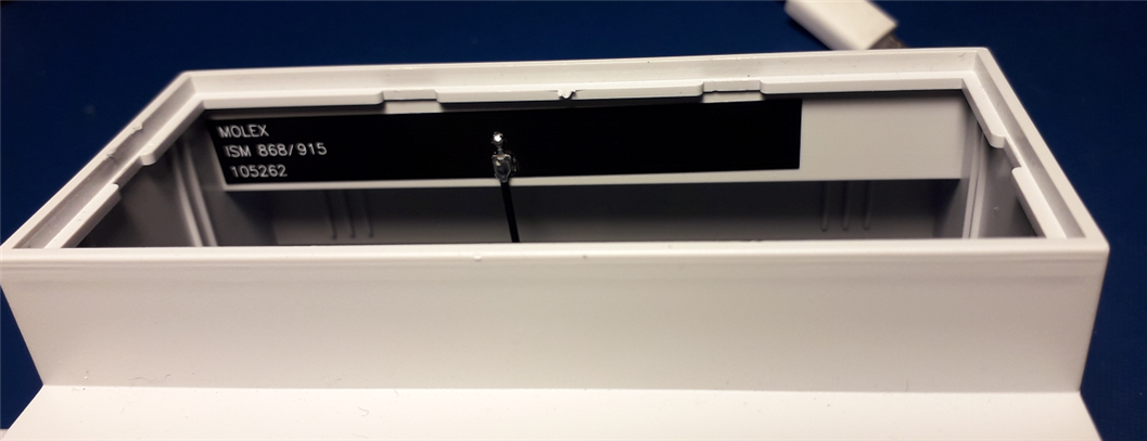

For Arduino Day, belated, a few photos of a project I'm working on.

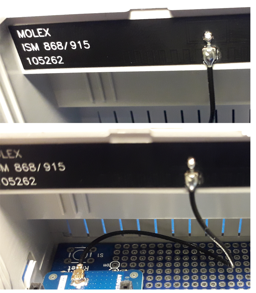

Arduino MKR 1310 LoRa with Ethernet shield and CAN-shield. In a DIN mounted housing and a LoRa range antenna.
It is going to be part of a light industrial test setup.
The housing is Arduino MKR DIN rail housing from e14 member hwhardsoft.
Inside:
Arduino MKR 1310Arduino MKR 1310 for LoRa, with a MOLEX 105262MOLEX 105262 868/915 flex antenna.
Arduino MKR ETH shieldArduino MKR ETH shield
Arduino MKR CAN shieldArduino MKR CAN shield

    In the above photos, I put the sun-1 GHz antenna on the transparent front to make the photo interesting. As you can see, I had just put some tape on the back and taped it to the front panel from the backside…
    As you can see, I had just put some tape on the back and taped it to the front panel from the backside.
    Now I'm working on a real design*, I'm doing it different.
    Use the self-adhesive properties of the antenna: the MOLEX 105262 that I'm using has a 3M adhesive backside.
    Mount it out of sight: the transparent front will be used for status LEDs and a display.
    This will position the antenna horizontal (flat parallel to earth). If you get better reception by placing it vertically, you can glue it on the other side of the corner I taped it to. It fits there too.
