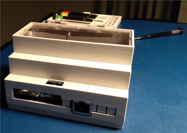

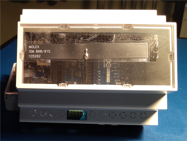

For Arduino Day, belated, a few photos of a project I'm working on.
Arduino MKR 1310 LoRa with Ethernet shield and CAN-shield. In a DIN mounted housing and a LoRa range antenna.
It is going to be part of a light industrial test setup.
The housing is Arduino MKR DIN rail housing from e14 member hwhardsoft.
Inside:
Arduino MKR 1310Arduino MKR 1310 for LoRa, with a MOLEX 105262MOLEX 105262 868/915 flex antenna.
Arduino MKR ETH shieldArduino MKR ETH shield
Arduino MKR CAN shieldArduino MKR CAN shield
This will be one of a few replaceable options.
I also have a TI CC1100 with a rod antenna, put in a smaller DIN housing, that can do sub-1 GHz duty,
an Avnet SmartEdge IIOTConnect that can do CAN, WiFi  and Ethernet,
and a DIN mounted Raspberry Pi that can do Ethernet, Wifi and can be paired with my home-made CAN driver,
Happy Arduino Day
    Jan Cumps over 4 years ago +1
    In the above photos, I put the sun-1 GHz antenna on the transparent front to make the photo interesting. As you can see, I had just put some tape on the back and taped it to the front panel from the backside…
    Jan Cumps over 4 years ago in reply to jc2048
    In the end, I mounted the antenna on the outside, and drilled a hole.
    After some reflection, I prefer this more than adding a vertical DIN rail.
    I've put transparent tape for a little protection - and because the antenna's background only glues perfectly the first time.
    If I really wanted, I'd be able to fit it on the inside, if I'd grind away 2 profiles on the housing's plastic.
