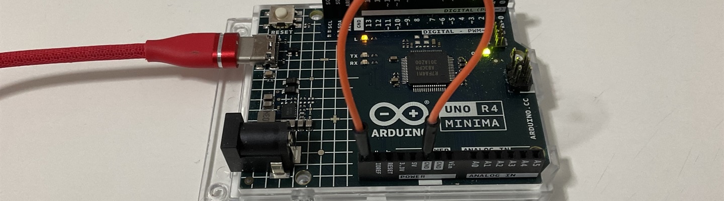

I was then immersed in the training of Path to Programmable III program and had no more free time. This weekend I returned to the Arduino UNO R4 minima to play around for a while, but I couldn't. When I tried to connect the board to the computer, the driver did not load: "Unknown USB Device (Device Descriptor Request Failed)"
Spoiler: The solution to my problem: "Add a while(!Serial){} after Serial.begin(xxx) "

First I tried loading the drivers manually. The same result. Later I explain how to load the drivers manually.
I also changed the cables, both with USB-A host and with USB-C Host but the same thing happened.
Then, discarding the drivers and cables, I went to reload the bootloader. I went to the Renesas website, downloaded the flasher and loaded the latest Arduino bootloader. Below how to load the bootloader again on the Arduino UNO R4 minima. It didn't work either.
Finally I started to think that the Arduino must be sending something through the serial port that was confusing the operating system. So I uploaded a simple BLINK sketch that didn't use the serial port at all.
First I set the the Arduino board to DFU mode (Device Firmware Update). Pressed and released the button marked "RESET" on the Arduino UNO R4 minima board quickly twice. Then the "L" LED started blinking. Then Santiago DFU device is loaded.
Then selected the port of the UNO R4 Minima board from the Tools/Port menu in Arduino IDE and then upload a simple BLINK sketch to the board as usual.
After loading the new sketch the driver is correctly loaded:
So what was the problem. Apparently I left a sketch uploaded in July that used the serial port to print some values.
Can I reproduce the problem again? Yes indeed, just load a sketch that opens the serial port to cause problems again when loading the driver in Windows.
It can be fixed? I think I have found the solution, as simple as waiting in a loop until the serial port is stable.

Step 5 To flash the bootloader:
  • Connect your board.
  • Short the BOOT and GND pin found on the UNO R4 Minima.
Arduino UNO R4 FLASH BOOTLOADER
  • Go to the Connect Settings tab.
  • Select the COM port in the Tool > select the port shown in the IDE.
  • Press start.
Push Reset twice and short BOOT to GND on the Arduino Uno R4 minima board.
