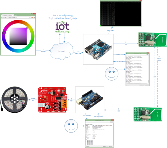

In this episode I will demonstrate and provide all the code used to allow a browser / smartphone / tablet to adjust the colour of a light strip that is connected via an NRF24L01 2.5Ghz wireless link
In a previous episode I showed how to get Mosquitto server, pub and sub clients loaded into the YUN and how to use them
This post is extending on Benjamin Cabé's excellent demonstration and after finding all the scripts and getting the page hosted by the YUN itself I have a working demonstration that looks like the following
I can enter colours from either a subscription to the wheel ("theBreadBoard_Strip") being hosted at iot.elcipse.org or by entering colour selections directly at the YUN or the UNO via their serial terminals
Pay attention to case as the subscriptions are case sensitive
any changes via the wheel is almost instantly relayed to the UNO and subsequently displayed on the light strip,
The UNO is supporting a command interpreter to allow direct commands to be sent to it via any configured input mechanism (Serial or NRF at this time)
The YUN is supporting a simpler command structure at this time and simply relays the commands it receives onto the UNO via the NRF radio
A point to note is the YUN does not support the standard output pins for SPI, namely the MISO, MOSI and SCK lines do not exist on pins 11, 12, 13 and are only accessible via the programming header and the Infineon Shield needs stacking headers if your to add additional IO devices like a NRF24L01

on the YUN you need to create a folder and sub folder in the root of a micro SD card "/arduino/www", once loaded into the YUN it immediately shows up at this location under the LINUX "/mnt/sda1/arduino/www" and a simpler path "/www/sd", from the home network it can be accessed as "http://arduino.local/sd/", it will automatically serve index.html
