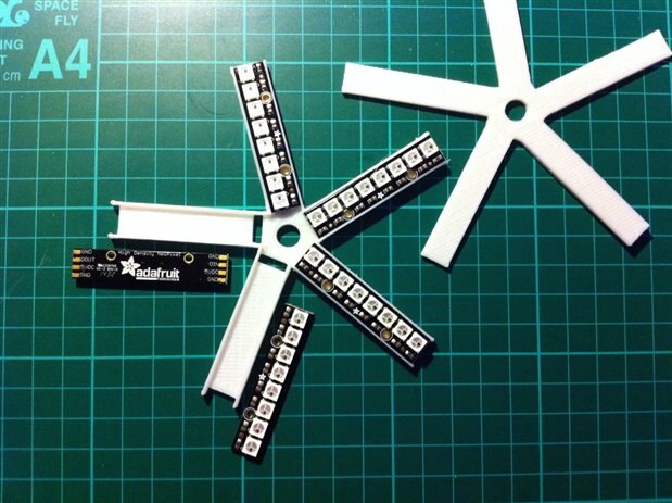

I originally intended to use an LED strip, which I would cut into pieces and place in a star shape, but I then came across the NeoPixel Sticks from Adafruit.
One stick has eight LEDs which are placed very close to each other. They seemed perfect for the job.
Based on some measurements, I created a simple 3D printed star to test the positioning of the sticks. You'll notice the different branches are a bit off center. That is to compensate for the fact that the pixels themselves are not centered on the stick either.
After that, I modified the star to be able to clip the sticks on and pass the wires for power and data.

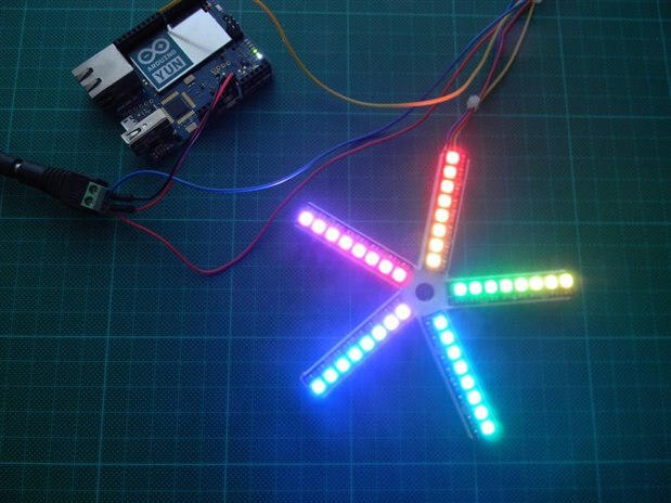

With the holder tested and fitting, I soldered the connections between the sticks, resulting in one strip consisting of five sticks.
To test the construction, I loaded the default "strandtest" sketch from the NeoPixel library and configured the proper number of pixels.

    Thanks DAB,
    it would've been a rather strange looking star without the offset.
    But that's the great thing about 3D printing: quick iterations.

    DAB over 11 years ago
    Nice design.
    I quickly saw the offset and realized how you set up the star to get the pixels aligned.
    Nice touch.
