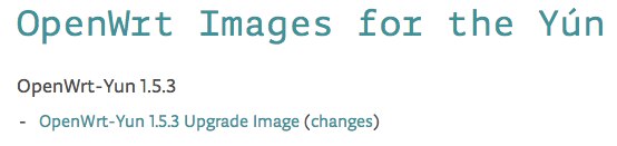

OpenWrt
When scrolling further down the page, to the "other software" paragraph, there is another piece of software relevant for the Yun: an updated openWrt image.
OpenWrt is a linux distribution for embedded devices. If you want to learn more about OpenWrt, go to https://openwrt.org/.
The OpenWrt image for the Yun can be installed in two ways:
  • using the web interface
  • using the command line interface (via SSH)
You can find both procedures described in detail here: Arduino - YunSysupgrade
There are two ways to connect to the Yun:
  • connect an ethernet cable to the Yun and have it receive an IP address via DHCP
  • connect to the Yun wifi access point
Once connected via either way, you should be able to access http://arduino.local/
The following page should appear:
The password is not mentioned in the procedure. I first tried to log in without entering any password, but that was refused. Next, I tried "arduino" and I was in. Lucky guess I suppose image
I pressed the big "RESET" button at the bottom of the page and waited for approximately 3 minutes for the upgrade to finish.
Once the onboard WLAN LED stopped blinking, I tried to connect to the Yun via the wired network. Unfortunately, that wasn't working, so I connected to the Yun's access point instead.
On the web interface, it reported the wired network was disconnected. I removed the ethernet cable and plugged it back in. The Yun then reported it was connected to the wired network. Strange ...
But, the Yun is now ready to go!
