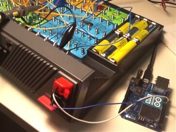

"Can I make the Yún shout out the names of my friends on element14?".
Turns out that I can (barely - I've stretched the memory of my Yún beyond believe).
Here's the article that got me on the rails: Is it possible to make Arduino talk without shield

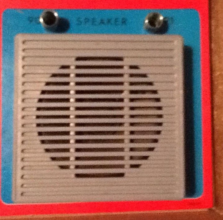

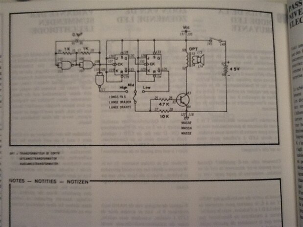

My eldest daughter made an amplifier on the Science Fair 200 in One LAB (she isolated the amplifier part out of project 180 - octave generator)
while I was struggling to get the TSS library work on Ardiuino IDE 1.5.x and fitted it in the memory together with the MQTT lib.
She finished well before me.
Here's the result. You can hear the kit saying my name once, and Robert Peter Oakes' name twice:
The video is a real capture of messages arriving. The speech you hear are real messages posted to the Eclipse IoT broker by fellow element14 members.
