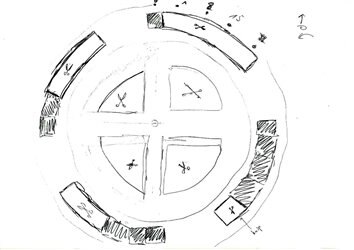

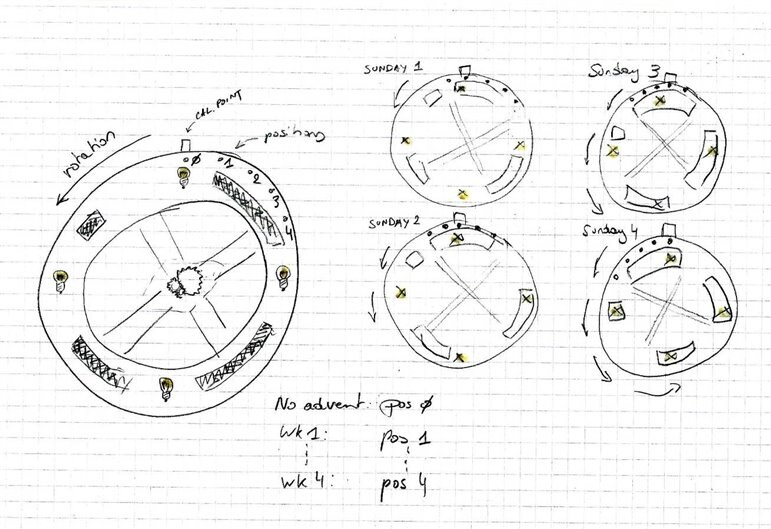

...  my entry is an electro-mechanical wreath.
The wreath is a combination of mechanics, electronics and internet connectivity.

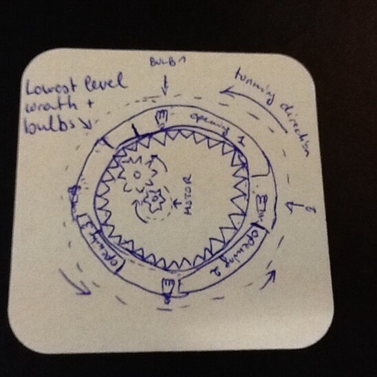

For each advent week, there will be a light. above the light is a filter that hides all four lights initialy, and will reveal a light each Sunday, 'candle wreath style'.
Microcontrollers are used to motor-drive the optical filter. The internet will be used 'IoT compliant', to check what date it is, and reveal the correct number of lights based on that.
The wreath will work every year without user input. Plug it in and it will adjust itself to the right state of advent.
My aim is to give this either a K'Nex or steampunk look and feel.
In fact I don't know anything about te design yet. It's just an idea at this moment.
You'll find out together with me how it materializes.
At that time, I really didn't know much. As it turned out, the only thing I've left from the original idea was the dumb lights and motorized filter.

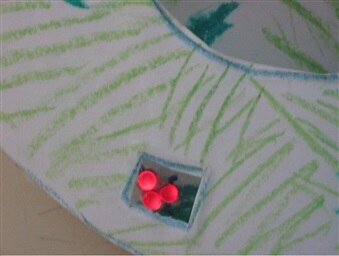

What did I come up with?
I like to challenge the nature of the exercise.

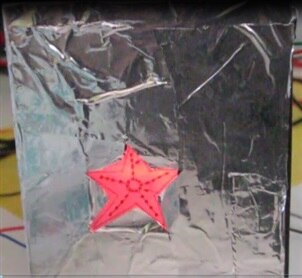

The focus was on lights. I came up with the idea to make the lights an intrinsic part of the design - but a downplayed part.
It would have been obvious to switch on one light for each Sunday in the advent.
I inverted that thought process: what if the lights are static, but something else makes them go on and off.
The mechanically driven optical filter does that  job.

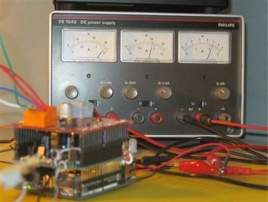

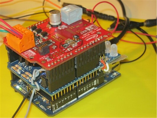

The Infineon RGB shield can handle high power leds easily. So I used it to drive standard low power leds.
It's perfectly capable of doing that, but you're playing at the very low edge of its range. It's a tricky balance because you can easier overdrive standard leds than the sturdy high power ones.
The shield did an excellent job. Even though I did not put advent intelligence in the lights, I did animate them.
Robert Peter Oakes's (I bet he'll be mentioned by some other participants too image) Infineon library was instrumental for a painless exercise.

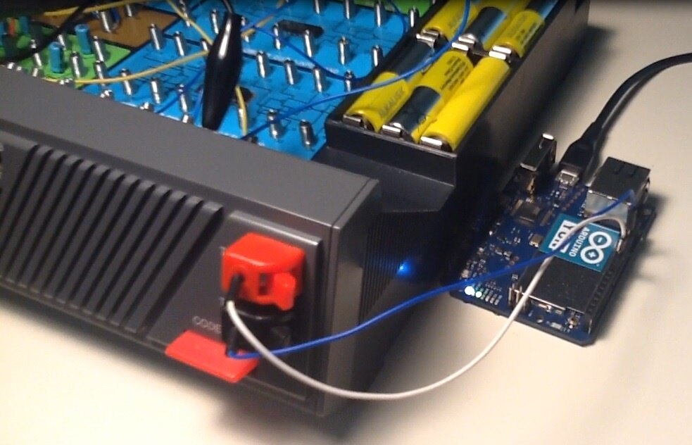

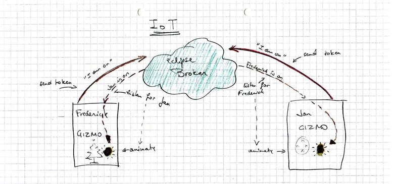

The Eclipse IoT. What's the use of the internet of things if you only talk to yourself?
fvan and I have our gizmos connected to each other.
Our devices act differently when we're both on-line. How novel is that?
Frederick's gizmoJan's gizmo
We think we've used the internet as it's supposed to be used. To interact with others.
And we've used it as 'things'. There's no human interaction. Both things are happy when the counterpart is live, and they show it!

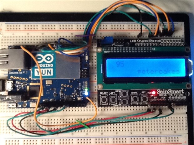

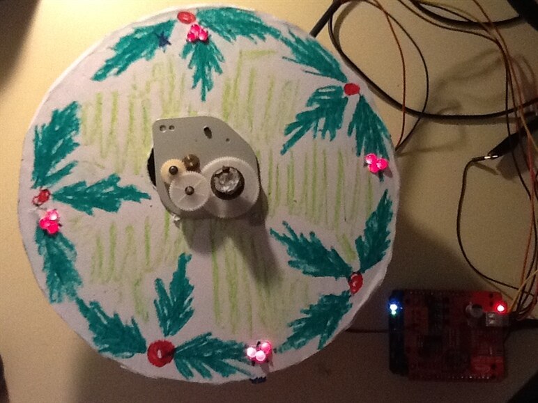

The Arduinos. The Yún drives the whole thing. It's filled up with more than 90%. It has a very down-to-earth duty.
The UNO is doing a more creative job. I've given it as a present to one of my kids that helped me build the wreath.

  • I was going to use the internet to get the current date. I'm a novice to IoT - this is my first experience - and thought that it was all about using on-line services and functionality.
When I was setting up the Yún, I found out it has linux running - and has time sync functionality.
So I changed my mind, stepped away from searching for an on-line time service, and used that linux part to get at the right date - with localization support.
  • That also meant that I had to come up with something else for the IoT part. The work with Frederick more than filled that gap. It was a blast working together - you get the warm fuzzy when the gizmo lights up when you're not paying attention.

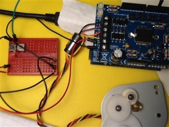

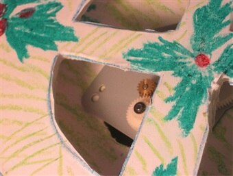

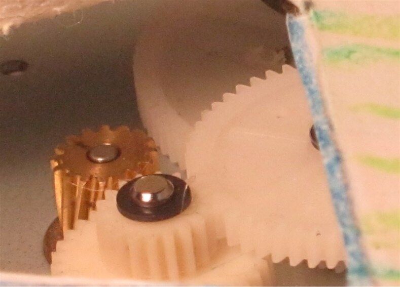

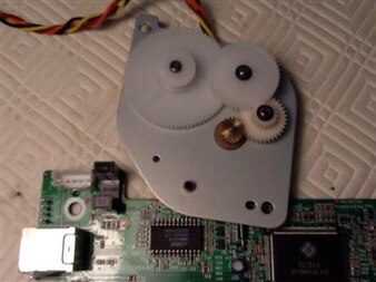

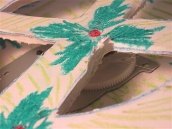

  • The mechanical part went through several changes.
I started with a light dc motor, but that was a bit hard to control. I didn't have many options to provide position feedback - let alone brake the fast but weak motor. Ditched it.
Idea two was a servo motor that I have lying around. It does the job better, but it was looking dull. I wanted gears and shiny copper.
In came the final solution: a stepper motor from a defunct flatbed scanner.
I struggled somewhat with driving the motor - and wrote about that in the blogs listed at the bottom of the blog. It turned out to be a perfect solution.
As an added bonus, the stepper does not run very smooth. That adds to the look and feel of my design.
From the start, I wanted it to look scabby. I'm quite pleased with how it behaves:

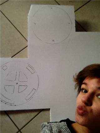

  • I was going to build it alone. One of my kids came to the rescue when I was about to cut off my fingers during the arts&crafts part.
That may have been the part that I enjoyed most.

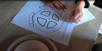

In my second post I made a paper prototype.

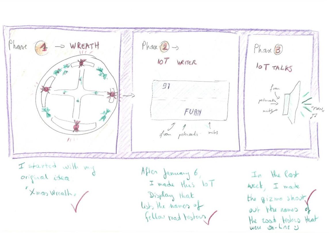

Post-Christmas design: [Christmas Wreath of Things] Internet of Holiday Lights : post Christmas blues
And the bonus kicker: [Christmas Wreath of Things] Internet of Holiday Lights - Bonus kicker: the IoT talks (a spoken tribute to Science Fair kits)

The Internet of Things shouts out the names of my fellow road testers:
A playlist of 11 videos I've uploaded during the work. Some made it to the blog posts.
