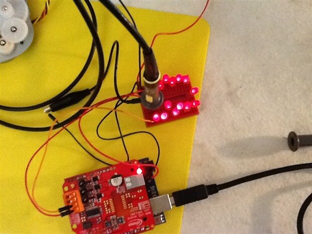

I am now adding the Infineon LED shield to the design. That finishes off the electronics part of my design.

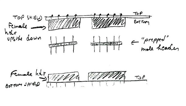

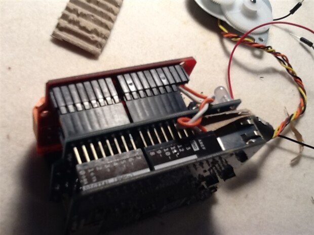

I didn't have stacking headers available. And normal mail headers do not leave enough spece between the shields. Using them would very likely create short circuits or other mishaps.
I decided to take another approach. I soldered female headers upside down on the bottom side of the Infineon shield, and used prepped' male headers to match the female headers of the two chields.
'Prepped' means that I forced the plastic part of the male headers to the center of the pins, so that there's enough pin left on both sides to make contacts with the female headers:

I've also tested the two most hardware dependent parts in combination: the stepper motor shield and the Infineon RGB driver shield. That worked out ok.

    DAB over 11 years ago
    I like it.
    A simple engineering fix.
    mcb1 over 11 years ago
    Thats certainly a novel but practical approach to the shield pin height issue.
