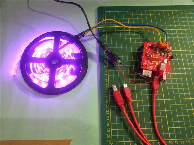

My project for the Internet of Holoday lights was based around our living room which was not very livable. It was a mess and with the upcoming holidays I wanted to set the living room in such a way that it would be suitable for entertaining guests. Additionally I wanted to accomplish the above mentioned in such a way that the holiday lighting becomes part of the living room and I don't need to remove it after the holidays. Hence the concept of Dynamic Living-room Lighting.
In the previous posts, I have review the YUN and the infineon shield and have presented an overview of the project system. I also setup the place for the lighting with some homemade arts and crafts.
In this post, I will explain the control of the RGB LED strips attached to the arduino YUN and connected to an instance of OpenHAB. This instance of OpenHAB is running a raspberry Pi and an MQTT broker.

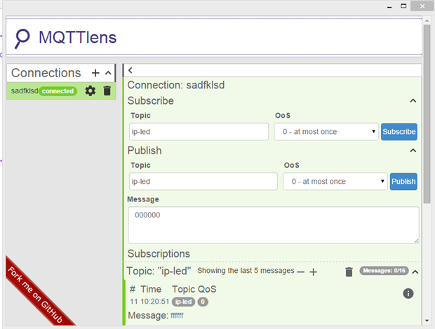

You will also need a program to test MQTT off the bat. I choose MQTT Lens which is a Google Chrome Addon. Point it towards the MQTT Broker and you should be done.
The screenshot above shows how to control the YUN with the code supplied by Benjamine Cabe as is. Just send RGB values and you are good. If you send 000000 then the LEDs switch off and if you send ffffff then the LEDs turn on full brightness hence the white color.
Now you should be able to see the results almost instantaneously and if you don't try and see if the YUN is connected to the internet or not. The serial monitor can help you debug that.

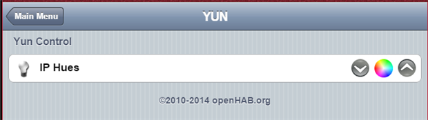

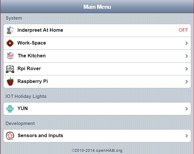

The second thing we need to do is make it a part of the UI. You can see there is a segment in the above screenshot for the IOT Holiday Lights and is labeled YUN. To make that, we use the following code.
sitemap demo label= "Main Menu"
// All my other stuff//
// IOT Holiday Lights Frame
Frame label= "IOT Holiday Lights"{
            Text label= "YUN" icon= "yun "{
                  Frame label= "Yun Control"{
                        Colorpicker item= Hue icon="slider"
I downloaded the icon from the net and put it in the OpenHAB/webapps/images/yun.png . The resulting sub frame is shown below.

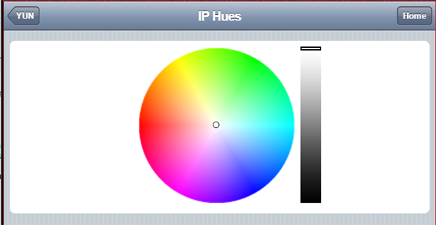

So now we have a color wheel. Brilliant!
The Third step is creating rules to connect the Color Wheel to the MQTT topic via the String. This is where all the fun stuff happens and for my instance my code is given below.
