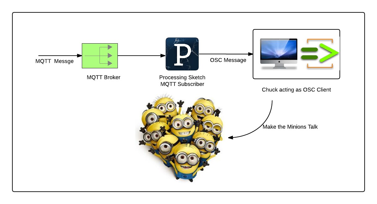

Now here is how my part of it works.
For now i am creating the MQTT message through mosquitto_pub which i described in an earlier post. Once i get my shipment of components, my wireless controllers will generate the message. Actually i am going to add capacitive touch to the minion christmas ornaments  and when any one touches the ornaments a MQTT message will be sent out resulting in Chuck generating the sound. (Update Dec 20.. Built it.. See here.. ).. Oops..I forgot.. Robert Peter Oakes got those minions. Now i have to go shopping for some minions.. image Unless Santa doctorcdf has surprised us with some minion ornaments in our package.

MQTT Subscriber and OSC Message Sender
In Part 2.1 i described how i set up MQTT client libraries in Processing. Here, i created the following MQTT Subscriber for listening for those messages. Once the messages are received, I translate them to generate Open Sound Control (OSC) messages to pass them to Chuck.
