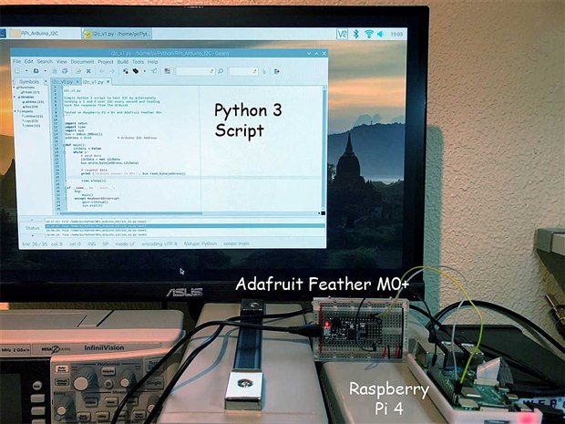

The components required are a Raspberry Pi and a microcontroller that can use the Arduino Wire library.  In this demonstration a Raspberry Pi 4 and an Adafruit Feather M0+ are used but many others would work as well.  In the photo below the Raspberry Pi 4 is bottom right and the script can be seen running in the Geany IDE on the display.  The Feather is between the display and Raspberry Pi and when will blink the onboard red LED when directed to do so..

The Python 3 script below alternately sends a 0 and 1 to the Feather once per second over I2C and then requests the Feather to ping it back.  Be careful when connecting SDC, SCL, and GND to the Raspberry Pi as they are not marked on the board and it would not be difficult to inadvertently connect 5V to a 3V board like the Feather.
