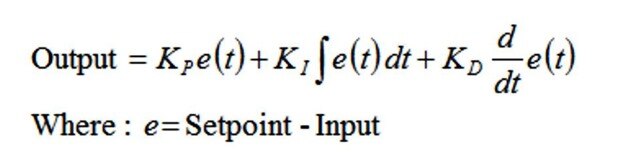

PID Control
PID control continuously evaluates the error between a setpoint and the variable being controlled and applies a correction based on proportional, integral, and derivative terms.  The control loop looks like this for our brushed motors (the derivative term is crossed out since it won't be used here but some explanation is provided):
The user provided set point is the speed of the motor.  The output speed of the motor from the encoder is compared to the setpoint and fed to the controller.  The controller uses the PID control algorithm to determine a new output (PWM) if needed to reduce the error and a new output from the encoder starts the loop over again.
This is what the PID equation looks like:
If you haven't used calculus in a while, don't worry.  It's not that bad.  In simplified form it turns into this when written as a C algorithm

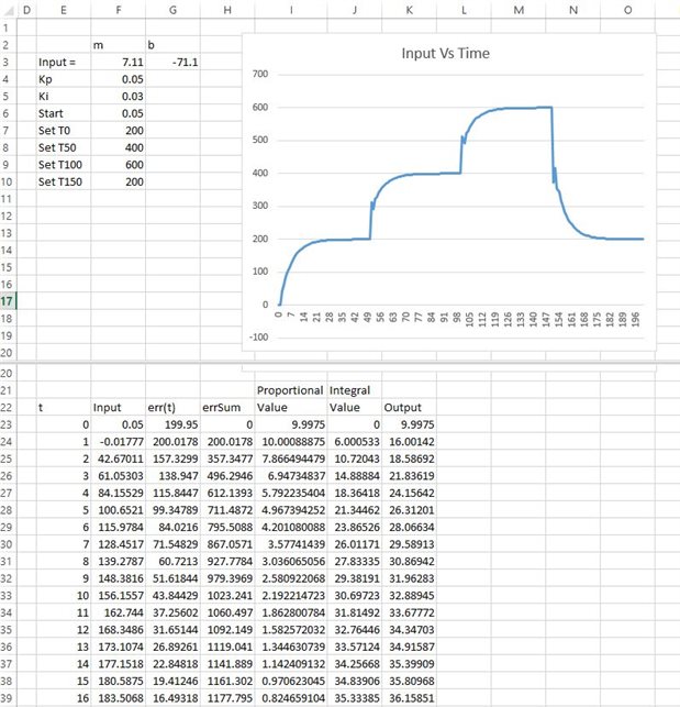

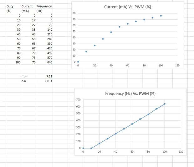

System Model
Process control has advanced tremendously in recent years and it is possible to develop sophisticated computer models for steady state and transient behavior of very complicated systems.  See for example this video demonstrating PID development for a motor using MATLAB and Simulink.  Unfortunately I no longer have an active account but I thought I would try developing a simple model and estimate the tuning factors with a spreadsheet.  All done with no idea of whether it would work of course...
Voltage, current, and frequency of the encoder output from one of the motors was recorded as PWM was increased:
This looks promising, the frequency of the encoder output is very linear after 20% duty cycle is obtained with the power supply set at 6V. The linear equation for the frequency is:
frequency = 7.11 * duty cycle - 71.1
At this point it should be noted that this is an unloaded motor unlike the eventual robot.  The rough assumption is that friction, inertia, inductance, back EMF, and so are all captured adequately in a single line.  Time is not handled properly and the PID equation is pretty "how ya doin'" but here we go...
Remember that the derivative term is not being used.   For the model we start at time 0 and the motor starts up.  The error and error sums are calculated.   From this we get the proportional and integral terms and add them together.  This is then the output.  The output is plugged into the motor model and this gives the new input.  We then go to the next time interval.
After about 50 time intervals when everything has smoothed out a change is made to see whether it is stable in another range.  Then two more changes are made at 100 time intervals and 150 time intervals.  I fooled with the terms quite a bit and found they were fairly sensitive.  It was quite easy to make the system unstable.  The final "tuned" parameters from this crude model were:
     Kp = 0.05
     Ki = 0.03
As will be seen shortly, these parameters were stable in the actual system and allowed me to tune it further fairly quickly.

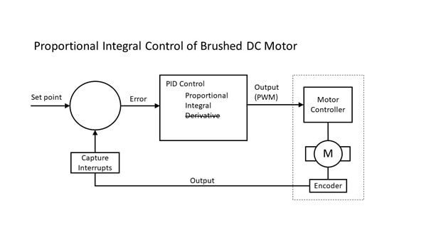

PI Controller
The PI Controller uses the same Adafruit M4 Feather Express and setup as the previous post. The main addition is the PID Library.  Here is the code:

The PID Library is this one and appears to be quite good.  Documentation is excellent extraordinary.
The input from the encoders is captured in interrupts.  I found that I needed to capture a number of interrupts over a period of time to get an accurate frequency and settled on 20.  The PID controller is updated every 100 milliseconds.  This may not be optimal and needs reexamination.  Good practice would be to reduce time in the ISR by getting rid of the floats and division.
Only one channel of the encoders is being captured on the rising edge - this is partially because 2 of the pins did not seem to work with the interrupts although the Adafruit documentation implied that they should.  It may be possible to move things around and get this working on both channels, both rising and falling, which would increase resolution.  Debounce was not implemented and no problems were noticed but this should also be examined further.
Using the library is straightforward and the author explains it much better than I can.

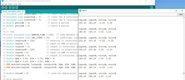

System Test
The test setup is the same as the last blog.  As noted above the tuning parameters developed with my simple model worked right away.  I will assume this wasn't dumb luck but my knowledge and skillful application of motor systems and use of numerical methods.  It was noticed that the motors were ramping up slowly so Kp and Ki were incrementally increased until the system became unstable and then backed off.  The values in the code above may not be optimal but seem to be in the ballpark and a good start.
As can be seen in the screenshot below, the errors when running at low speeds in particular are minimal.
Error from the setpoint of the two motors is shown to the right.  The error is centered and for the most part less than one percent on each reading.
In the following test the motors are started from a dead stop and accelerate to a setpoint of approximately 25% of full speed.
And in this next test the motors are shown operating at approximately 100% of full speed.
The error is quite acceptable for my use but I expect it could be improved somewhat with the use of PWM with more resolution.  I also expect the ramp up and down of speed could be improved through further tuning (probably at the expense of some over / undershoot) but is acceptable for my use.

    Hello Gavin and thanks for you interest.
    I am being sloppy here and haven't defined terms and how I am using them.  There are a couple of rotational speeds and the relationship to the encoder is proportional but it does not directly measure RPM or frequency.  The complicating issues include these:
    • The encoder has 4 magnets that are being sensed so a polarity change is sensed more than once per rotation
    • There is a gear box so the rotational speed of the motor shaft is not the same as the output shaft
    These complications are ignored for the moment and the polarity change for a cycle as a magnet passes the hall sensor is used to calculate the frequency.  In the robot described the real interest will probably be how far each motor causes a wheel  to travel.  This could be calculated based on wheel diameter and the two matters above or simply measured once the robot is built.
    Returning to frequency, the definition of the Hertz is "cycles per second".  In the function initEncoders() interrupt service routines (ISRs) are set up to be called when the encoders output a rising edge - i.e. whenever a cycle is completed.  Again, note that this is not the rotational speed of the gear box output but the rising edge from a magnet passing.  After INT_COUNT interrupts occur (20 as defined at the beginning is arbitrary - it was deemed a sufficient number to do a calculation as noted in the write-up) the frequency is calculated.  All that is needed now is to divide the interrupt count by the amount of time that has elapsed in seconds.  The variables nowTime and startTimeX are in milliseconds and the difference in the two is the amount of time elapsed in milliseconds.  To get seconds division by 1000 is required and the 1000 factor shows up on top when inverted.
    Since the oscilloscope is showing the same frequency as the output from the microcontroller to the monitor we can be reasonably sure my math is correct - at least this one time :-)
    Frank
