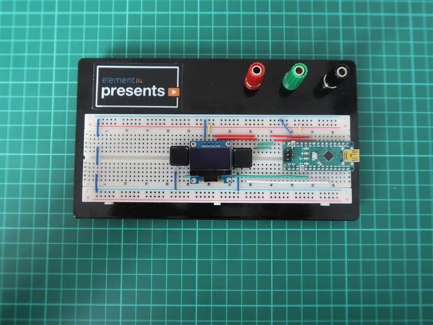

The U8g2 library for monochrome LCDs contains nice example with game called: SpaceTrash. Below there is source code of this example:

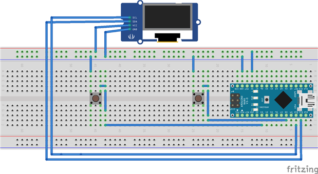

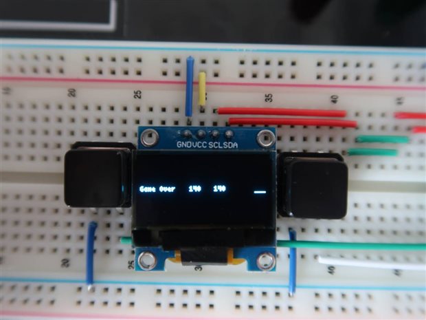

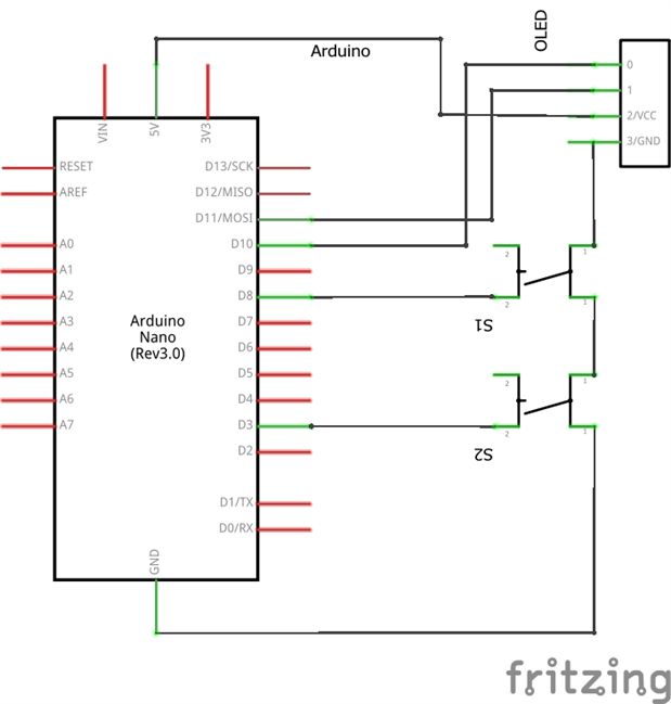

I have used an 1.3" OLED screen and two buttons to test this example with Arduino Nano. Below there is information about connections on breadboard and schematic:
Here is video from first run:
