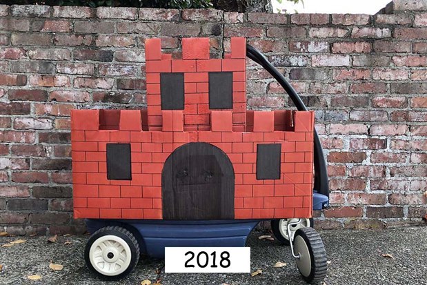

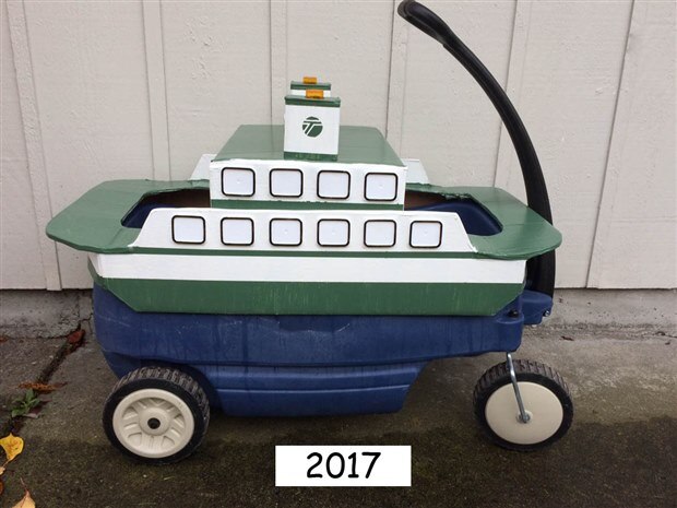

For the last few years their representative has wanted me to outfit a wagon to pull the youngest child in.  The first year it was a Washington State Ferry since they lived in Seattle.  That was the year I made my granddaughter a "ferry princess".   Last year the customers all wanted to dress up as characters from the Mario games and I made a castle like the one that Princess Peach lives in.  And this year it is the Steel Bridge in Portland since that is where the customers now live...

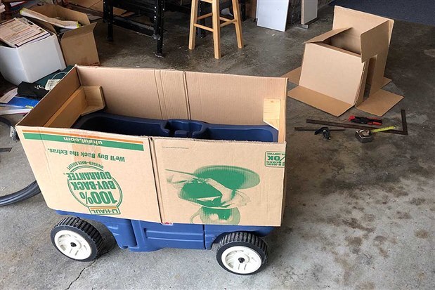

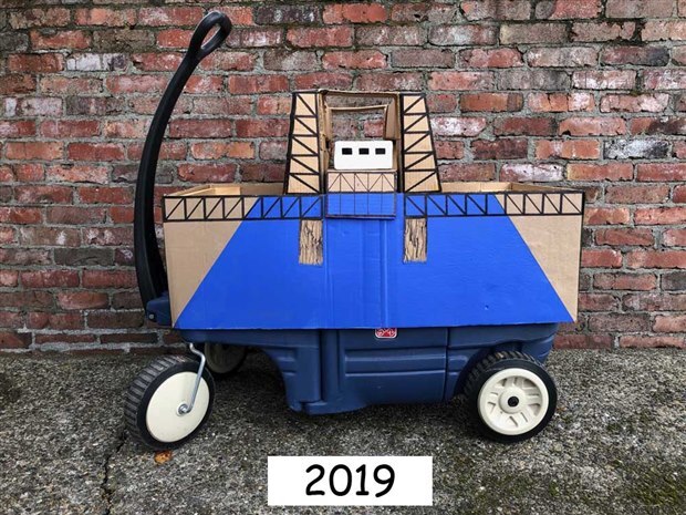

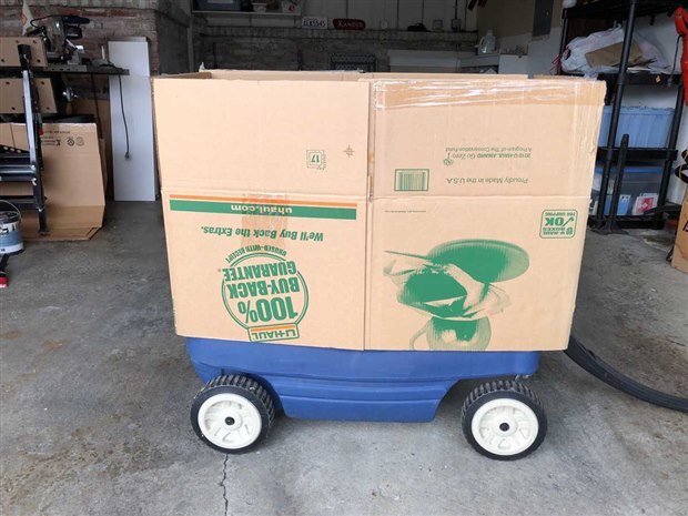

How to Build a Bridge on a Wagon
These projects always start with a large moving box and the wagon.  The box doesn't really fit so it is cut down and reassembled until it is a fairly snug fit.

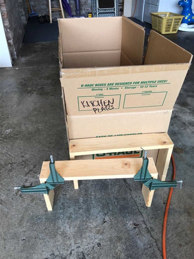

To give additional rigidity and keep the box from moving on the wagon wooden bracing is fabricated and glued to the ends of the box.
In the photo below the bracing has been installed and the smaller box behind it is being cut up to form the lift section.

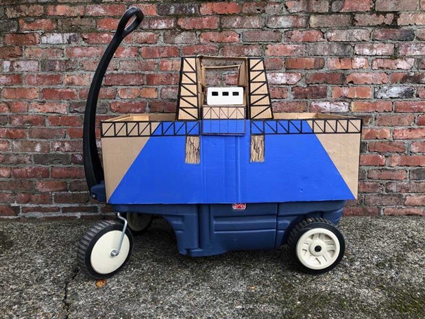

For various reasons there was less time than normal this year and not a lot of planning or finesse.  For the better builds I normally buy heavy colored paper and apply it to the carboard boxes and then use a sealer over that to make it somewhat waterproof.  No time for that this year.  I pasted paper from paper grocery bags over a few spots and painted the rest with acrylic paint.  The photo below shows the carboard complete and mostly painted.
The portion of the bridge that lifts and the machinery house can be seen to straddle the main body and obviously a lift mechanism is required.  Rather than wire cable and a pulley arrangement I settled for something a bit easier.

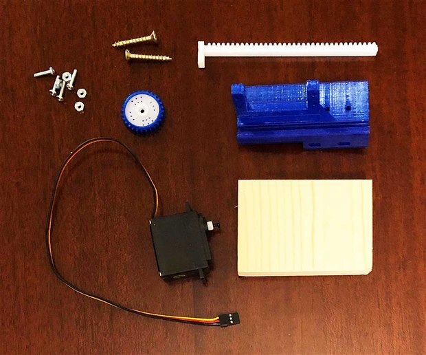

The Lifting Mechanism

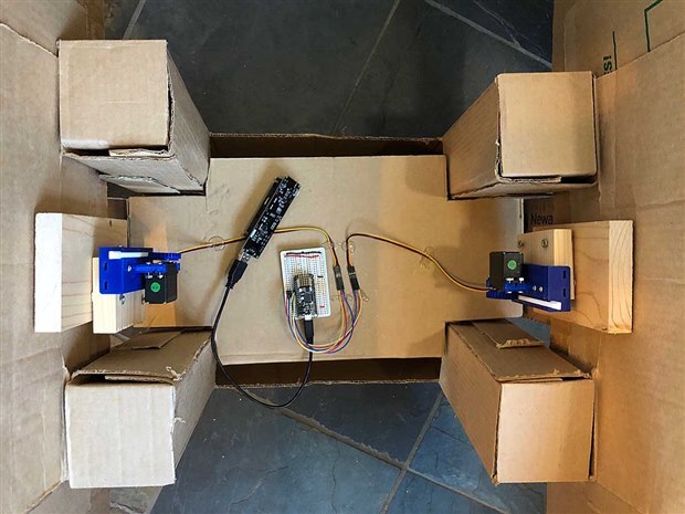

I found a really nice 3D printed linear servo actuator on Thingiverse that looked like it would do the trick (thanks potentprintables).  The 3D printed pieces are the rack which is printed in white below, the pinion which is printed in blue and surrounding the circular horn in the photo, and the large blue body.  The servo is a Hitec HS-311 with the potentiometer still active.  The completed mechanism is attached to the bridge body with a block of wood.  Two actuators are required, one on each side.

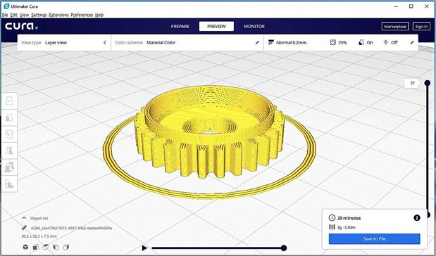

As is often the case, the design had to be modified slightly before use.  My circular horns did not fit in the pinion gear so the opening was enlarged in Fusion 360.  A hole was also placed in the center so that the pinion could be removed and replaced at will.  In the original design the pinion gear is permanently mounted which means the servo cannot be easily used for anything else.  A view in the Cura Slicer is shown below.
It was also necessary to modify the rack slightly since tolerances were off for my Anycubic I3 Mega printer and the fit was too snug.  To fix this the rack was aligned along the X axis and then the Y axis was scaled smaller.  After hitting it with some sandpaper and adding some petroleum jelly it slid smoothly as seen in the video.
The servos are controlled by an Adafruit M0 Express Feather development board.  Power comes from a 18650 rechargeable battery in a carrier that also boosts to 5V for USB power to the Feather.  It also powers the two servos.  In the photo below testing and alignment is being done prior to completing the build.
To stop the lift portion of the bridge from binding small scraps of wood were glued to the racks for the lift to rest on.  Holes were then punched into the cardboard and a compartment made so that the development board and  battery were out of the way of little hands.
The circuit and code to lift the bridge up and down are very simple.  It was written in the Arduino IDE and lifts the bridge slowly then holds it for several seconds.  It then lowers the bridge, waits a while, and starts all over again.  Power goes from the 3V output of the 18650 to the servos.  The Arduino servo library is used in a manner very similar to the example code provided in the servo library. The pins used by the Feather M0 Express to drive the servos is documented in the code below.
