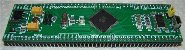

My Issue:
Needing an Arduino that is both small in size and “portable”, meaning that it can be used in several different projects.
The Arduino Mini-Pro (to name a few) answers this issue on a smaller scale but I was looking for something in the 2560 size so I developed my own.
My Solution:
The MEGA_Stick
The MEGA_Stick allows me to simply unplug the system from one project and plug it into another.
Two unique things about the MEGA_Stick; all 100 pins are available to the user allowing advanced programmers to utilize the full capacity
of the ATMEGA 2560 chip and the addition of a on board battery backed up Real Time Clock.
This can be turned on or off via a solder jumper (note picture is missing the 2 pull ups).
This might be old news to some, but while developing this board I found that Digi pins 45 and 46 can also be used as PWM pins.
Pin 44 should be one as well but it is not yet in the Arduino boot loader.

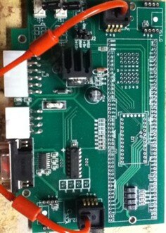

Currently I use the MEGA_Stick for my Phoenix Monitor System, which monitors the fluid levels of up to 4 different tanks.
As you can see in the picture I have the main board with a dual footprint. This board can use the Pro-Mini, or my MEGA_Stick,
depending on the features requested like Automatic water fill, Bay heating, or controlling other outside devices. The info can then be
displayed on a veriety of medium. There is lots of room for expanding on this system. Note that the female headers aren’t soldered in yet.

For my use the MEGA_Stick simply makes the Arduino MEGA more portable as well as a more permanent solution in one package.
The biggest issue right now is the cost to build considering the prices of the ATMEGA chip in low quantity.
2/21/2012 UPDATE
The MEGA Stick is no longer in production and is being replaced with the even smaller MEGA STICK II
The board measures 1"x2.5" and is better suited for embedded applications. The FTDI and RTC is now off board making it a bit more affordable to replace if something goes wrong.
It will also require a regulated 5v supply as the the regulator has also been removed.

  • R_Phoenix
    R_Phoenix over 14 years ago in reply to billabott
    The intent is to be able to replace the ATMega2560 in the event it gets fried, or I can also send the client a new "chip" as an upgrade. So for field reparability I want it easy to remove and re-insert. Also, there is no socket for the 100 pin 2560 that I know of.
    Another intension is so I can switch processor types if need be. For example if i switch to an mbed, I an simply build a carrier board to go between the main and the mbed to utilize the same female headers on the main board and not need to redesign the main, or throw out any unused boards.
    I believe in "repair and return" instead of "throw-away and replace" so I make my designs as versatile as possible. Also in case your wondering, the larger boad above is before the female headers were solder in to recieve the MegaStick. At that time I was still using the Arduino Pro, U2, the smaller footprint and again, before the female headers were in place.
    By the way, I also believe that there are no dumb questions.... image
    Thanks for asking!
