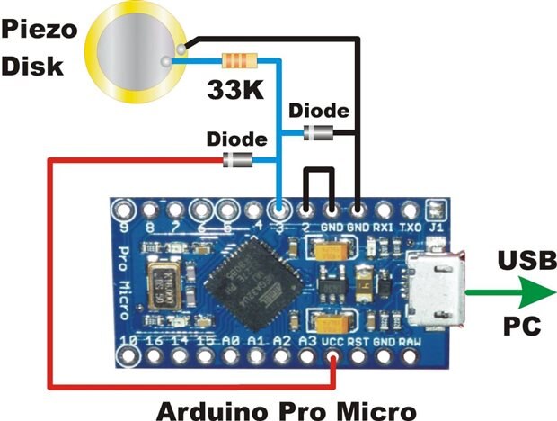

Okay but we want to use it as a sensor for an arduino and 100 volts will damage our arduino so we need to prevent such high voltages from reaching the MCU.
Here I am using a 33Kohm resistor to limit the current and clamping diodes to prevent the signal from exceeding the power supply. One diode prevents the signal from going negative and the other diode prevents the signal from exceeding 5 volts.
Okay, enough about the sensor for now, lets talk about the arduino.
This is an arduino Pro Micro which is software compatible with an arduino leonardo but I like this smaller Pro Micro form factor. The CPU of the Pro Micro or Leonardo has a built-in USB port that we are going to program to emulate a USB mouse. In particular when pin 3 goes low, the ardino will be programmed to initiate a left mouse button click. A short sketch to do this is published at the end of the article.
To hook up the sensor, we connect the signal to pin 3, the sensor ground to a GND pin and the clamp diode to the VCC pin.
Now if I plug the arduino into a PC using a USB cable, the arduino will automatically get enumerated as a standard human interface device (HID) of the mouse variety.
When the sensor is disturbed the arduino will flash its green LED and generate a left mouse click.

arduino mouse clicker sketch
Mouse Clicker Sketch
by Doug Wong   2014
pulling pin 3 low triggers a left mouse click
pin 2 enables mouse mode
void setup()
  pinMode(2, INPUT);        // input to put device into mouse mode
  digitalWrite(2,HIGH); // set an internal pullup so the input is normall high
  pinMode(3, INPUT);        // input to detect sensor activity
  digitalWrite(3,HIGH); // set internal pullup so input is normally high
  pinMode(13, OUTPUT);      // set pin to be an output so it controls the LED
  digitalWrite(13, LOW);    // set the LED off
void loop()
  if(digitalRead(2) == LOW) // if pin 2 is low then start mouse mode
    Mouse.begin(); // start mouse mode
    if(digitalRead(3) == LOW) // if sensor input is low generate mouse click
      Mouse.click();                 // send left mouse click to PC
      digitalWrite(13, HIGH); // set the LED on
      delay(100);                     // wait .1 second before turning LED off
      delay(1000); // wait a second before looking for more sensor activity
  else                      // if pin 2 is high end mouse mode
    Mouse.end();            // end mouse mode
