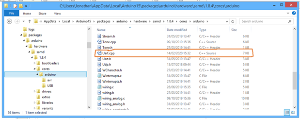

    I have tried what you have done and I do not get the same result. Can I ask what file you are modifying? More specifically where did you find "void Uart::IrqHandler()"? I have looked under all files where the Arduino libraries are stored and the only place I find this is under "C:\Users\Kas\AppData\Local\Arduino15\packages\arduino\hardware\samd\1.8.4\cores\arduino", Is there a different location I should be looking at?
    Thanks
    Kas
  • jc2048
    jc2048 over 6 years ago in reply to kas.lewis
    Hi Kas,
    This was the file I was changing.
