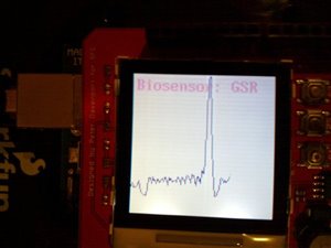

For the Great Global Hackerspace Challenge, my hackerspace, Pumping Station: One in Chicago, built an Arduino-based biosensor array.  In our latest blog post, I wrote about the sensor I worked on: galvanic skin response (GSR)
GSR graphed on SparkFun LCD shield
I thought fellow members of the Arduino group here may find our project interesting.  Anyone else working on any similar projects?
