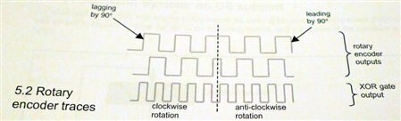

My code currently is reading the falling edge of a rotary encoder and works good but how do I include the rising edge aslo in the code to improve accuracy?
Could you give me an idea on how to include the rising edge in my code? Thanks,
Here is the Encoder part of the code

    Any help here?
    It is this piece of the program I am being told only reads the falling side.

    shabaz over 13 years ago in reply to e14 Contributor
    Hi Matthew,
    It can get very complicated trying to do this in conventional program flow. Ideally, you want to rely on interrupts to perform this
    operation, and then it is very simple.
    Take a look here which describes how you can set up an interrupt to occur on a level or edge. It does require you to connect to
    pin(s) that can function as interrupt inputs.
    There are many techniques, personally I like this one which does (unfortunately) need some hardware assistance in the form
    of an XOR gate.
    Basically, the encoder inputs go to two places; the microcontroller (any input pins, no need for them to be interrupt pins) and also to a 2-input XOR gate. The output of the XOR gate goes to an interrupt pin. Notice from the diagram above that the XOR gate will change level every 90 degrees.
    So, your code can generate an interrupt whenever the level changes. Then, all you need to do is read the 2-bit code and compare with the previously recorded value. If the encoder is turned in one direction then expect the sequence 0,2,3,1,0,2,3... and if it is turned in the other direction then expect the reverse of this sequence.
    Note that this works nice and cleanly with an optical encoder. There are lower cost mechanical encoders, and there you can expect some contact bounce, so you need to take that into consideration - usually with a delay for a few millisec, although it is not nice to do this in an interrupt routine
    which should ordinarily exit quickly. So, it complicates your code somewhat but the principle is the same.
    If you don't wish to use an XOR gate, then it is still possible of course using interrupts, but then you're burning two interrupt pins (and often they are a scarce resource).
