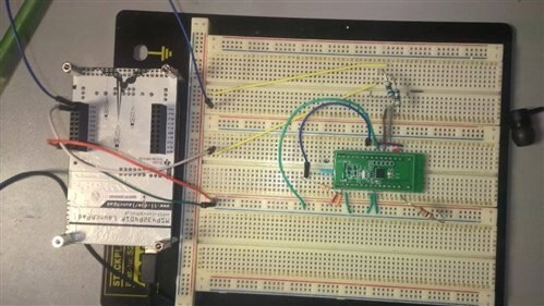

    I am using same sensor(bno055 shuttle board). I follow same connection that sensor master has posted(schemetic.jpg).slight change i use 10kohm with 'i2c addr selec' pin then to vddio. I want connect bno055 shuttle board with msp432 using energia IDE. energia is compatible of arduino libraries. but while uploading the code I am facing following errors. I dont know why it comes
    CCROOT C:\Users\Reazwan\Downloads\energia-0101E0017-windows\energia-0101E0017\hardware\tools\lm4f
    SDKROOT C:\Users\Reazwan\Downloads\energia-0101E0017-windows\energia-0101E0017\hardware\msp432/CC3200SDK_1.0.0.patch
    CLOSURE C:\Users\Reazwan\Downloads\energia-0101E0017-windows\energia-0101E0017\hardware\common
    MAINSKETCH sensorapi.cpp
    armcl sensorapi.cpp
    C:\Users\Reazwan\Downloads\energia-0101E0017-windows\energia-0101E0017\hardware\tools\lm4f/bin/arm-none-eabi-gcc -c -Os @"C:\Users\Reazwan\Downloads\energia-0101E0017-windows\energia-0101E0017\hardware\emt/ti/runtime/wiring/msp432/compiler.opt" -DF_CPU=48000000L -D__MSP432P401R__ -DTARGET_IS_MSP432P4XX -Dxdc__nolocalstring=1 -IC:\Users\Reazwan\Downloads\energia-0101E0017-windows\energia-0101E0017/hardware/msp432/libraries/AIR430BoostEuropeETSI/ -IC:\Users\Reazwan\Downloads\energia-0101E0017-windows\energia-0101E0017/hardware/msp432/libraries/AIR430BoostEuropeETSI/utility/ -IC:\Users\Reazwan\Downloads\energia-0101E0017-windows\energia-0101E0017/hardware/msp432/libraries/AIR430BoostUSAFCC/ -IC:\Users\Reazwan\Downloads\energia-0101E0017-windows\energia-0101E0017/hardware/msp432/libraries/AIR430BoostUSAFCC/utility/ -IC:\Users\Reazwan\Downloads\energia-0101E0017-windows\energia-0101E0017/hardware/msp432/libraries/Adafruit_BNO055/ -IC:\Users\Reazwan\Downloads\energia-0101E0017-windows\energia-0101E0017/hardware/msp432/libraries/Adafruit_Sensor/ -IC:\Users\Reazwan\Downloads\energia-0101E0017-windows\energia-0101E0017/hardware/msp432/libraries/Adafruit_TMP006/ -IC:\Users\Reazwan\Downloads\energia-0101E0017-windows\energia-0101E0017/hardware/msp432/libraries/CogLCD/ -IC:\Users\Reazwan\Downloads\energia-0101E0017-windows\energia-0101E0017/hardware/msp432/libraries/EduBPMKII_Screen/ -IC:\Users\Reazwan\Downloads\energia-0101E0017-windows\energia-0101E0017/hardware/msp432/libraries/LCD_SharpBoosterPack_SPI/ -IC:\Users\Reazwan\Downloads\energia-0101E0017-windows\energia-0101E0017/hardware/msp432/libraries/M2XStreamClient/ -IC:\Users\Reazwan\Downloads\energia-0101E0017-windows\energia-0101E0017/hardware/msp432/libraries/MQTTClient/ -IC:\Users\Reazwan\Downloads\energia-0101E0017-windows\energia-0101E0017/hardware/msp432/libraries/MSP432P401_Code_Examples/ -IC:\Users\Reazwan\Downloads\energia-0101E0017-windows\energia-0101E0017/hardware/msp432/libraries/OPT3001/ -IC:\Users\Reazwan\Downloads\energia-0101E0017-windows\energia-0101E0017/hardware/msp432/libraries/OneMsTaskTimer/ -IC:\Users\Reazwan\Downloads\energia-0101E0017-windows\energia-0101E0017/hardware/msp432/libraries/OneWire/ -IC:\Users\Reazwan\Downloads\energia-0101E0017-windows\energia-0101E0017/hardware/msp432/libraries/PubNub/ -IC:\Users\Reazwan\Downloads\energia-0101E0017-windows\energia-0101E0017/hardware/msp432/libraries/PubSubClient/ -IC:\Users\Reazwan\Downloads\energia-0101E0017-windows\energia-0101E0017/hardware/msp432/libraries/SPI/ -IC:\Users\Reazwan\Downloads\energia-0101E0017-windows\energia-0101E0017/hardware/msp432/libraries/Servo/ -IC:\Users\Reazwan\Downloads\energia-0101E0017-windows\energia-0101E0017/hardware/msp432/libraries/Temboo/ -IC:\Users\Reazwan\Downloads\energia-0101E0017-windows\energia-0101E0017/hardware/msp432/libraries/Temboo/utility/ -IC:\Users\Reazwan\Downloads\energia-0101E0017-windows\energia-0101E0017/hardware/msp432/libraries/WiFi/ -IC:\Users\Reazwan\Downloads\energia-0101E0017-windows\energia-0101E0017/hardware/msp432/libraries/WiFi/utility/ -IC:\Users\Reazwan\Downloads\energia-0101E0017-windows\energia-0101E0017/hardware/msp432/libraries/Wire/ -IC:\Users\Reazwan\Downloads\energia-0101E0017-windows\energia-0101E0017/hardware/msp432/libraries/aJson/ -IC:\Users\Reazwan\Downloads\energia-0101E0017-windows\energia-0101E0017/hardware/msp432/libraries/aJson/utility/ -IC:\Users\Reazwan\Downloads\energia-0101E0017-windows\energia-0101E0017/hardware/msp432/variants/MSP_EXP432P401R/ -IC:\Users\Reazwan\Downloads\energia-0101E0017-windows\energia-0101E0017/hardware/msp432/cores/msp432/ -IC:\Users\Reazwan\Downloads\energia-0101E0017-windows\energia-0101E0017/hardware/msp432/cores/msp432/inc/ -IC:\Users\Reazwan\Downloads\energia-0101E0017-windows\energia-0101E0017/hardware/msp432/cores/msp432/lib/ -IC:\Users\Reazwan\Downloads\energia-0101E0017-windows\energia-0101E0017\hardware\emt -IC:\Users\Reazwan\Downloads\energia-0101E0017-windows\energia-0101E0017\hardware\emt\ti\runtime\wiring\msp432 -IC:\Users\Reazwan\Downloads\energia-0101E0017-windows\energia-0101E0017/hardware/emt/ti/runtime/wiring/ -ffunction-sections -fdata-sections -DARDUINO=101 -DBOARD_MSP_EXP432P401R -DENERGIA=17 -D__MSP432P401R__ -mfloat-abi=hard -mfpu=fpv4-sp-d16 -fsingle-precision-constant  -fno-exceptions -fno-rtti -I "C:\Users\Reazwan\Downloads\energia-0101E0017-windows\energia-0101E0017\hardware\tools\lm4f/include" -I "C:\Users\Reazwan\Downloads\energia-0101E0017-windows\energia-0101E0017\hardware\common" -I "C:\Users\Reazwan\Downloads\energia-0101E0017-windows\energia-0101E0017\hardware\common" -IC:\Users\Reazwan\Downloads\energia-0101E0017-windows\energia-0101E0017/hardware/msp432/cores/msp432/inc/CMSIS -IC:\Users\Reazwan\Downloads\energia-0101E0017-windows\energia-0101E0017/hardware/msp432/cores/msp432/driverlib/MSP432P4xx sensorapi.cpp -o sensorapi.obj
    sensorapi.ino:6:29: fatal error: Adafruit_Sensor.h: No such file or directory
    compilation terminated.
    make: *** [sensorapi.obj] Error 1
    C:\Users\Reazwan\Downloads\energia-0101E0017-windows\energia-0101E0017\tools\common\bin\make returned 2
